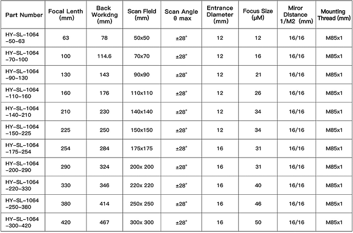

160 is most likely a Focal length=160 110mm x 110mm work area, but 175 is most likely a F=254 175mm x 175mm work area lens. Those are both pretty common sizes. The 2 different numbers, focal length and work area get confused all the time.

The chart is phenomenal thank you, it has definitely given me a better insight into the lenses. I definately misunderstood the 160 / 175 concept. the lense is a 160 lense and the work area is 110x110.

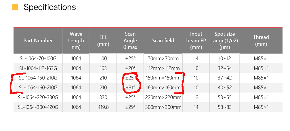

These charts are everywhere and not all have all the information you’d like to see… From Cloud Ray…
These are the same F210mm, note they have a different coverage and spot size for the same focal length…
I have a F254mm and it comes in two different scan angles for different coverage…

Chart I posted covers pretty common sizes, but seen a lot of other ones as well.
