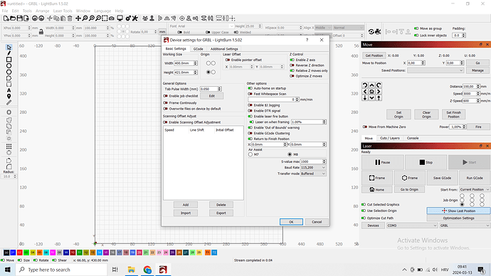

What is your machine origin.
As in, when machine homes, what coordenates you have?
(you can check on Move panel - >get position)
also what corner of the machine is it?

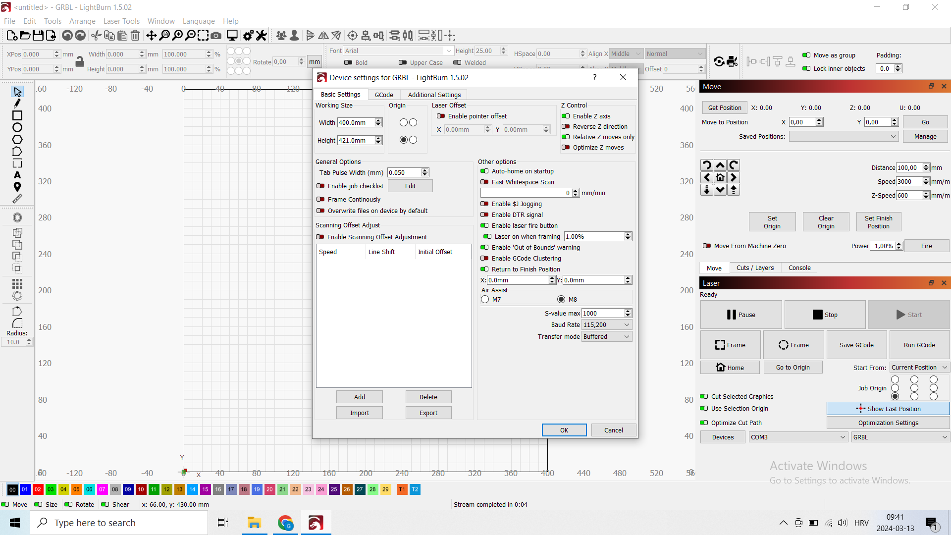

lastly edit → device settings. can you take a screen shot?
Front left corner is home position, now after homing I get 0,0,0 position so this looks ok.
