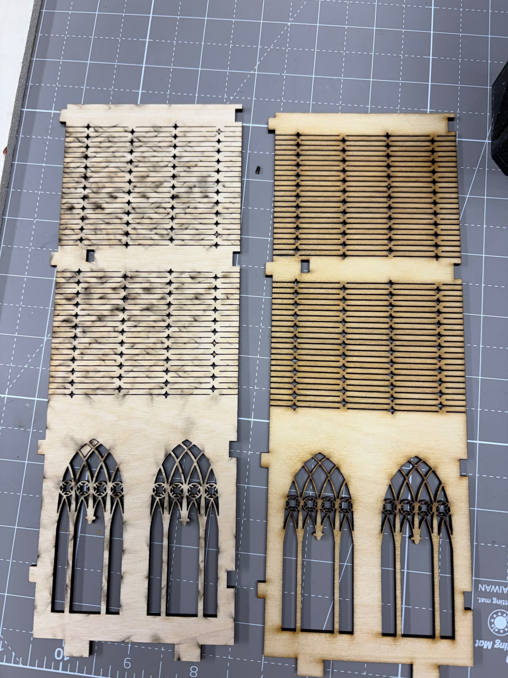

When I cut my patterns, I get burn/scorch regardless of what I do
I have and ACMER P2 33 watt Diode laser; Lightburn 2.0.04; cutting Baltic Birch 3mm. Exhaust is xTool AP2 Safety Pro w/ Cyclone
I have tried many different cut settings in Lightburn and seemed to have settled on 1500/100/3 (speed/power/passes). Less than three passes does not cut through the Baltic Birch. I started with 500/100/1 and it cut but the residual burn to the edges was too much for me. I still get some flashing/burning (not sure the correct term) on both the front of the wood sheet and the back. The result is a fair bit of sanding to resolve it.
I am relatively new to laser cutting and wonder if I am missing something. I always use air assist to the cuts - not on the highest level, but about 3/4 of the way.
This photo shows the back on the left and the front of the cut on the right and the level of burn that I am getting. Am I chasing something that doesn’t exist? Will I always have to do a fair amount of sanding?

Do you have a good air assist integrated? It doesn’t really look so. The marks on the back seem to be caused by the honeycomb; you can raise the workpiece a little above it. See some tips here:
I get little to no discoloration with air assist, I can also cut 3mm in one pass with 10watt. Maybe check your focus.
For cutting turn up your air assist. I get pretty clean cuts on 2.8mm Baltic plywood on a honeycomb with both 20w and 40w. I also installed 3 each 1-inch fans for a crossflow to help the smoke move out.

Seems a 33 watt should have no trouble cutting 3mm in one pass.
So either your not getting full power, your lens is dirty (highly possible with such a dirty cut), or your laser is not focused. There is a focus test in Lightburn under laser tools. Your sample looks like mine when I forget to use air assist.

Sounds a lot like Your material isn’t intended to be laser cut, the “sap” You mention is most likely melted or condensed residue from the adhesive that’s used to glue the plies together.
The fact that You have to use three passes even with a powerful laser IMO supports this, especially if it’s a 3-ply plywood since You are able to reasonably cleanly cut through one ply and one adhesive layer at a time, but the more or less molten soot prevents You to cut deeper cleanly.
When the soot solidifies, You’re able to cut through it, through the second ply and scorch the next adhesive layer, and so on.
While there should always be a protective surface (metal/slate/etc.) below the honeycomb, the honeycomb has to be raised.
More if there’s no airflow or exhaust underneath it, less if there is.

I raised the hex bed ever so slightly and also turned the assist up to full and then slowed the cut from 1500/100/3 to 500/100/1 and the cuts are really clean. No burn marks and what I was hoping for. The only thing I have not done yet, but plan to do is to do the ramp test to determine the true focal point.
The Baltic Birch is for laser cutting and the residual that I was getting was perhaps from over burning with 3 passes and no air space below the hex platform.
