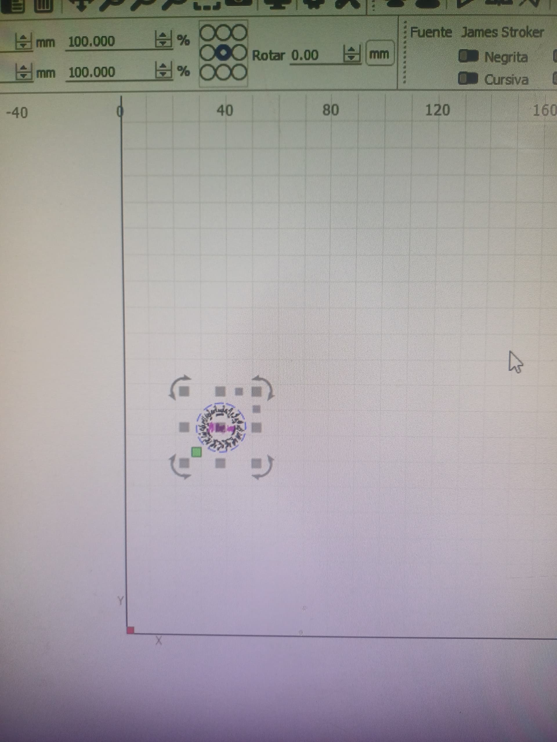

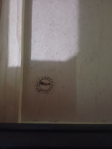

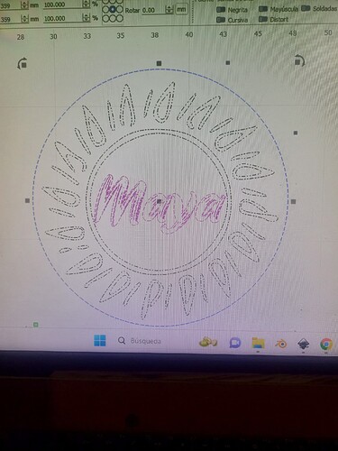

When I engrave the design it engraves, some parts are a little more up than the original design
When I engrave the design it engraves, some parts are a little more up than the original design, the rotatory function is disabled. I tried the same document on laser grbl and did not had that issue. I’ll send a few images to explain it better
It almost looks like you are too close to the bottom edge of the workspace.
Please move your project up 10 or 20 mm in LightBurn and retest.
Please use a Screenshot to share the LightBurn workspace.
Which Sculpfun laser engraver do you have?
