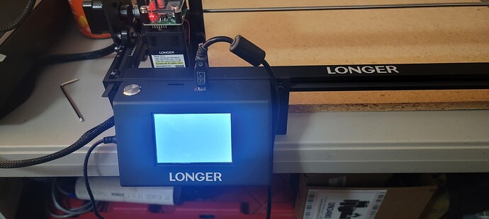

I decided to take my practice with the Longer Ray5 to the next level and load Lightburn software and connect the laser to it.after 2 tries I was able to get the Lightburn software installed correctly then I went to try and connect the longer Ray5 to the Light burn software. I turned on the Ray5 and waited for the home screen to come up. I then confirmed operation at the laser itself and everything worked fine. I then started the Lightburn software and the LCD screen on the Ray5 went blank (Light Grey).

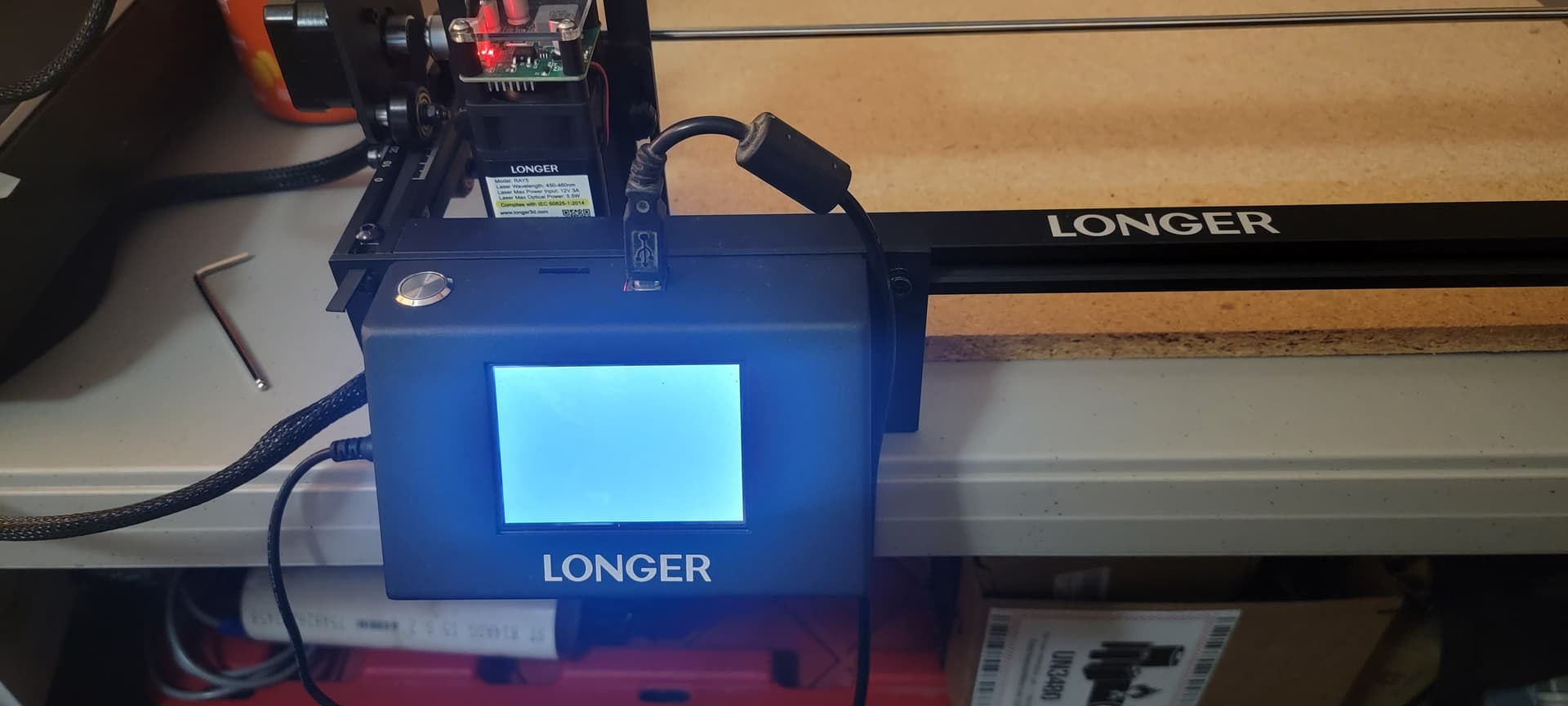

I have also included a picture of the Longer Ray5 just after the Lightburn program was told to connect. The LCD screen will stay like this until such time that I tell Light burn to disconnect, At this point the Longer Ray5 will reboot and come back on just fine.

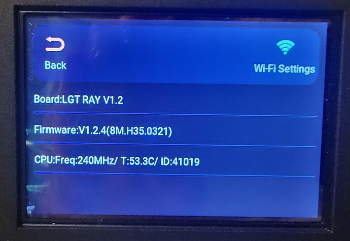

What version of Ray5 firmware are you running?

I included this photo of the Versions currently being used on the Longer Ray5

Try toggling the “Enable DTR signal” setting in Device Settings. If that doesn’t work, review the baud rate settings from LaserGRBL and make sure you’re using the same speed setting in LightBurn.
I have been sitting here trying all the baud rates. And never saw that DTR up there. Perfect all is working great. Thank you so much for the help.
