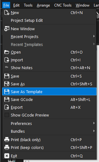

Where LightBurn is tied to the bed area of your machine, MillMage is constrained by your raw material size, so it needs to be input at the beginning. You can make a template and open that, in lieu of going through the setup wizard - just go to ‘File > Save As Template’
Then that template will be in the Templates tab in Project Setup

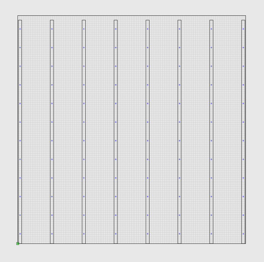

I have a template for the bed of my Altmill, for example:

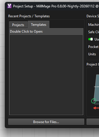

At the bottom of the wizard there is a button that says “use advanced setup” or something similar. It opens a nice single window project setup where you can load a template if you like.
in rc 12 and 13 my templates dont reload ? , i have them saved in my drobox could this be the issue? should i save them to hard drive on computer instead, have had same issue with recent files in rc 12 and 13
Yes, that can be the issue. It is HIGHLY recommended you not use any sort of cloud storage except for backup copies of your files. Always load and save to the local drive. Some people have luck using a NAS box, but I use mine strictly for backup copies.
