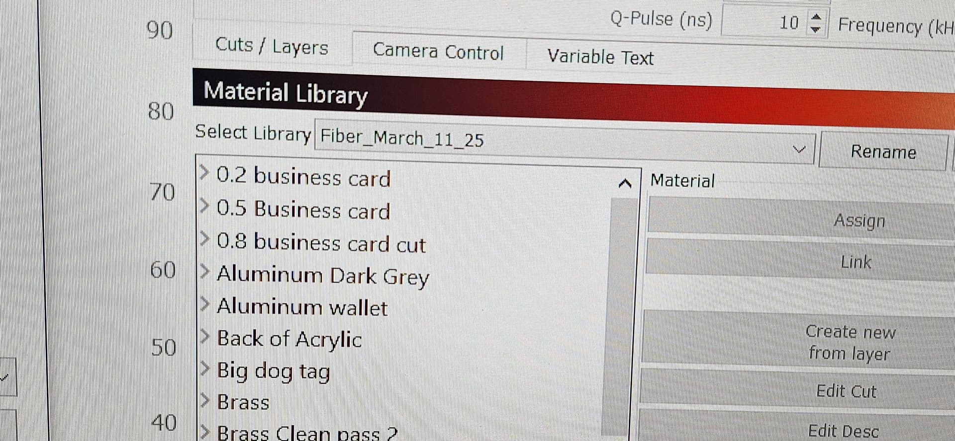

When opening a LB library LB shows different Library

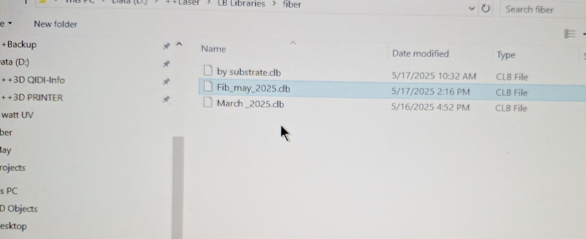

When Loading Fib_may_2025.clb from libraries
when Loaded LightBurn shows Fiber_March_11_25 which even isn’t in the Library
any thoughts

@But I dont even have a Fiber_March_11_25 clb Library

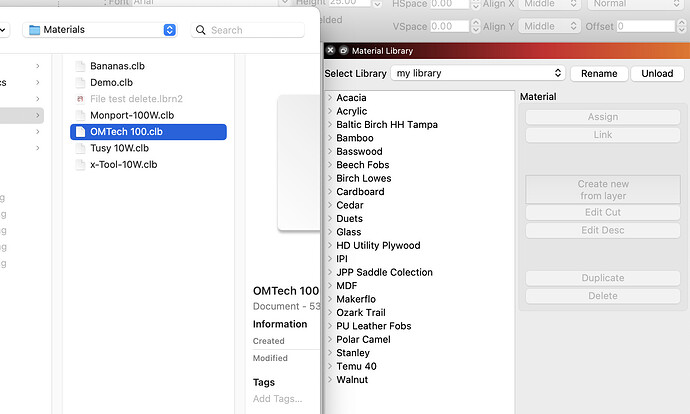

The Library name is not necessarily the same as the file name. This is haw my Omtech 100 Library displays in Lightburn.

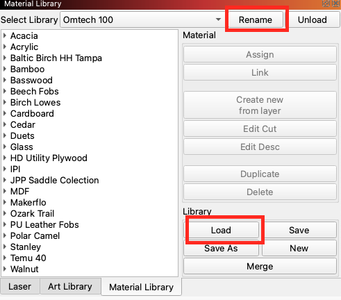

If you Load the library, rather than use the select drop down, you know which one you have. Then you can rename it in the drop down to match.
