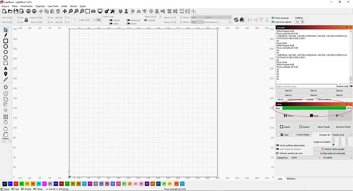

Hello, when updating to version 1.5.02 the machine stops responding after a few minutes.
And I also activated the license at the time of the update as I was testing the software and it was 5 days away from expiring. Now I can’t work.
I’m using a TTS10 pro
[V4.00(8M.H35.20231120)]
[VER:1.1h.2023112002:]
[OPT:VMPH,63,256]
Target buffer size found
[MSG:Using machine:MKS DLC32]
Hello, I removed version 1.5.02 and installed version 1.4.05 but the problem persists. And I tested it with another cutting software and the cutter worked normally, I need urgent help. Where is the support?

I also see that your machine is reporting a negative position before it disconnects. Does your laser have limit switches? If so, make sure they are wired correctly and the connections are secure.
If not, make sure “Auto-home on startup” is disabled under Edit > Device Settings, and follow the instructions here to home your machine manually"
