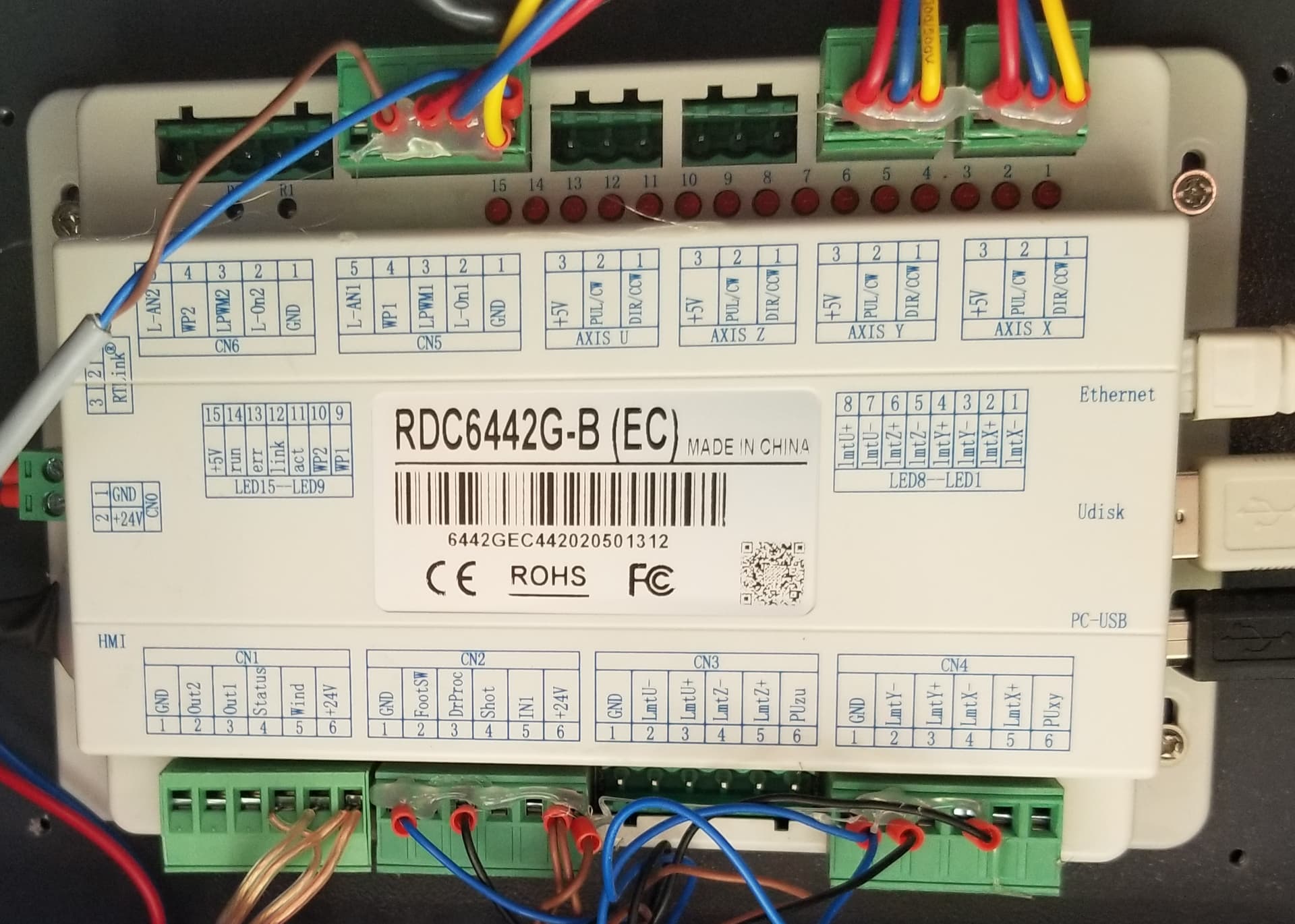

I am a laser control card R&D engineer. While using LightBurn software, I noticed an Ethernet/TCP communication option for device connection. I would like to inquire where I can download this communication protocol?

What devices do you have? If you have a dsp, it’s likely that it will work over the LAN. My Ruida uses udp/ip, so it’s not that smart.
I looked at Han’s Laser, it appears to use a proprietary control systems?
Yes, we have our own system, but we also hope to be compatible with the LightBurn software. What model is your Ruida control card? I saw before that Ruida’s cards use the serial port protocol. Our control card also supports the TCP protocol, but it uses its own protocol. I haven’t worked with LightBurn software before, so I’m not very familiar with many aspects。
Click on my user name above the text, all of this is detailed there. It’s a 6442g.

ruida RDC6442
I really don’t follow what you want as far as information wise. UDP protocol is standardized for the Ethernet UDP/IP communications.
This site used to have all the machine codes for the Ruida, but it randomly seems to be broken. Sometimes it works, sometimes it has a database error of some type. I don’t know where else you can find the control code for a Ruida, if that’s what you’re looking for.

My requirement is to find a marking card that supports lightburn and also supports network communication. Due to the complex on-site situation of this customer, the USB card often disconnects.

I have a Ruida RDC6445 Controller connected to my ethernet hub as is my computer with Lightburn. The Ruida has a dedicated IP address and that address is part of the machine configuration in Lightburn. That is the only way I use my machine, and it works great.
