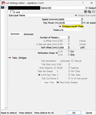

Hi.
I have issues with my laser, it is not cutting constantly . I t can cut trough half and half not.
I was wondering if i need to enable constant burn, but i am not able to find it Lightburn version 1.3.01

This is generally not the right answer in cases like this.
It should appear in the Cut settings window.
If it doesn’t appear for you it’s likely that your device is configured with the incorrect profile.
Push Devices button in Laser windows, then click on the name of your laser. If the reported controller at the bottom of that window is not “GRBL” then it’s incorrect. Edit the device and change to GRBL, then proceed through the wizard until finished.
Then check for setting.
