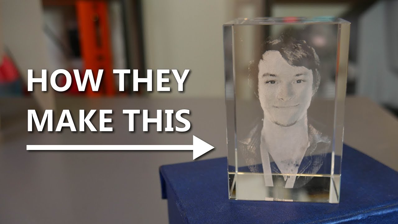

Sure. I want to etch photos or logos sub surface into crystal blocks and awards

A brief google on this topic reveals these laser diode machines are 20k and up and use common JPG files but very special software.
Not that everything you read on the internet is accurate.
I think you’re dreaming, sorry.
That kind of internal fracturing requires a laser that has an exacting focal point, the proper glass and very specialized software.
Not the best video, but gives you some idea…
Good luck
I found the same video Jack. Lasers are a bit out of makers muse lane but he is really sharp with printers and doesn’t seem to post material that he has no knowledge of. So I would believe what he says. I guess proof would be to see how expensive the finished product is and at what quality. Yes good luck also.
Ok. I thought you needed a co2 laser to do this
