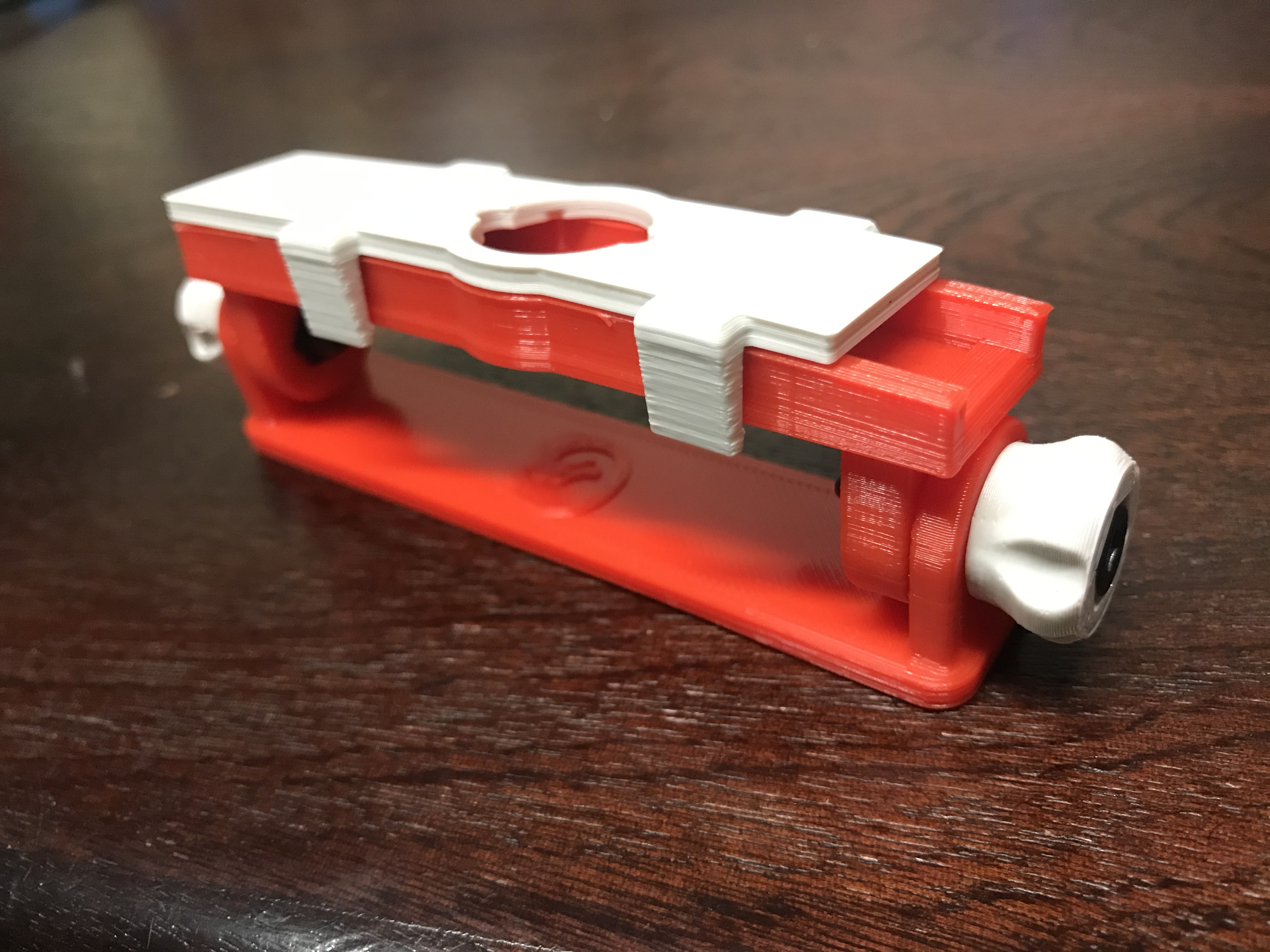

Printed the mount on my Creality Ender 3 - STLs from https://cdn.shopify.com/s/files/1/2522/3850/files/8MP-LightBurnCameraMount.zip?v=1586209819
All set to go - now for the shipping to get here !
looks good, have fun when it arrives, i spent ages playing with it to see just how small i could align and well its amazing! As I said one of the best tools in the box!
