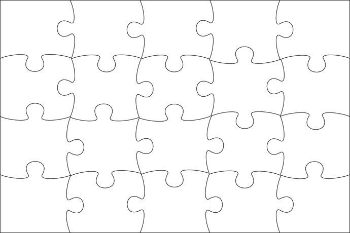

I have a jigsaw puzzle template. All lines are regarded as one image. I want to designate the outer line as one line cut, horizontal lines as another line cut, and vertical lines as another line cut.
Reason for this is so I can cut horizontal lines first, Vertical lines second and outer line as third cut.
LBN is set up so outer is first, horizontal is second and vertical is third.
I am reasonably sure there is a way of doing this.

Could you put horizontal, vertical, and outer lines as different layers?
Then make sure that you order by layer in optimization settings? You can change the layer placement to adjust as necessary.
Without seeing your current layer setup, I will guess and share that you can change the order of processing by changing the order of the layers. Optimization Settings - LightBurn Software Documentation
I would need to copy each line to make different layers. Isolating the lines is what I do not know how to accomplish, easily
Hard to provide exact steps to accomplish your task without seeing what you are working with and how it is currently.

Is this a bitmap raster or vector lines? The initial file you tried to post was an SVG, yet the updated post is a JPG.
Post your LightBurn file for review.

Not sure if you had a chance to visit the link that @RalphU sent but I thought it was interesting. It actually generated separate vertical lines, horizontal lines, and outline and allowed to be saved as SVG. However, to my eyes the puzzles pieces looked very regular with little variation. If that works for you it might be a good start even if you modify it later.

Cutting puzzles on a honeycomb laser bed is best if the horizontal lines are done first, then vertical, followed by outline of puzzle. Helps to keep the pieces from moving while cutting.
