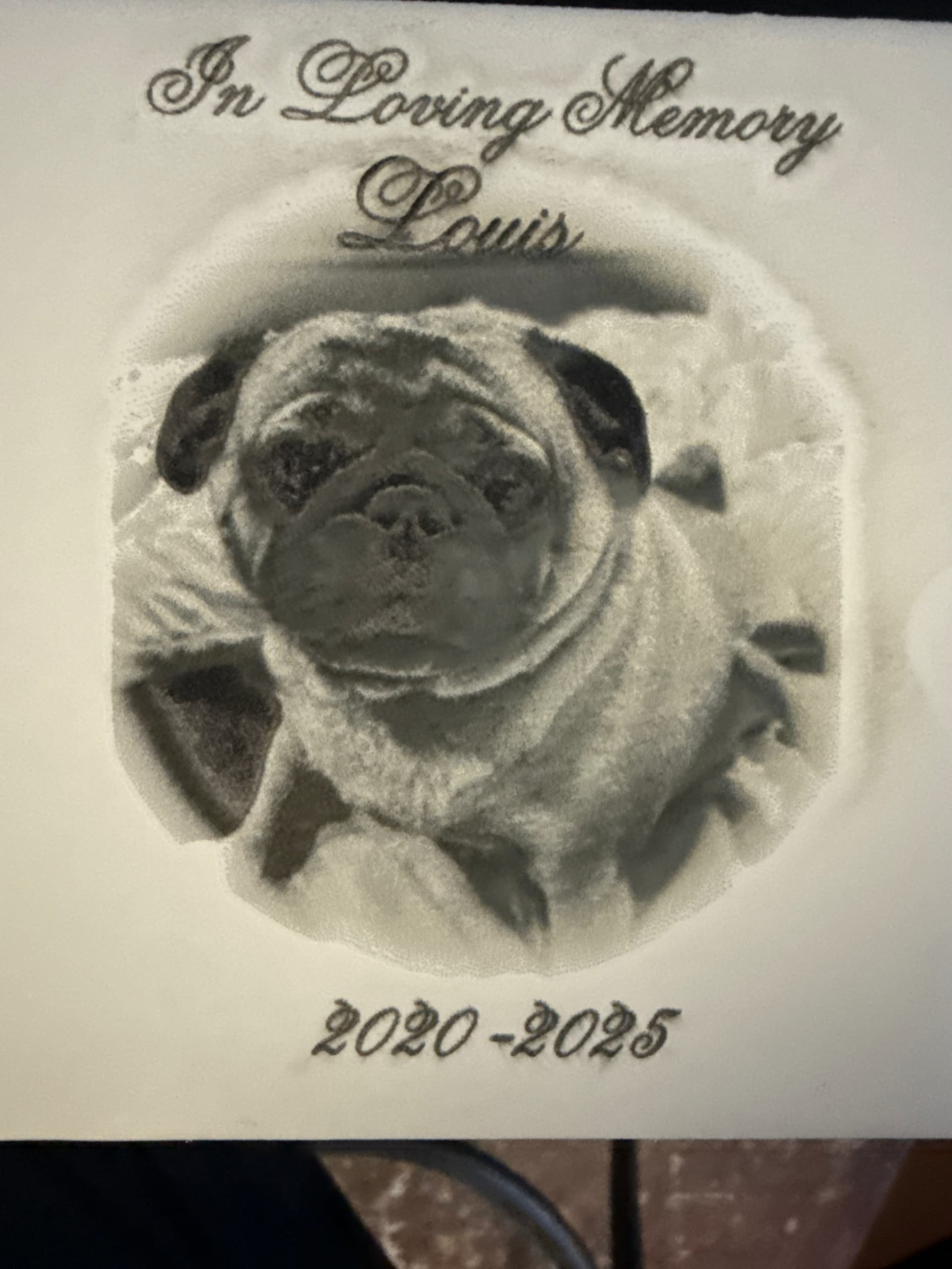

The photo is an inverted pug. I should have chosen large when I sent it to myself.
The material test above showed 50/.5/50/0.025. for the blackest black. I thought that was kind of slow and low but that’s what it showed. Using that setting, it was making the white area of the image black. I bumped it up to 100/1 and I got grey in the white area as shown in the last image.
Why is it burning the white area?

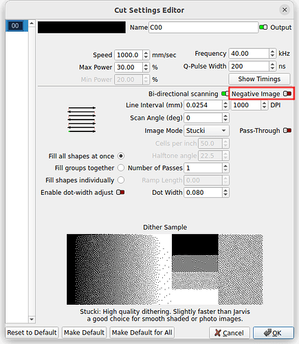

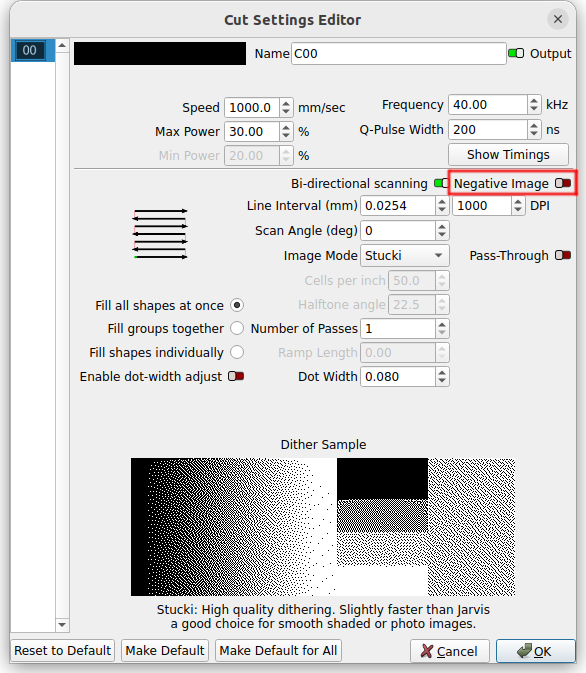

There is an negative image option on layer and an invert option on the preview.
I think I’ve finally got it dialed in.
50/100/50
How can I improve the dog’s face.
The range of your graphic is the problem. That’s the issue with most laser engraving photos. The material can produce the range of areas that are OK but the face goes outside of it’s range.
Most of this can be changed in Lightburn with image adjust.
Have you removed the original paint from this? it looks a bit burnt in areas, especially some of the text.
I removed the paint, and it looks better but still crap. I did use the adjust image but I’ll go back and try bumping up the settings.

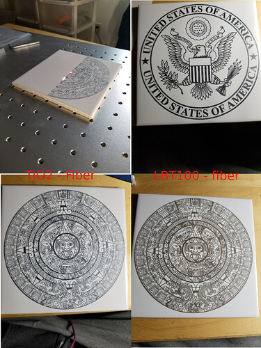

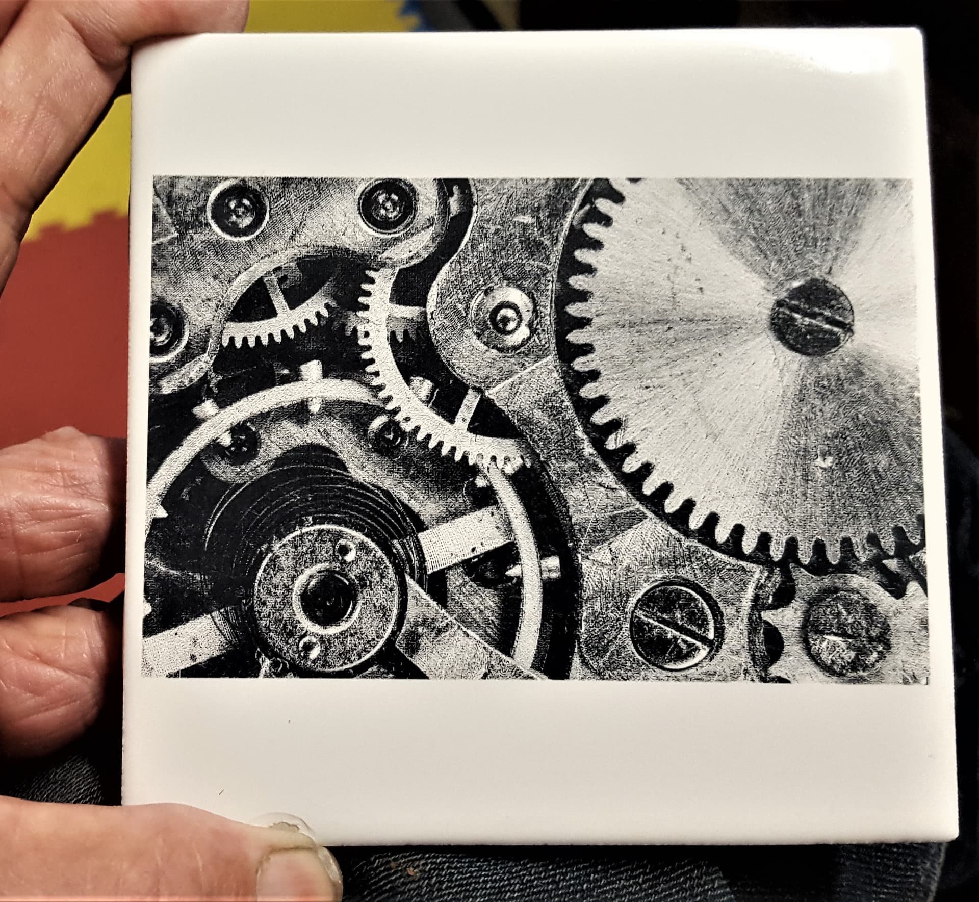

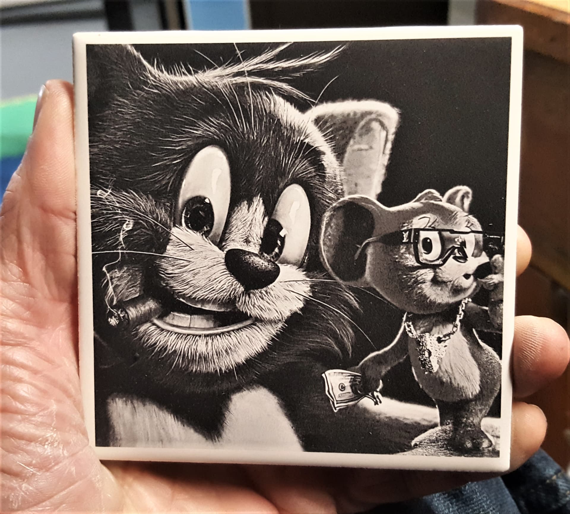

I did these on the MOPA, but I would think you could get reasonably close with a q-switch machine.
They are marked.. The LBT100 makes dark lines pretty reliably, but also at a much greater cost along with ease of use.
The TiO2 work well also, it’s just a lot more messy.
Some of these are so close, I write the coating used on the back of the tile so I don’t get them confused.
Wow! Thanks for all that.
60 watt MOPA Fiber 150 mm lens
Rustoleom Smokey Beige paint
100/30/800/200
:heart: the :black_cat: and :mouse:
