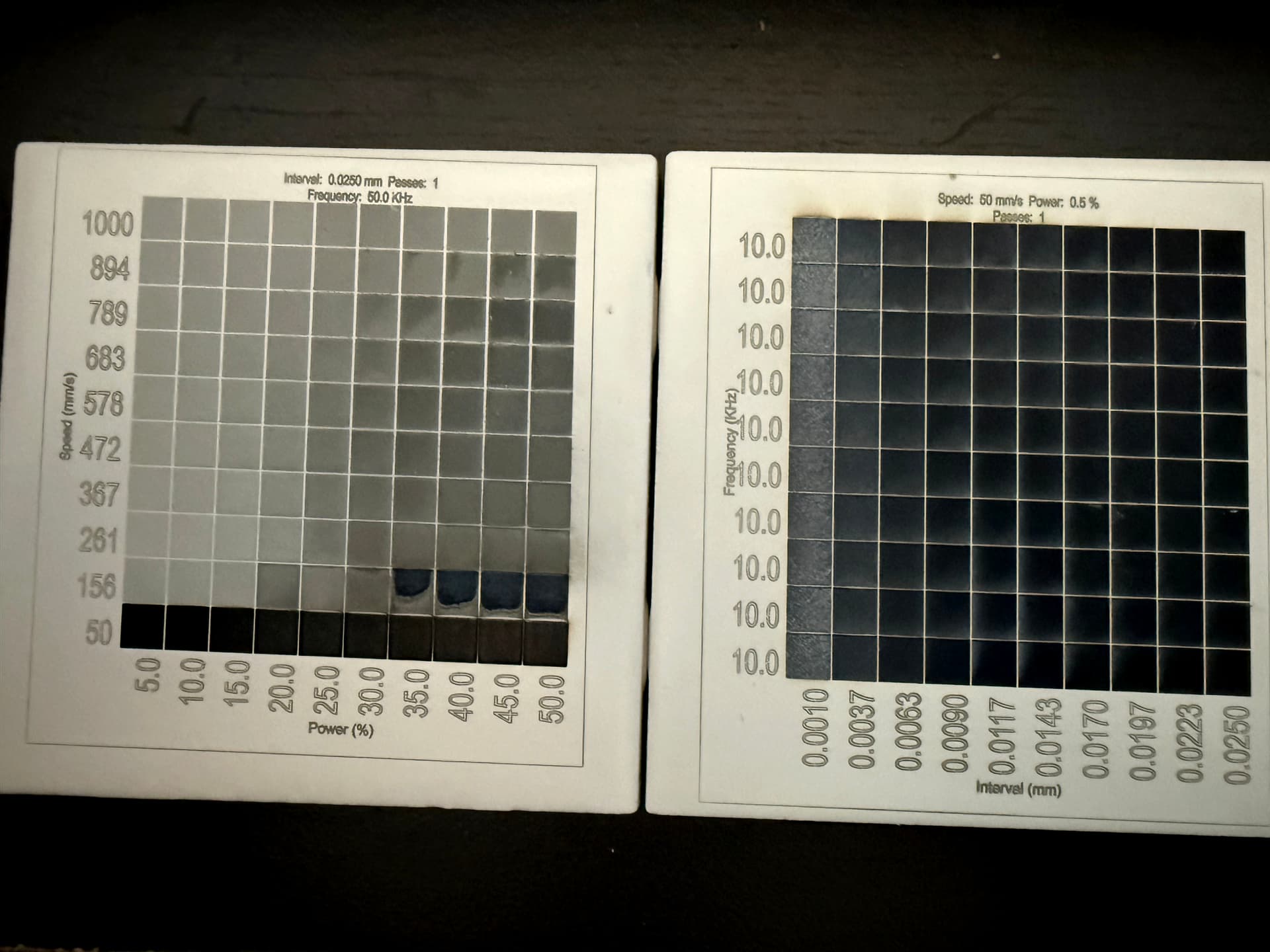

White Ceramic Tile Engraving with a 50W Fiber
I have scoured the internet for this subject and haven’t found anything that applies to my exact
situation.
I found tons of article’s for MOPA lasers, diode lasers and UV lasers, but none exactly about using a standard fiber.

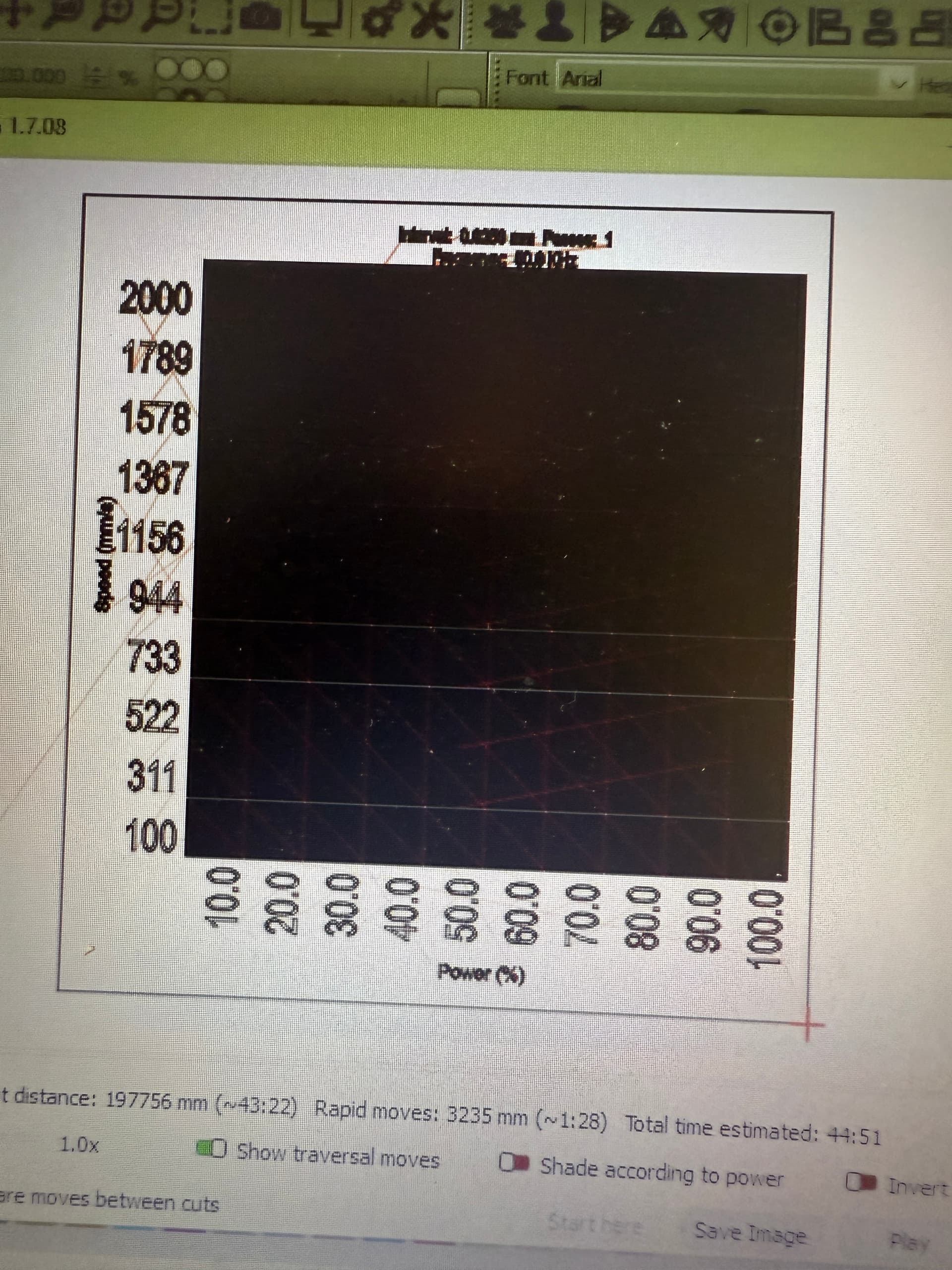

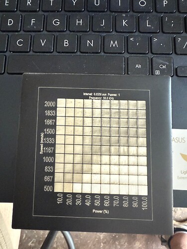

Can it be done? If so, how? Use white paint or Ti02? I tried Ti02 and it was terrible. I used flat black but not good.
I did a material test with the Ti02 and flat black but bad results, see images. Both had the same settings.
I’m trying to do a memorial thing for my daughter’s dog on a 6x6 white tile.
Hopefully one of you wizards can help.
Thank you.

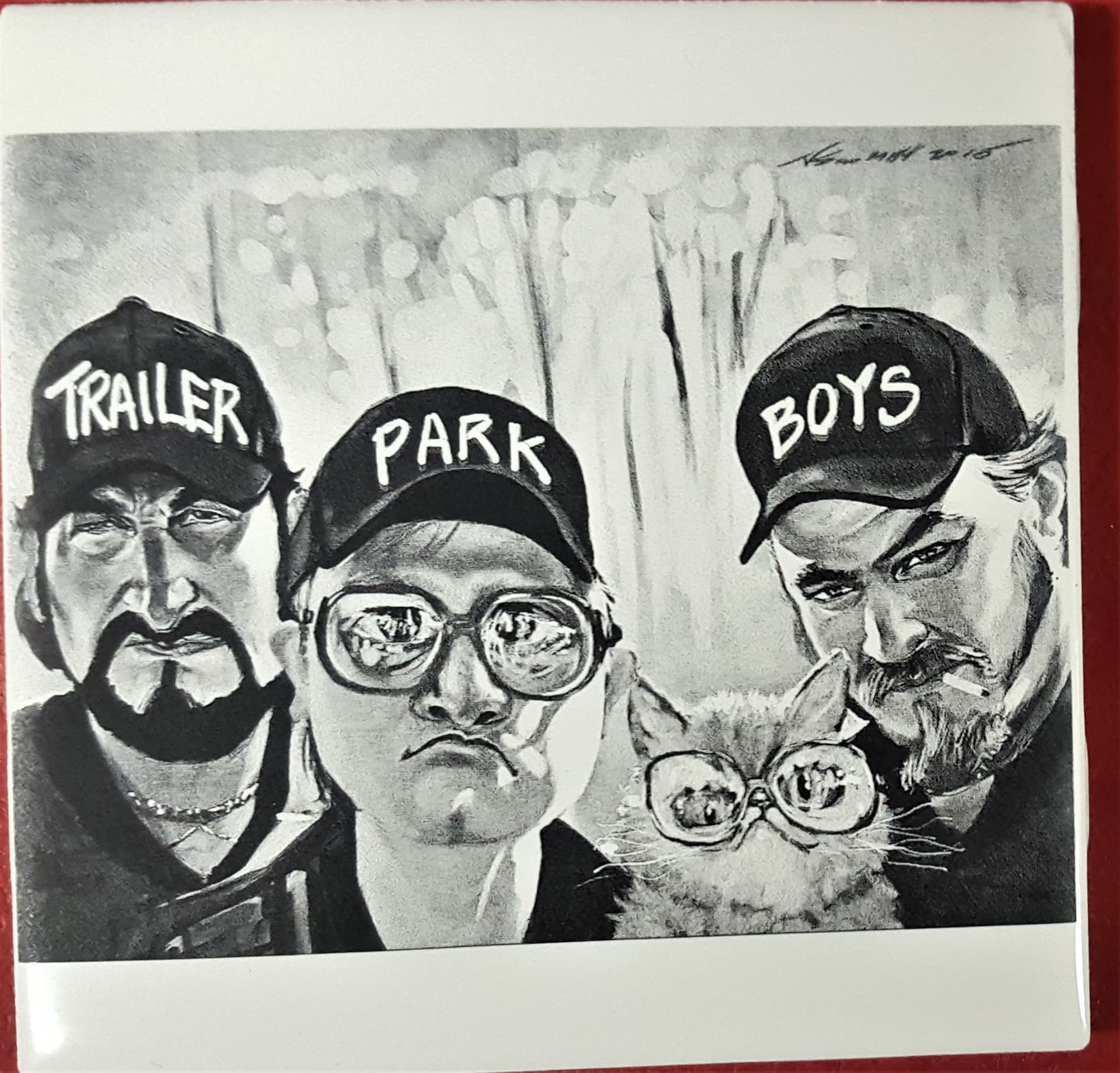

The cat image has to be labeled on the back because I can’t tell it from the LBT100 spray that I usually use. LBT100 is consistent, usually produces good blacks, easily washes off with water, is non-toxic and is more expensive than the NTM methods with a lot less elbow grease.

Looking at your tiles, I think you have an thickness issue as the results vary across the test piece. Usually when you fuse the TiO2, it shows up black. Make sure you use a paint that has the most TiO2 in it for the best results. Slow it down and advise on what frequency you used.

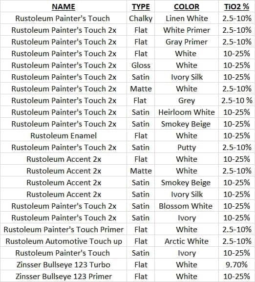

LBT 100? Someone suggested white marking water based spray paint. The kind they use on football fields.

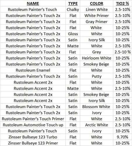

The active ingredient is TiO2, some black paints have it in the mixture. Do these field marking sprays contain TiO2? I remember Nicky noting he used a specific type of paint on his posts. I don’t like paint, hate the smell of the solvent to get it off. Worst part, is I get more of it on me and the surrounding area than on the tile. :face_with_spiral_eyes:

@jkwilborn white latex paint used to prime walls applied with air brush (thinned with water until like milk plus a drop of black to see coverage )
2 watt diode
@jkwilborn The higher TiO2 the blacker

I have sprayed some tiles with Rustoleum Blossom white. That’s all I could find, plus trying the water based field marker. I’ll let them dry for an hour and see how they work.

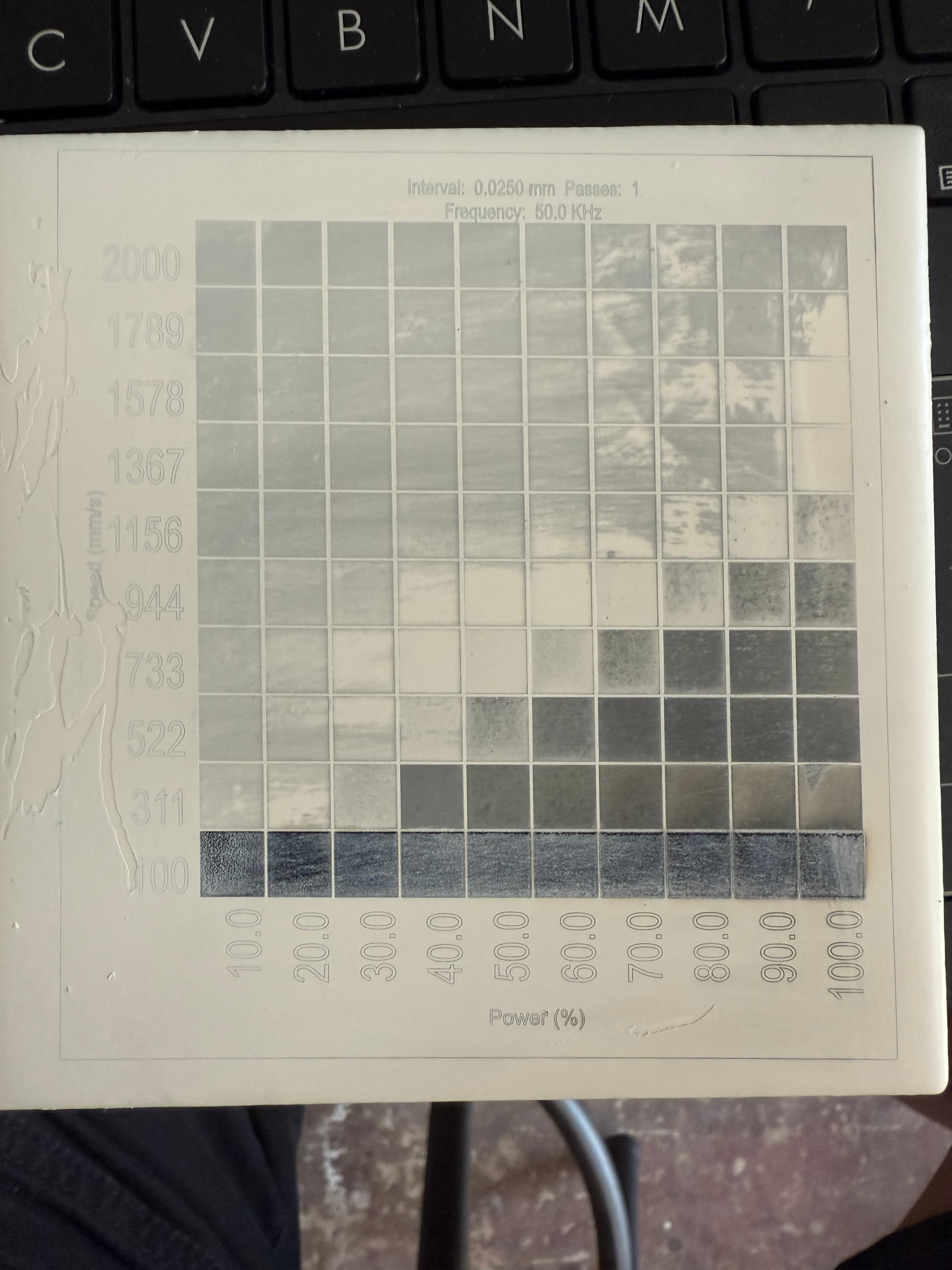

Ok, here’s some results.
First is with white field marking paint, cleaned.
Second is Rustoleum white blossom satin, cleaned.
Third is preview of second.

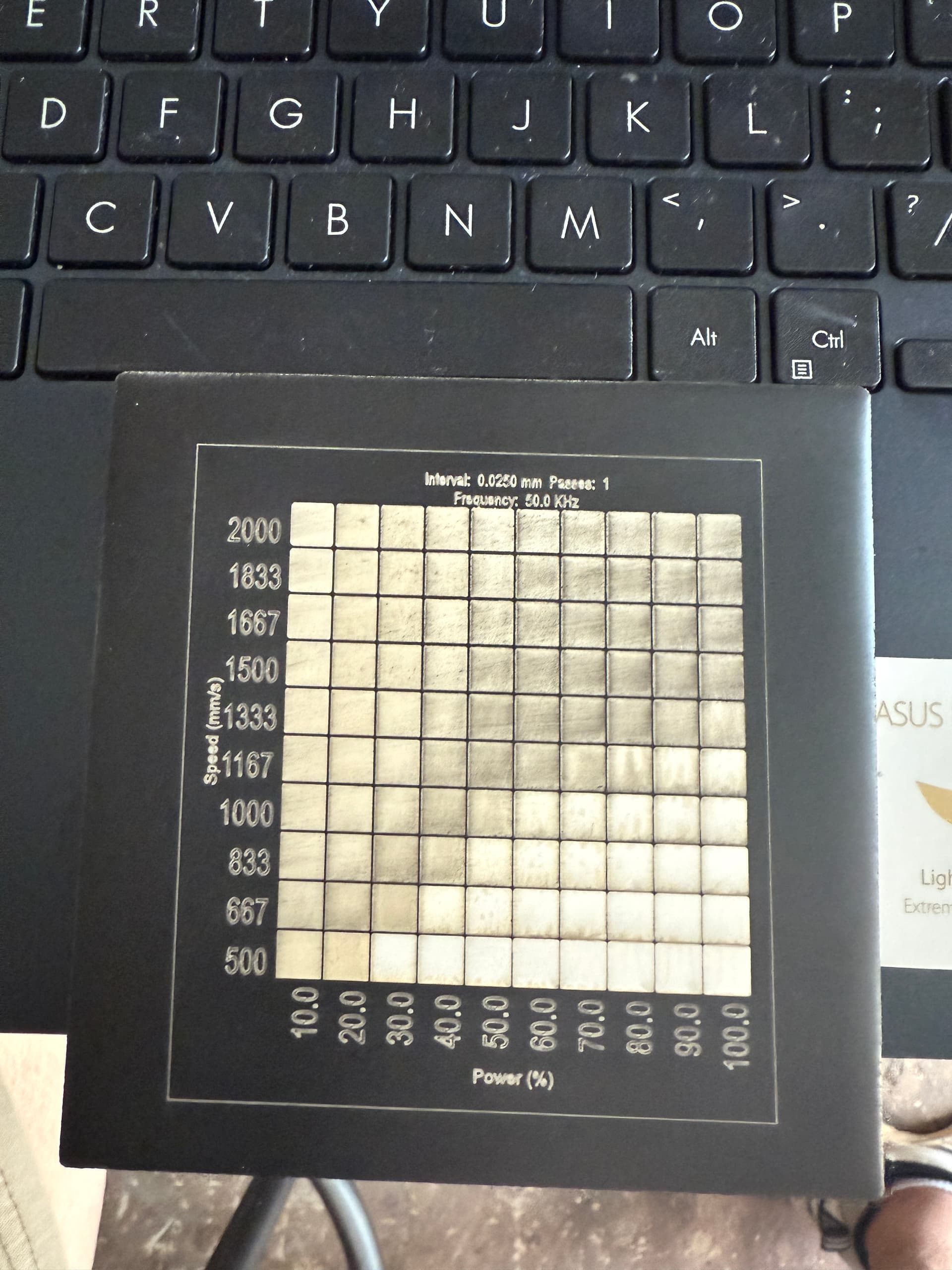

Using acetone to remove the Rustoleum is not working very well. Mineral spirits?
So, I’m guessing the Rustoleum at 100/20/50/0.025. Or will it help to do another test with the settings narrowed down?
Comments please.
Thank you.

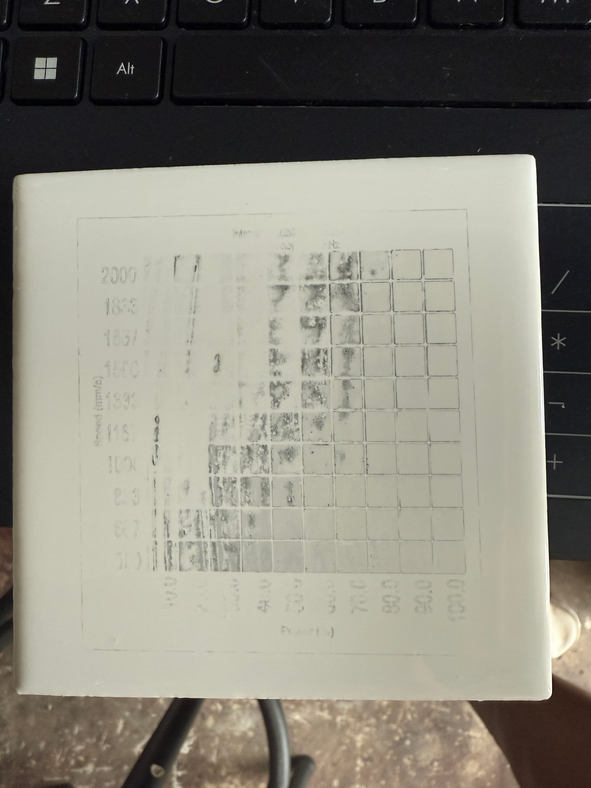

Here are the new tests (uncleaned) with the settings narrowed down.from the previous tests.
The frequency/interval test took HOURS to finish. I obviously entered the freq wrong. It was supposed to be 10-100.

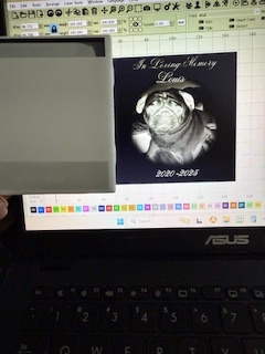

I’m going to run an image test tile at 50/.5/50/0.0250. Seems kind of slow but we’ll see.
Can someone tell me why when I try an inverted image with a white background, it’s burning the white area grey and the text white (bottom area of pic). Shouldn’t the laser not touch the white area? What am I doing wrong?
Settings 100/1/50/.0250, 1 pass. White tile painted satin white.
