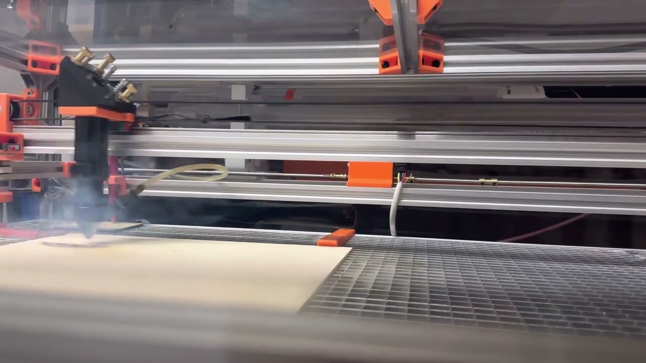

Hello,
I have a custom built laser, when I turn the air assist on, I get this white residue on the engraved areas. It looks like the smoke sticking to engraved parts. It comes off by touching it with your fingers or blasting it fairly hard with compressed air.
In this image, you can see right next to the T in Think, there is some of this white dusty stuff. the areas around it have been dabbed with my finger and you can see its come off.
What is the best way to avoid this? Some engravings are completely covered and it ruins the piece…

I designed a duct that brings the exhaust right up to the back of the bed. It appears to be extracting fairly well, but the smoke embedded on the burn is worse than ever before:
It seems you’re generating quite a bit of smoke. I didn’t realize how deeply you were engraving from the first photo.
What’s your air assist situation? Is it at a minimum? There’s a lot of turbulence in the smoke so want to make sure I understand where that’s coming from?
How is air entering the chamber? Ideally you’d have a way for air to enter the chamber from the front in this case. While it looks like smoke seems to be get pulled out once it reaches the back the smoke is lingering for some time above the surface.

My air assist comes from an air compressor with a control valve. It is incredibly low. I can barely feel any air coming out. If I increase it, the situation worsens as the smoke is blasted straight into the burned area.
Temporarily, I have a rubber foot propping the front of the lid open so air can come in from the front and pull across the wood to the back.

I seemed to have resolved this issue by turning down the air assist as low as possible.
