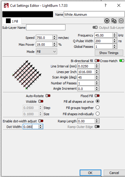

Aluminum or steel? This is for 175x175, 60W M7
My white on steel is same settings but drop the power down even more, like 10% or 11%

I will have a try on your settings later and see if any of that helps. My machine does not have Qpulse settings if that is going to make any difference?
JPT sources are 200QPulse I believe for the LP / LP+ fixed pulse MOPA machines. The Raycus are between 90 and 130 depending on the machine (Going from memory). I use 200 as a default, works for most things. It could make a difference though. The White setting works with raw and anodized, haven’t experimented with powdercoating. Wish I could be more help. Good luck and post back results!
