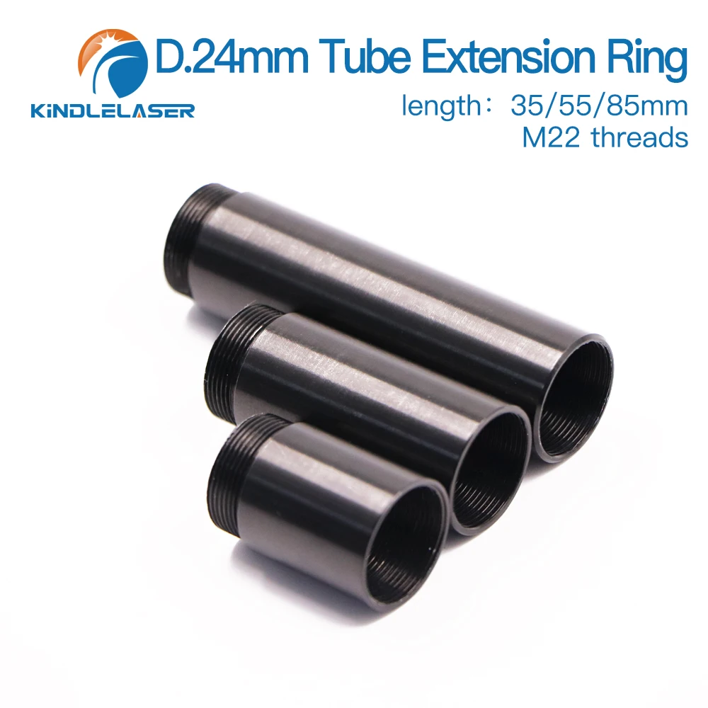

I was able to finally obtain some 24mm diameter extension tubes from here, they custom made them for me.
Everyone else sells 25mm dia, and, they don’t even have female threads inside to couple them like these do. Full set of 3 for $23 is a deal.
Works great to solve my pass thru issue with baseball bats.
Cloudray C series is 24mm tubes
E series is 25mm tubes
I’m wondering if there’s not a better clamping system than that set screw used in the LWH. These clamps actually fit 25mm tubes, REALLY well actually, but do seem a bit heavy but not by that much. You could have fun milling off unnecessary weight. But the actual C/E series tubes are themselves heavier than a tube needs to be.
I found another clamp for 24mm but it has more excess weight.
The LWH clamping screw works perfect for me, haven’t had any issues.
These 24mm extensions tubes allow me use the CloudRay C Series multi-lens tube, yet extended it further down below the front bar on my machine for pass thru.
I like the 24mm because the diameter stays perfectly centered on the LWH M3, and the linkage between my Lens Tube and the extension is smooth outside, allowing me more ability to slide it up and down in the clamp for best focal length.
