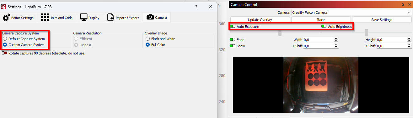

I recently updated my Lightburn camera to an nb8mp and now do not have access to exposure or brightness control. Can anyone throw some light on his. I reinstalled the software but that did not help. I am using win11.
Are you talking about these?
You might need to switch the capture system then. On 1.7, I need to select custom capture system, on 2.0, I have to use the “recommended” system.
Stand up and take a bow. Thank you for that. Working great.
