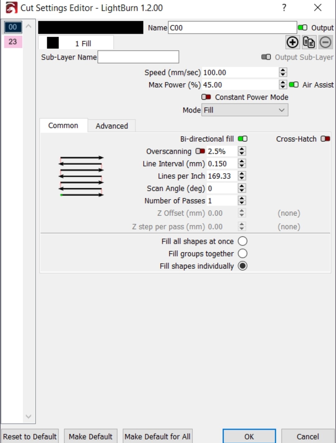

I have a file I’m attempting to engrave the bottom of a pie plate and the image keeps going all weird on me… I’m have had a perfect cut ONCE but it was on a test dish with other things etched on it. So I prepped the dish I just ran exactly like the test dish, used the same settings, computer, laser, and set up. I cleaned my laser head and got a completely different result. The craziest part to me is I’m only doing one pass so I have NO idea what is happening. I have tape on the inside of the pie plate to make SURE there is no refraction through the glass. Any advice on how to make this stop would be greatly appreciated.

Pass count: 1
Interval (mm): .035
Speed: 600
Power max (%): 90
There are only 3 options. 1. you have pressed start twice, 2. the machine is set for 2 laps, 3. there are doubles of your shapes.
I guess no. 3
I’m no expert in this, but encountered a similar thing.
Try disabling the Bi-Directional fill option in the cut/fill settings.
If that doesn’t work perhaps try adjusting the scan angle.
Hope this helps
Edit menu → delete duplicates
might be part of the issue

Just had it happen to me, in the layers menu there is an open for number of passes … one of mine got switched to four without me realizing it …
