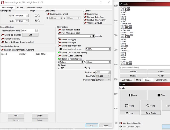

b) take a screenshot of your EDIT → Device settings?

My laser is a 10w diode laser and it is on GRBL.
Here is my device settings…
