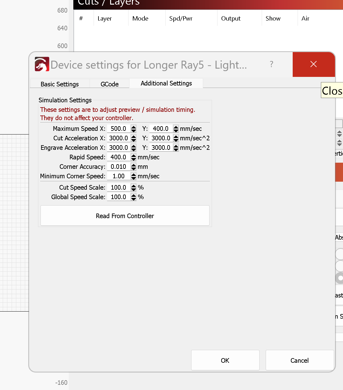

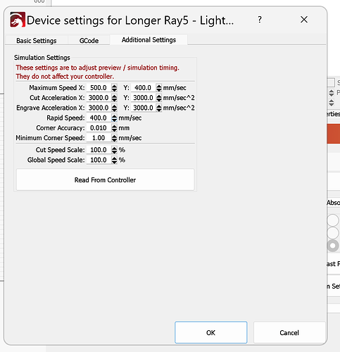

Looking to run a material test on 3mm Birch plywood for a Roly Lasermatic 20 watt. On preview it shows it will take 4 hours and 48 minutes. on my Longer Ray 5 10watt it shows over 2 hours. I’ve never changed anything in material test that I know of, just going by default settings.
Material test.gc (2.3 MB)
included the gcode

Probably your 2 machines have different profiles, see if you can fix the profile that doesn’t fit.
both are different but not sure what to change. Will all Roly Automation MK2 20W have the same settings and can I ask someone for a copy of there settings?

You probably need to read it from your controller…

Can you make a screen shot of the material test gui that is causing this?
