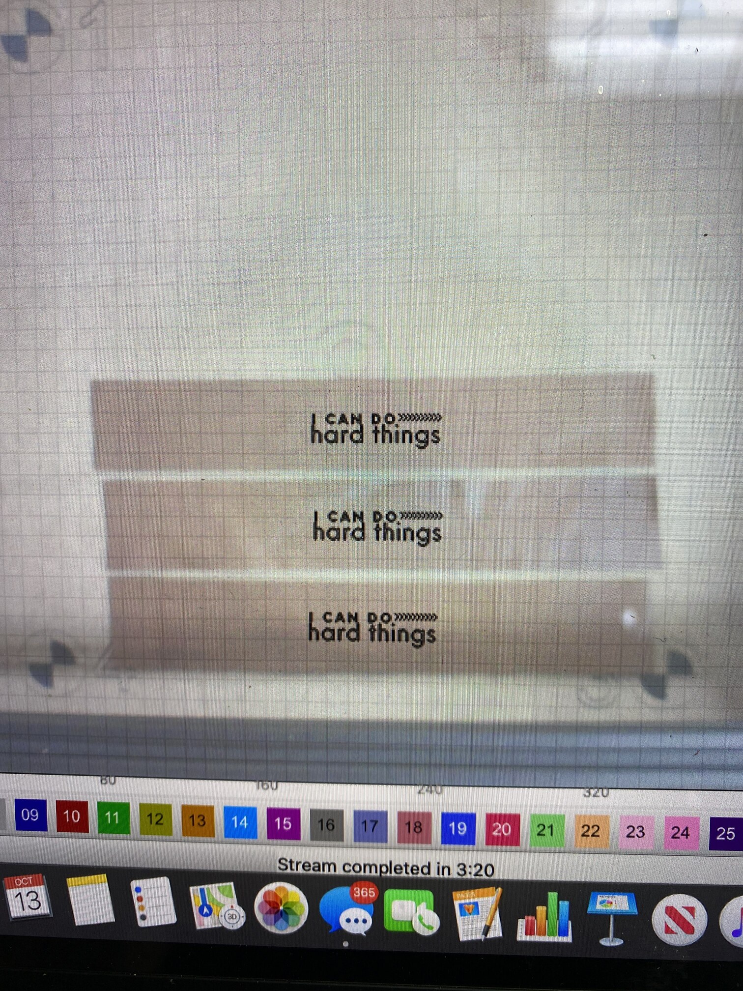

@LightBurn, Do you have any idea why my images aren’t engraving where they show in preview? This is the second burn that I did where this happened. It seems the closer I go to the center of my bed, the graphics seem to end up lower on the piece I’m trying to engrave.

What kind of camera do you have?
I have the lightburn camera, 160 degree. I just got it this weekend, and after a nightmare experience with a different camera I bought, I’m just glad this one works! But it would be far better if everything lined up perfectly :sweat_smile:I’m hoping it’s an easy fix.
Are the items you’re engraving on closer to the camera than the target marks were when you first did the alignment? The camera system in LightBurn assumes a couple things:

The second point there means that if you have a laser without a movable bed height, and you focus the lens differently for materials of different thickness, you’ll have a harder time using the camera. Not impossible, just not as easy. If you are using a backstop of 3/4" wood that you weren’t using before, you’ve changed the distance from the material to the camera, and you’d need to do the alignment for that distance.
You can actually do multiple alignments and save them by right-clicking in the camera control window and clicking ‘Export’. If you calibrate for 1/8", 1/4", 1/2" etc and save them with names like that, just load the appropriate one when you use a different material thickness and that will work. It’s not ideal, but there’s no simple way around it for now.
Thank yiu so much for responding @LightBurn. My camera is at a fixed height and angle, I have the Roddy Roman camera mount on an Ortur Laser master 2. ALso, the materials I’m engraving are almost flat, so consistent with the target marks I engraved for the alignment. Is there anything else I could be missing?
Is the camera at all loose in the mount? If there’s any play at all it can mess things up.

My camera isn’t loose, and it’s fixed. So for the time being, I’ll just make sure to engrave towards the bottom of my laser bed, which is where I have good results.

OK, today I ran into the issue of needing multiple alignments for different thicknesses.

The board itself just needs to be large, not thick - If you have a few 1/2" pieces of scrap and lay a piece of cardboard over them, that would be enough to do the calibration.
In the Camera Control window, right-click, choose ‘Export’ and save the the settings you’re currently using as something like “CameraSettings - 0 inch”. Then place your scraps on the bed, and the cardboard on scraps, and do the new alignment run. When finished, right-click again and export that as “CameraSettings - 0.5 inch”.

When you want to use the camera settings for different stuff, right-click the camera window and import the appropriate camera alignment file for the material thickness you’re using.
