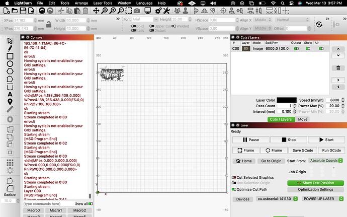

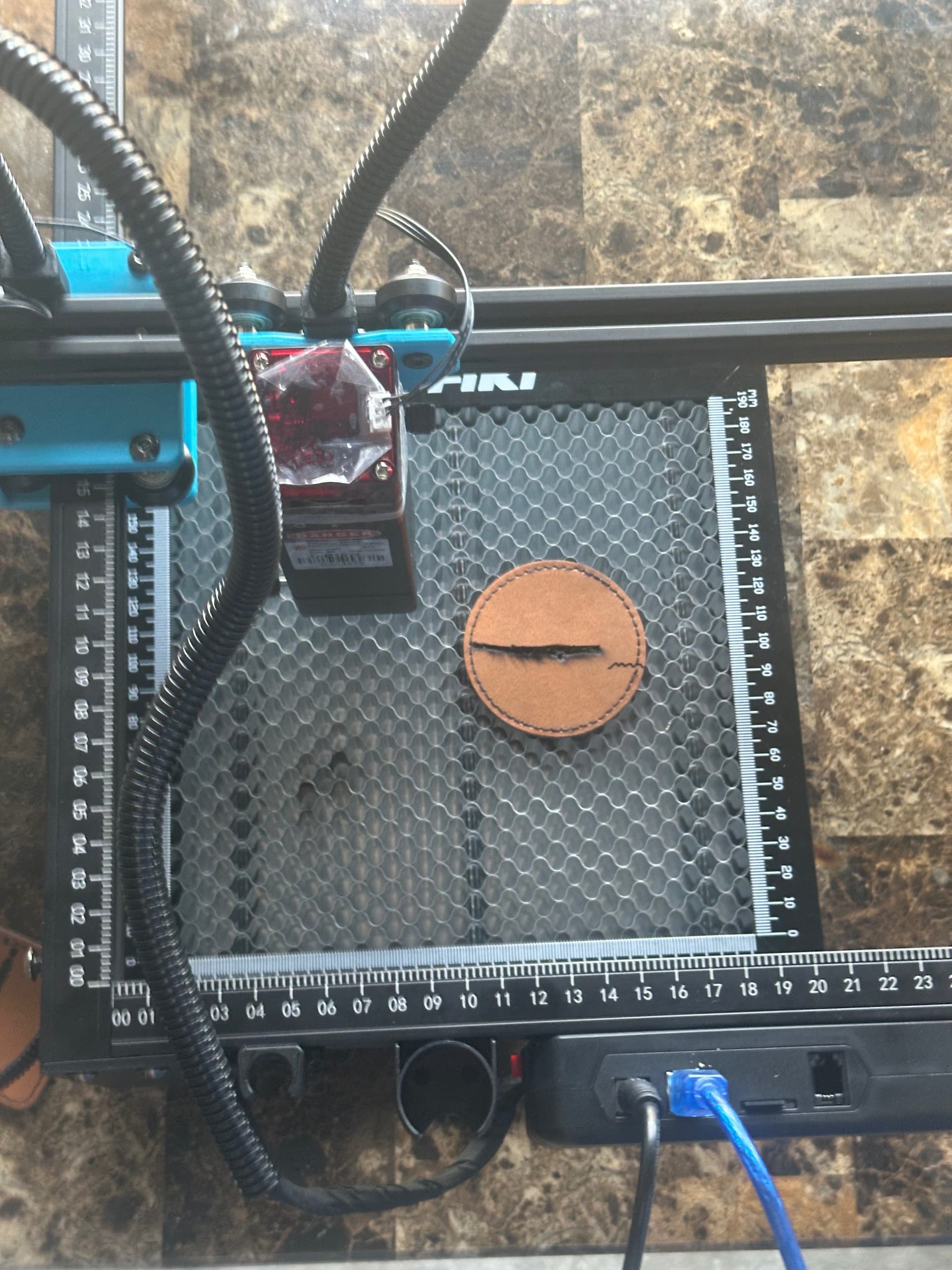

WHY IS MY LASER MAKING A STRAIGHT CUT,
WHEN IM TRYING TO EMBOSS IMAGE
I HAVE A TTS 10 PRO, MACBOOK PRO WITH MAC OS VENTURA 13.1, GRBL

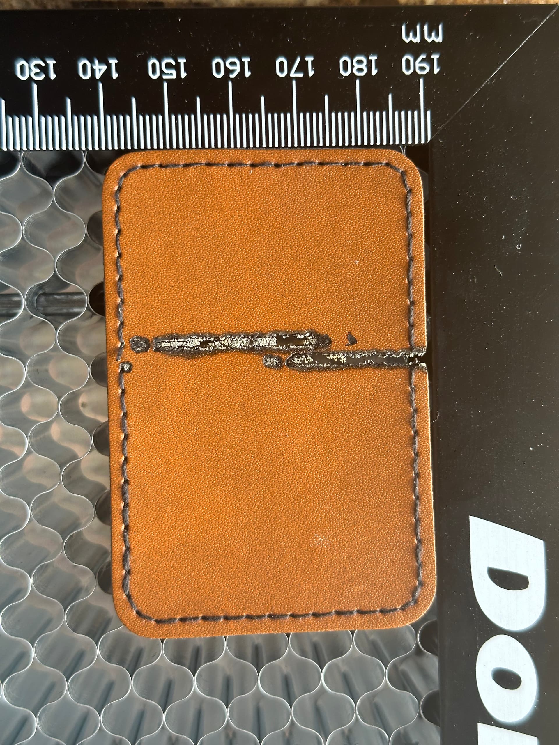

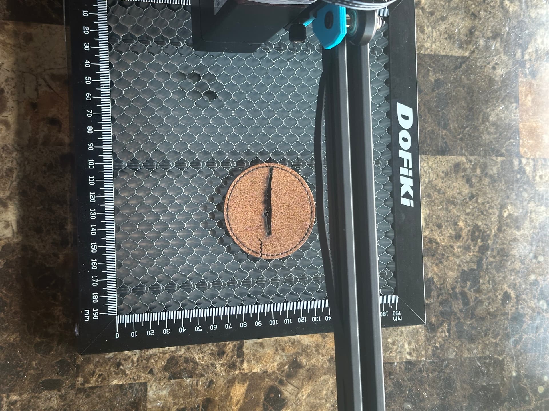

I would imagine your Y axis is not moving correctly
How are belts
Does it home correctly?

But no I don’t think it home correctly, when I try to press home it says error5 homing cycle is not enabled in your grbl settings.
can you jog your machine up and down?
If i had to guess i would say your Y belts are SO loose the motor is just slipping
