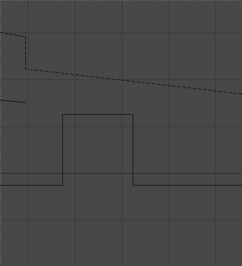

Why is the node editing tool so finicky?
I tried the “horizontal line test” but the vertical seemed to
be connected.
So, I put a rectangle over the vertical line. Changed it to
a path, and proceeded tho eliminate the vertical line, and
rectangle using the node tool’s trim and delete functions.
I do not understand the individual node shapes or colors
very well.

Check my understanding. In this picture I have placed a blue rectangle over the part that I think you want to have removed.
The nodes cannot be a three way intesection. To delete the part under the blue rectangle we need to INSERT some nodes before we trim the line…

Bill M,
Here I have moved the end of the TE bed away from the vertical line to make visual clarity.
I inserted a new node where the two lines are to meet.
I Broke the line at the middle node (created an end and a start node) - moved the top node out of the way to see it better.
I shortened the lower piece… now with the node selected and bright red, I will press D to delete that node.
After deleting the lower part, I moved the upper line and the TE notch back together. I selected both and clicked on the node editor button again.
Edit - when I selected the top line and the TE notch line and then pressed the Node Edit button, they auto joined into one object.
That makes sense

Ok, I see you added some pictures of a different spot on the foil. I will just do a picture walk through using the same steps. If there is any thing you want more explanation on, just say so:
Insert nodes on the vertical line where it meets the V notch. Drag those to the side to see them better. Select the nodes (they turn bright red) and press B to break the vertical line. Now you can select and delete the middle section. Move the vertical segments back to meet up with the V notch ends.
I understand. You changed the line into individual segments.
Deleted the problem area, and reassembled. Right?
