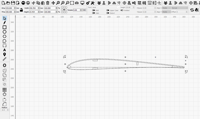

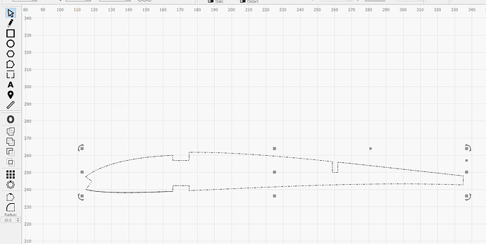

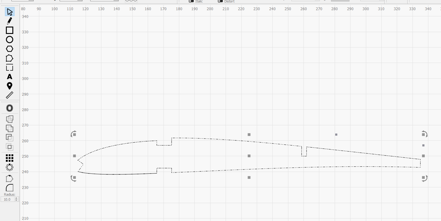

This airfoil has the Leading (LE) and trailing (TE) edges. The spars, and the 1/16” sheeting on the upper 30% of the airfoil. But 1/16” sheeting extends past the upper ~30%, and needs to overlap the spar at 30% and terminate.

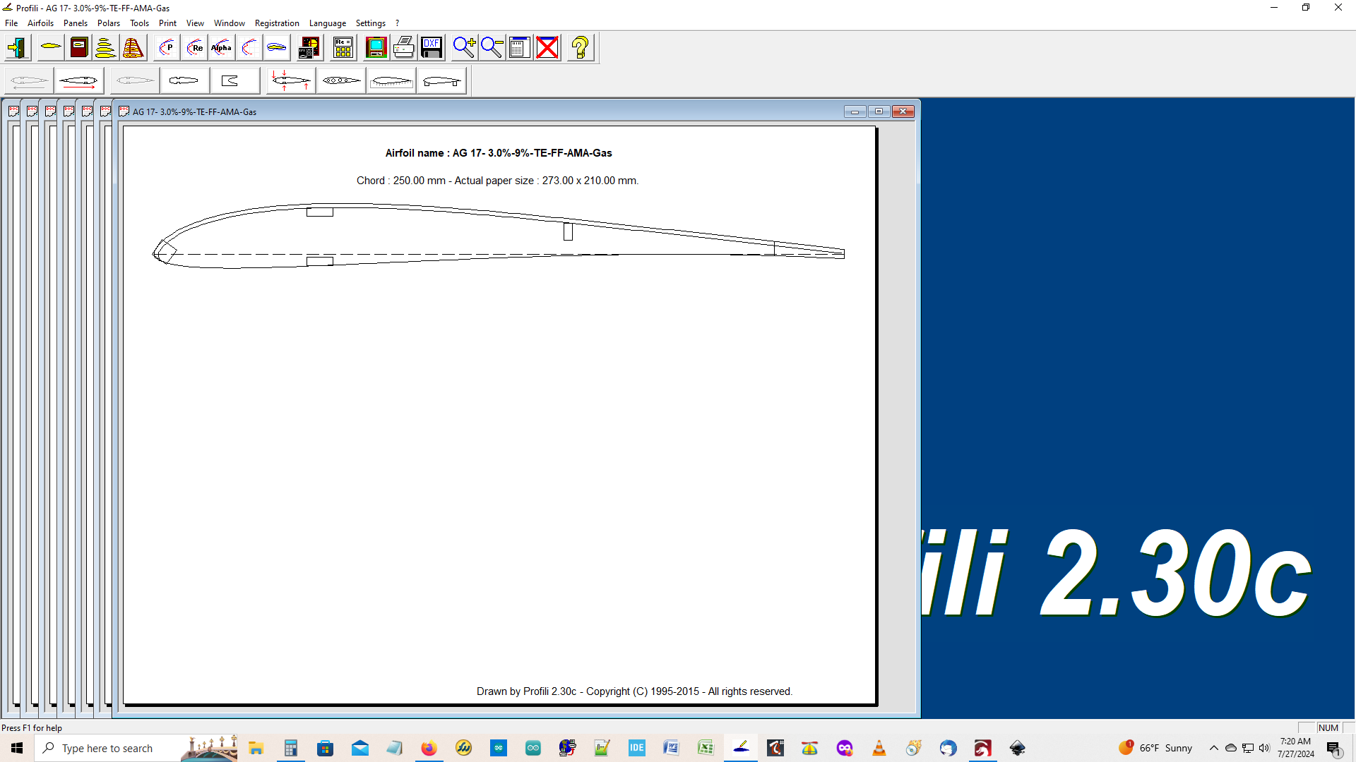

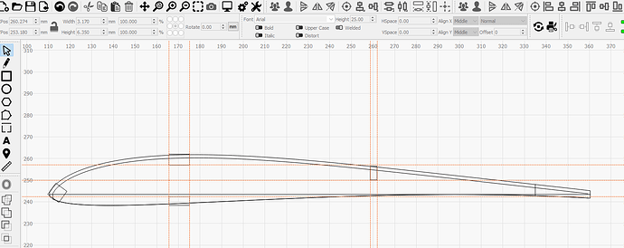

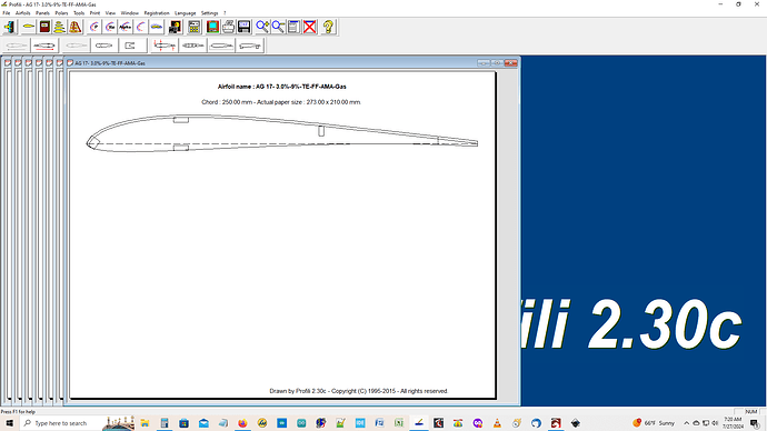

Profili saves the file as a .dxf file. Sometimes I need to add a few shapes to change the LE, or create a foot on the TE to make building the wing easier. These shapes are converted to paths before I edit the airfoil.
  1. The view of the airfoil in Profili before it was saved as a dxf file.

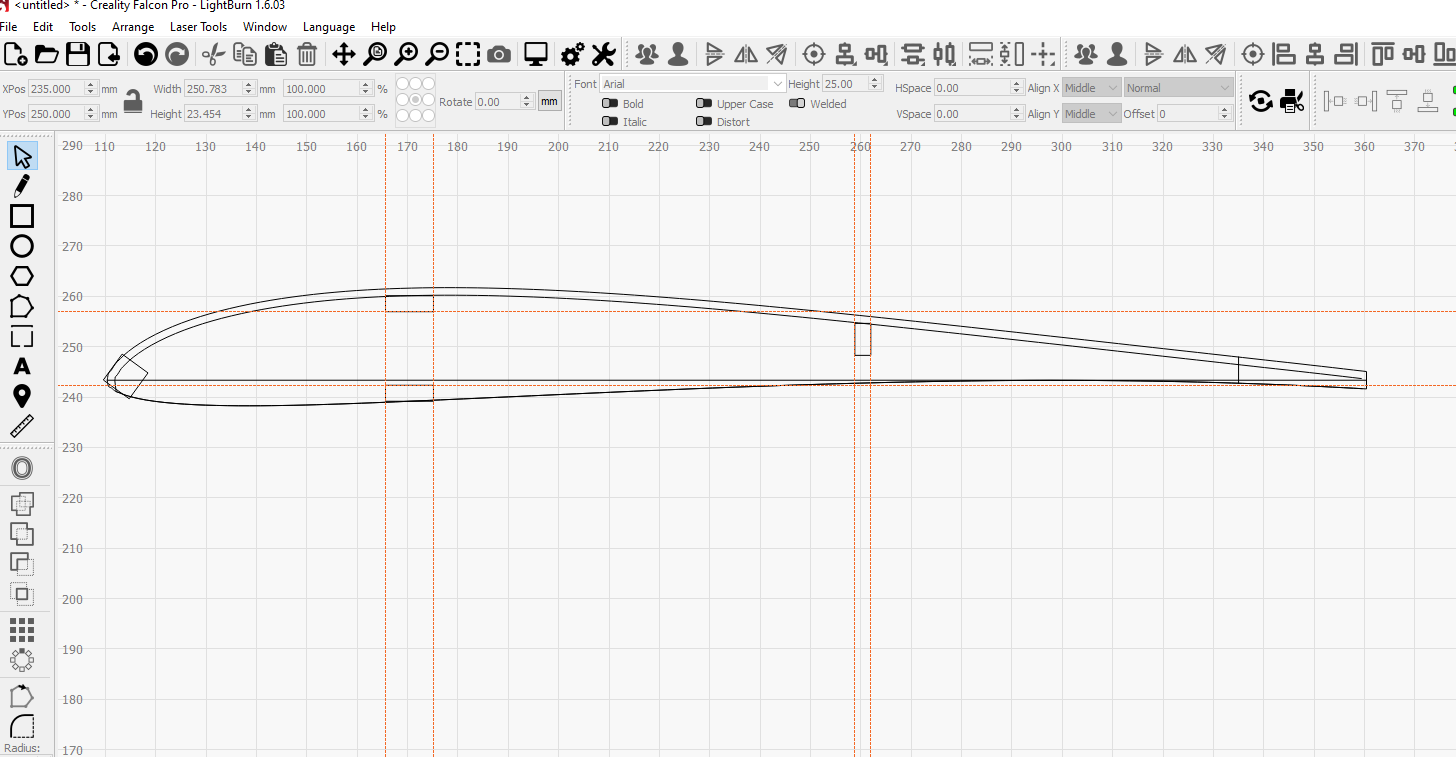

  2. A view of the imported dxf file airfoil in LightBurn.

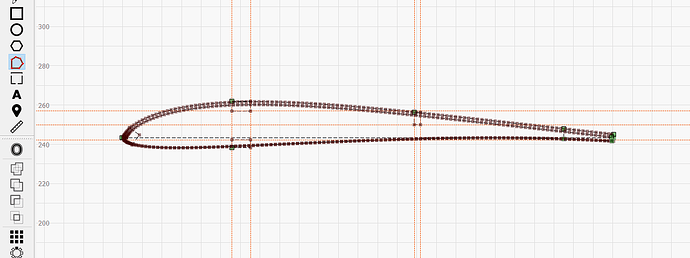

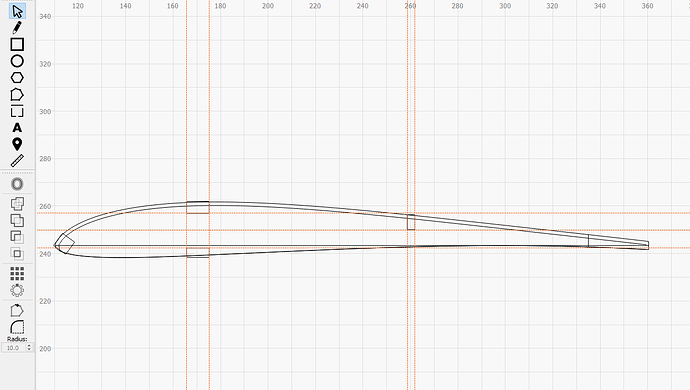

  3. Use the guidelines to create a baseline for all of the spars, or shapes that need to be added.

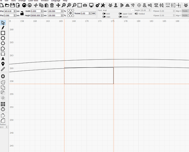

  4. Initially the spars may not intersect with lines that need to be trimmed.

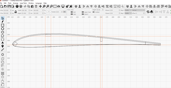

  5. The guidelines are used to mark the correct depth of the spars and then the height is increased to intersect with the top surface of the airfoil. Because LightBurn extends from the center outwards, the spar must be repositioned before it can be edited.
  6. The airfoil with all the spars fixed so that the depths are correct after editing is complete.

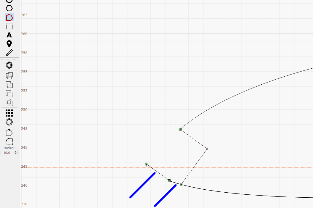

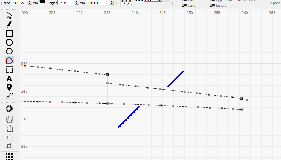

  8. I was making progress. Sometimes I would point at the line I wanted to trim, and hit the “T” and it would work. Other times I would point at the line I wanted to trim, and click with the LH mouse button. Then I would point at the line I wanted to trim, and hit the “T” and it would work. Then I tried to reselect the area effected (Pic 8B) and tried again.
In pic 8C I started to remove the nodes individually with the “D” key and that worked until it took too much of the line.
In 8D I used the “E” key to complete the missing line.

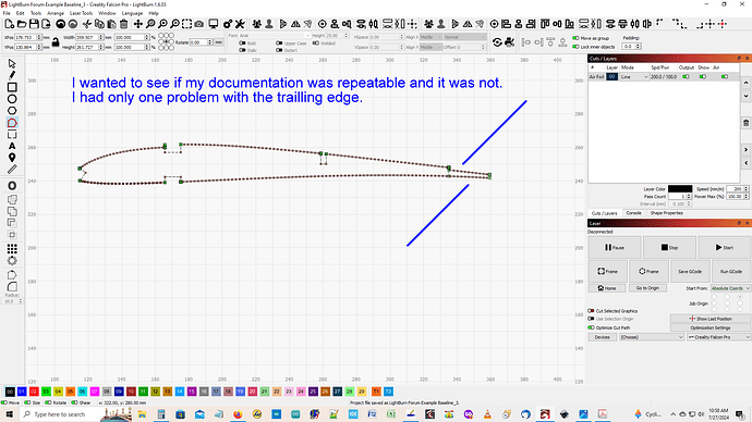

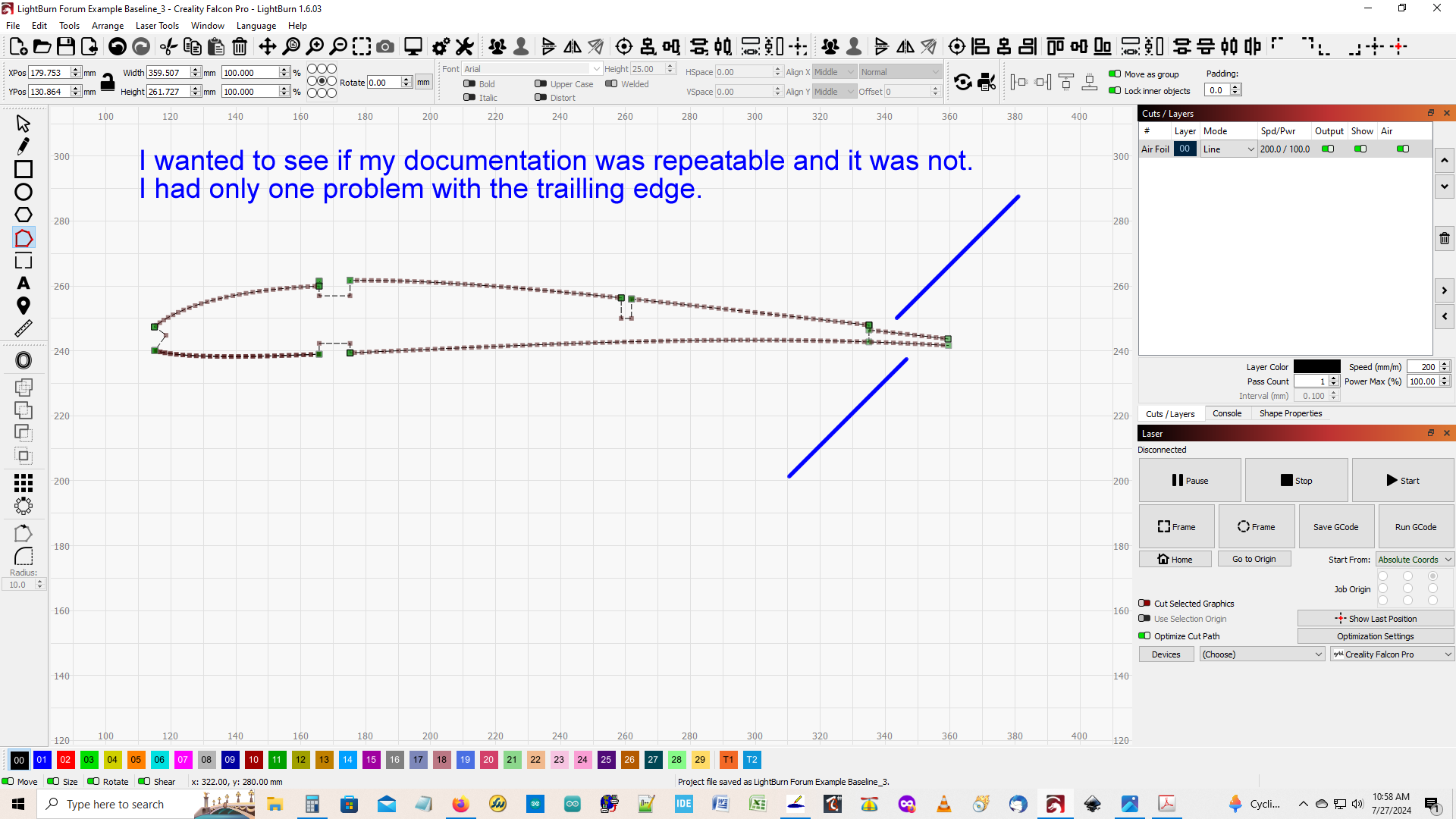

I wanted to test my lightburn file to see if the problem was repeatable? and it was not. The problem was similar, but I only had a problem with the TE. Not the LE like I did in the first example??

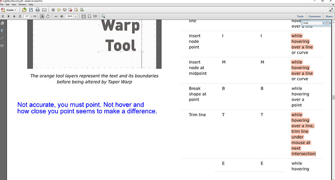

Does the pointer need to be on the line, or near the line? The pointer has a white outline that is invisible on a white background. Should I left click near the line.

LightBurn does not always follow it’s own rules. I tried to improve lightburns ability to select a line by reducing my MS Win 10 cursor size, and that helped. Before it only worked if I pointed at the line. But at some point that breaks down and it doesn’t matter if where the cursor is.
I am uploading a different file and it fails at the trailing edge just like my first file example did. There must be a set of rules for the node tool to trim the lines on the trailing edge that are not being met.

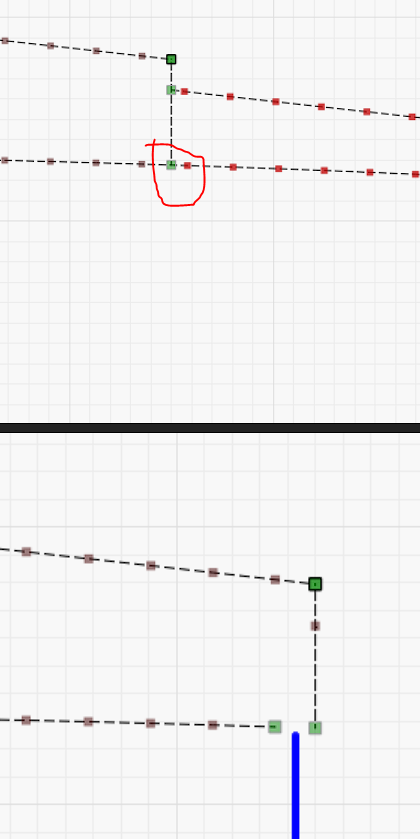

Hard to understand what you are struggling with since you are jumping around.

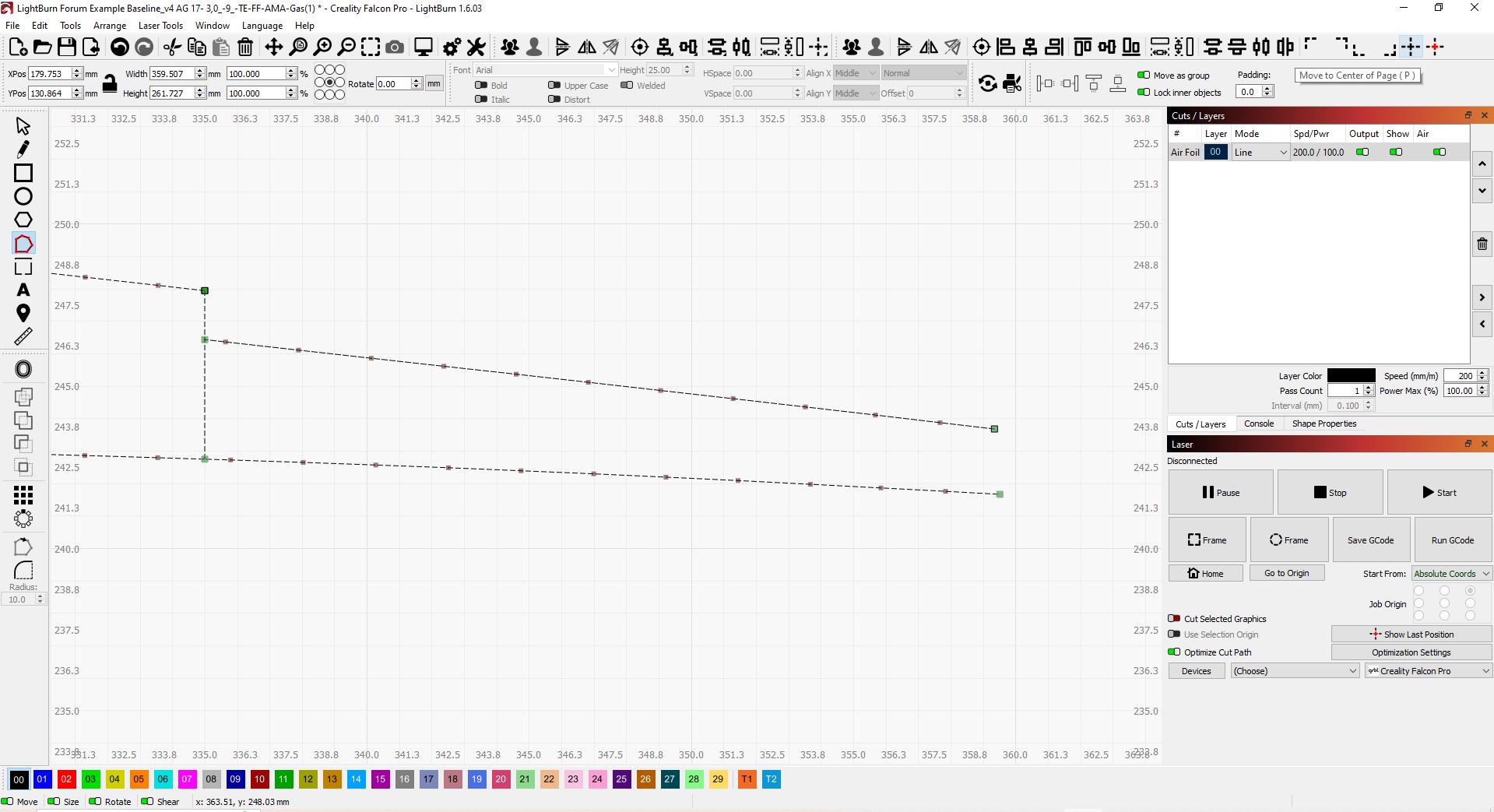

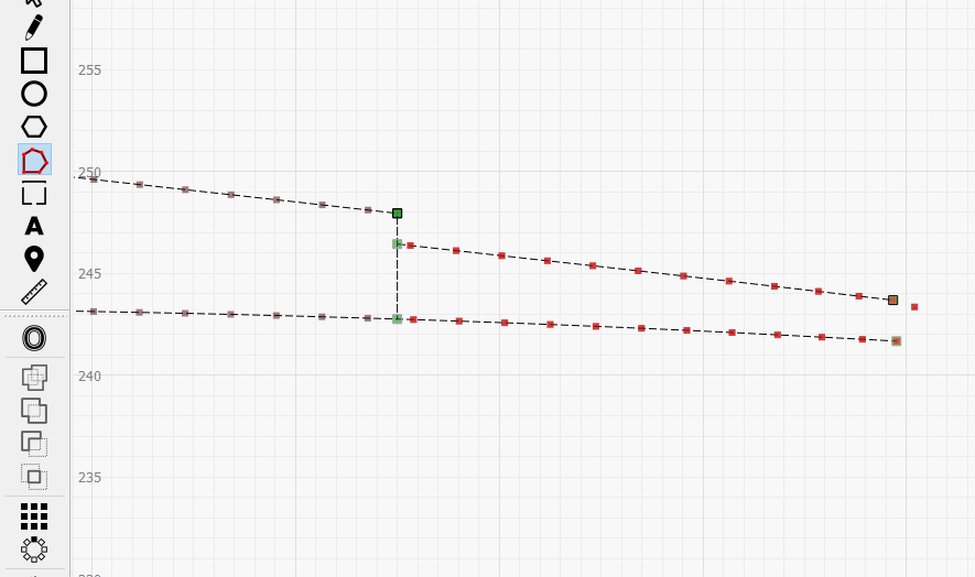

Seems one of the problems you are having is you need to insert some nodes, such as here.

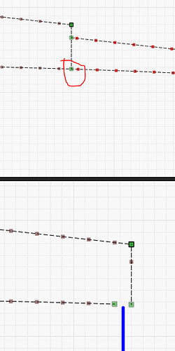

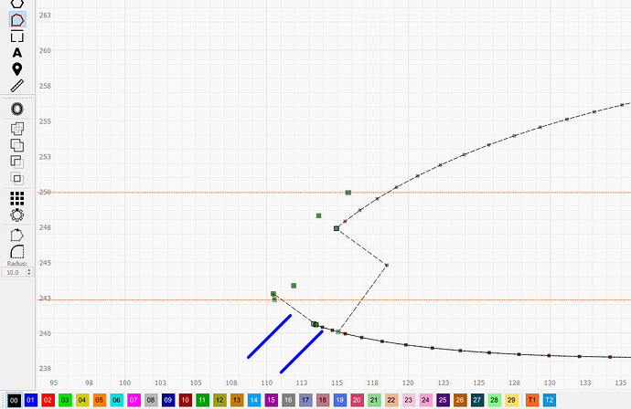

How do I eliminate this small section of line with the node tool? Every time I try, I end up deleting the entire vertical line.
Thanks
Bill M,
You need to insert nodes in order to delete that section. I believe you will find that if you grab that line, it is not connected to the horizontal lines.
Please post a LightBurn file with your exact problem so the membership can try to duplicate and understand the issue.
Produce the problem so we can see it.
@Dskall is correct.
These end up being tool paths for the head (tool) to follow. These machines are not smart enough to determine what to do when they hit a Y, T or a split in the path.
A single node can be a connection for a tool path going to it and a tool path leaving it… Results in a single path through the node.
As with @Dskall suggestion, if you move the two horizontal lines a bit away, you can add two nodes and delete the center portion of the line.
