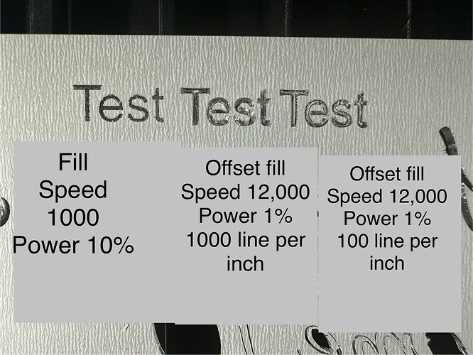

Hello,
Why isn’t the “offset-fill” option working for engraving the back of an acrylic mirror?
I am using the xtool P2, but even at its fastest speed and lowest power setting, it still cuts too deep into the acrylic.
The “fill” option seems to be working, but I’m trying to save time by using the “offset fill” option.
Thank you
Am I missing something?

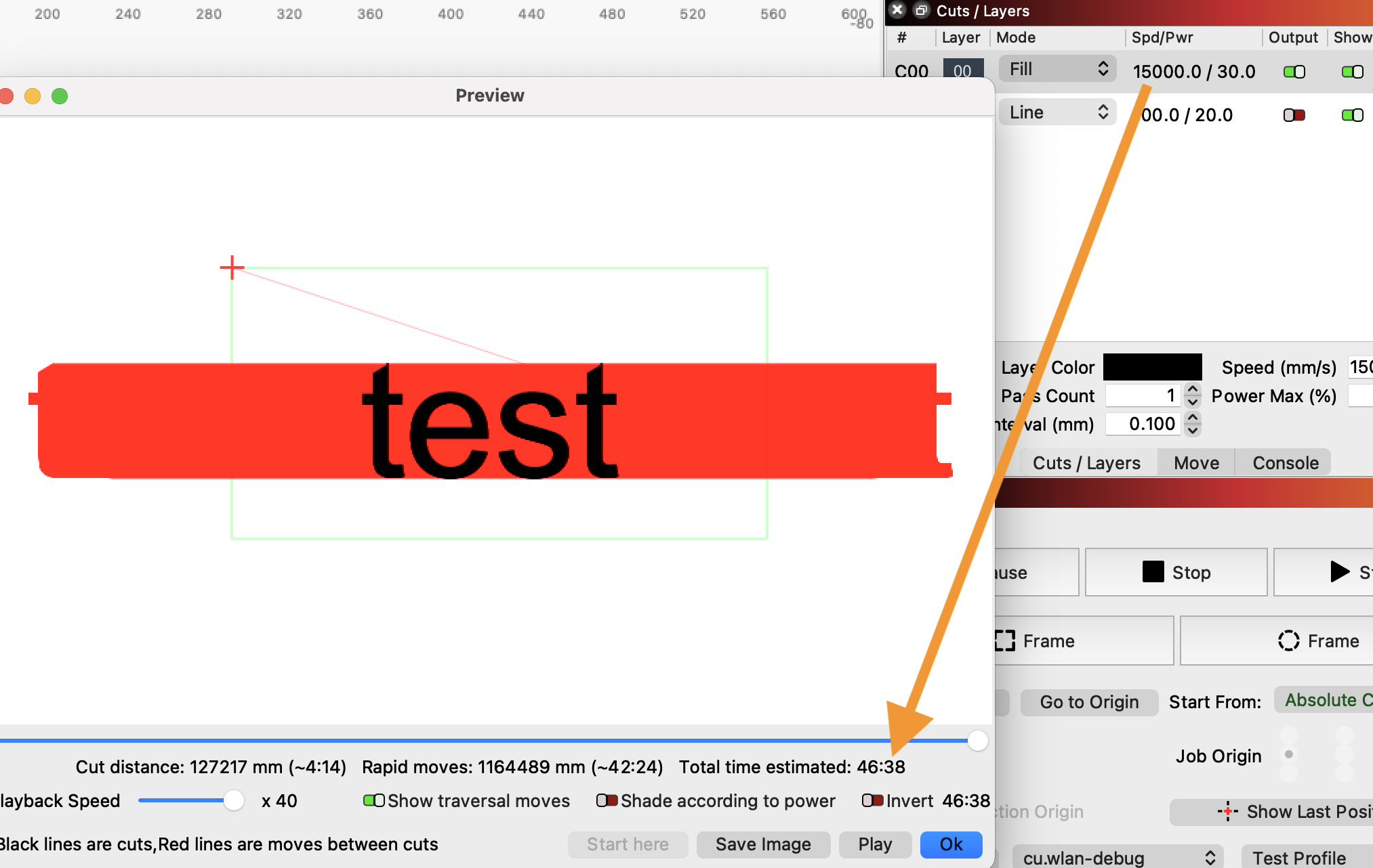

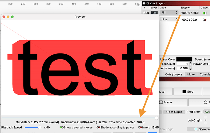

Look at your rapid travel distance. My guess is that it’s taking into account the acceleration distance needed to get up to your 15000 speed setting. On the slower version your rapid movement distance is significantly less. This is also shown with the red sections. Red is your rapid travel.
Increasing the speed results in additional overscan, the red areas beyond the burn. So increasing speed by itself does not necessarily result in reduced duration. You could potentially increase acceleration but that’s more a tuning exercise and a physics problem.
