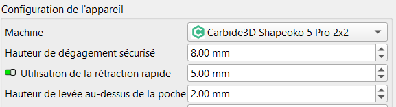

Why when I start a job does my Z axys goes down and come back up?
When I start the job, whereever I am, My Z axys gows down and then goes up to the top and continu. I think it’s going to my Z0. I am lucky it did not touch anything.
How can I stop it from going down and just start the job.
I found out that it’s the Safe Clearence Height that is tested when the job start.
THIS IS DANGEROUS, If I am over something, it will hit it before I start the job.
What can I do to make sure it is not tested when the job start???
Capture d’écran 2026-04-22 102513

  1. I posted this yesterday, So it’s more than 24H and not 8h.
  2. If an issue come up, and no other users find answers, The Lightburn staff should at least says something maybe says that they will come back with something.
  3. Yes I did my research and I have found nothing, Maybe it’s the search engine the problem?
  4. About cutting in the air, re-read my post. First thing the Spindle does it’s to go down to Z8, the number I put in the config for security. If I am over a holder, it will hit it. That’s what I want to NOT do.
Your 8mm safe height is NOT a ‘safe’ height if it is below the surface of your hold down’s etc?
Set your safe height to a few mm above the surface of any of your hold down’s etc, I have my safe height set to 30mm to clear hold down’s with no issues.
