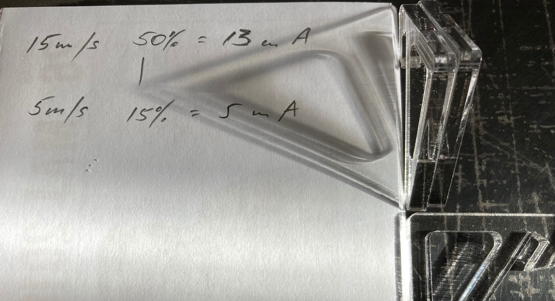

Your data for acrylic also suggests a not quite healthy tube. I have 2 8mm tests similar here, one with 6.5mm / s at 40% -10mA the other test is made with 7.5mm / s and 60% -14.5mA, both can be used and the result is reasonably nice.
I can try 6mm acrylic when I come to the workshop again but it will only confirm my assumption that your new tube is not super good, sorry.
the time is 1:25 - bedtime
There was no way to do the 6mm test, sorry.

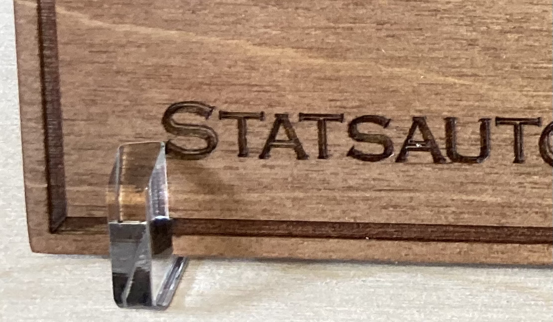

I have received a small urgent order of desk nameplates which were to be made of wood with “glass” stands. Here I chose 4mm acrylic. The result is nice.
Afterwards, I did a few quick tests with this material and although I did not go all the way to the lower and upper limit, it is remarkable how large an area is available. All items fall out by themselves after cutting, the items with the slow speed are a little bit bigger and should be compensated with kerf for it. When you do not know, no difference is seen on the edges. (my choice was some parameter in the middle)
But the most important thing for you is probably the parameters so that you can compare them with your tube presentation.
