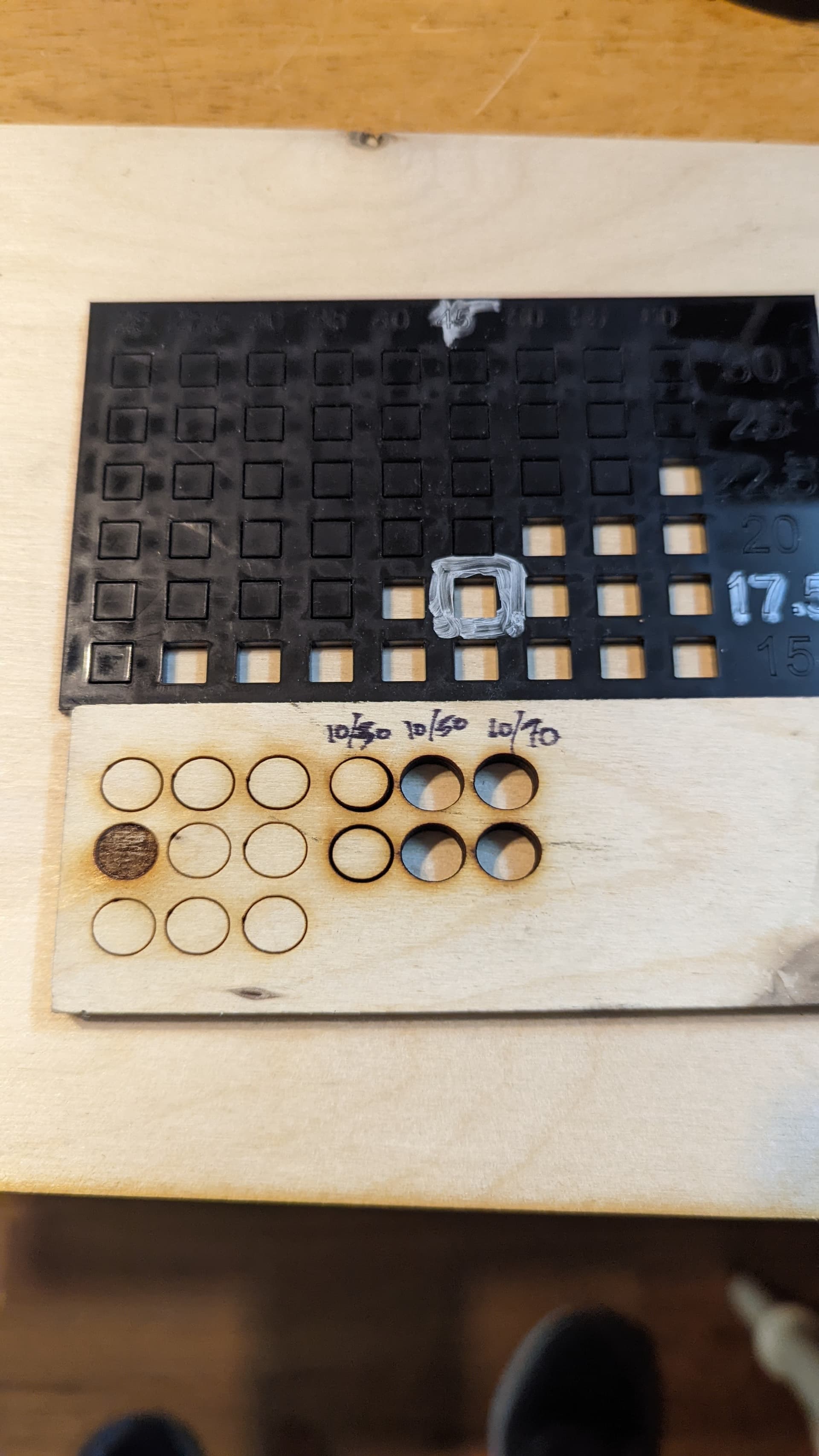

55w OMTech - less than 1 month of use. I am having trouble cutting through materials that I easily cut through before. Previously I could easily cut through 1/4 birch ply at 10mm/sec 50% power.
Also I’m having trouble cutting through black 3mm acrylic, though I easily could a week ago.

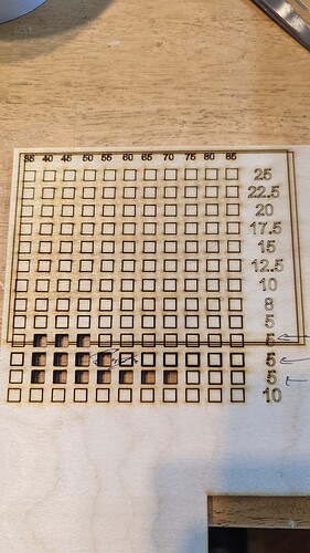

The stranger thing is that I can cut through the 1/4 ply at 5mm/sec at power ranges between 40% and 70%, but not above.
Here I show how easily I could cut below. Setting that worked easily for birch were 9-10mm/secon at 50% to 70% power. Acrylic cut at 17.5mm/sec with 45% power.
But now the Birch is cutting only at much slower speeds, and with strange power settings. I also tried adjusting the height of the z table slightly up or down from the standard focal distance.
Last night I was unable to cut through the 3mm black acrylic at any setting. Then today I tried cleaning the lense and mirrors. I was then able to cut thought the acrylic and thought the problem was solved. But when I try birch, I still am having issues.
