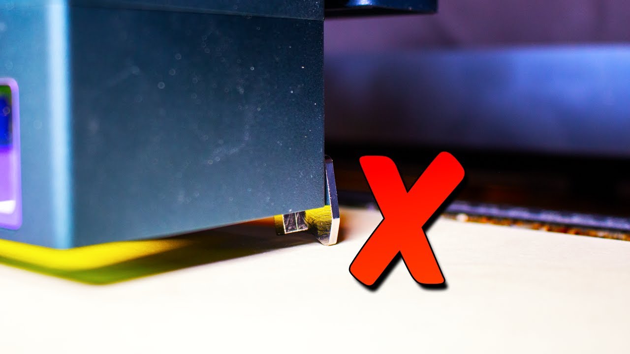

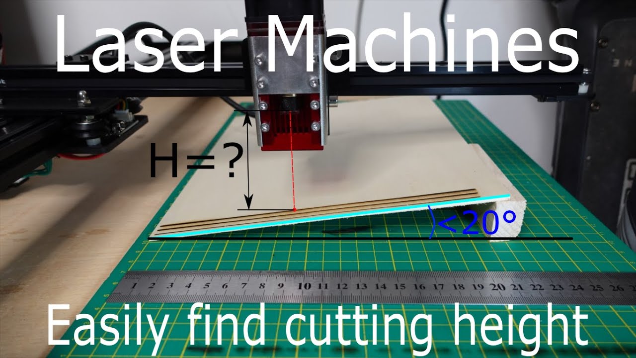

Focusing of laser - Phecda comes with an inbuilt focusing prong with a fixed distance. The distance between the nozzle and the workpiece decides the penetrating power of your laser. For engraving a fixed distance is sufficient regardless of the thickness of the material whereas for cutting the distance needs to adjustable.
Usually for similar 20W laser cutter such as Creality Falcon 2 you get a step focusing tool such as this:
where you get to decide how close your laser nozzle needs to be to your workpiece.

  2. If you have a 3D printer, try using the external focusing tools - Printables. ( Please try with caution).
I have a Creality Falcon 2 20W laser cutter, with air assist at full power and laser head set for cutting 3mm material. I am able to cut the black acrylic at 100% Power and 180mm/min in a single pass. I do no see why yours shouldn’t be able to cut if the above mentioned are sorted.

@rencheple Found something interesting on YouTube -
The comments sections also are informative and have inputs from Phecda owners as well.
Nice find! I’m doing this today!
