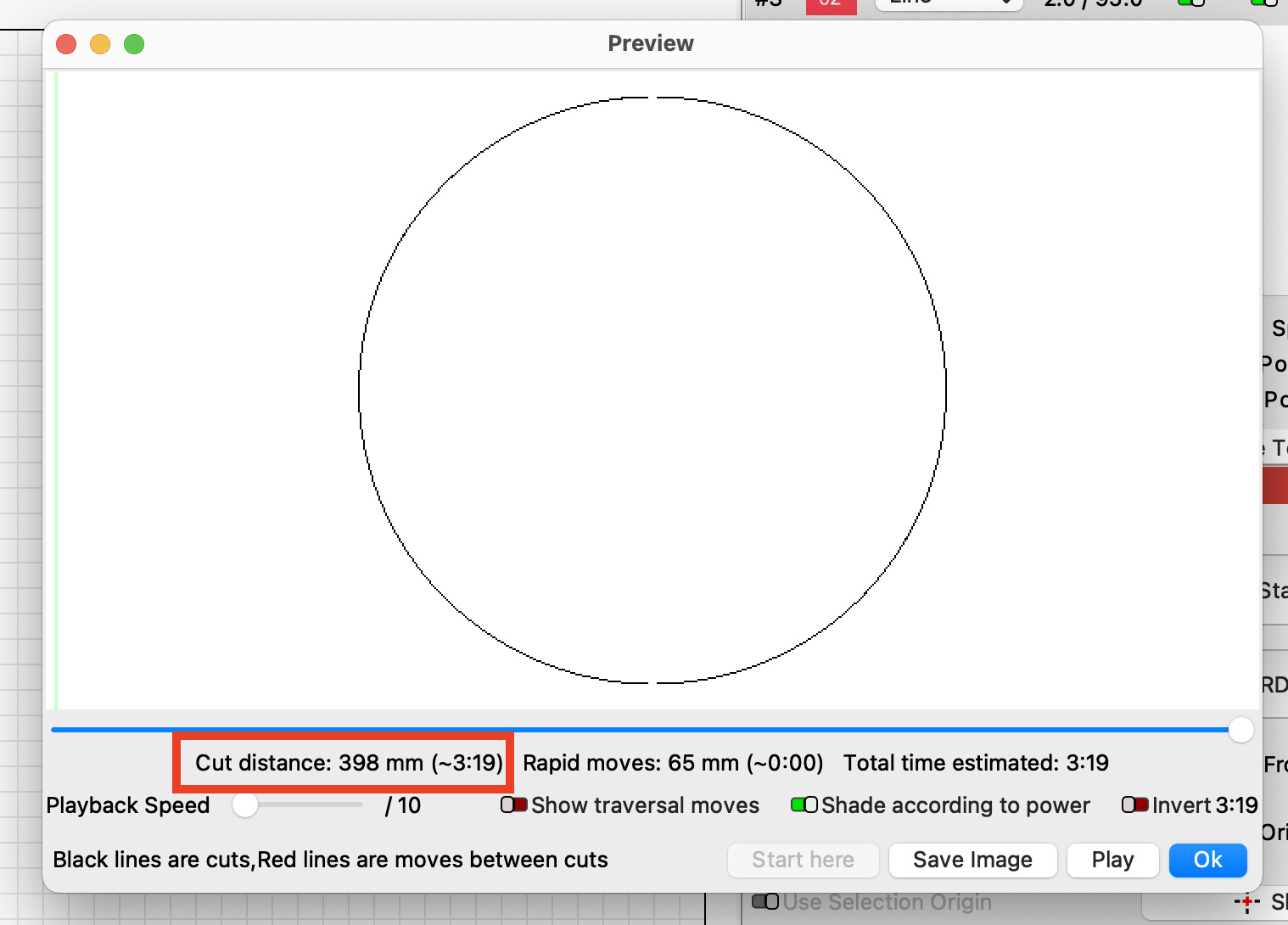

I am still relatively new to LightBurn and have a question. For people that use cut lengths to charge out laser cut time…will LightBurn calculate the entire perifery of the parts to be cut and give a resultant distance for charging out laser time…??

Yes, LightBurn calculates and provides a “Cut distance” in the Preview window.
