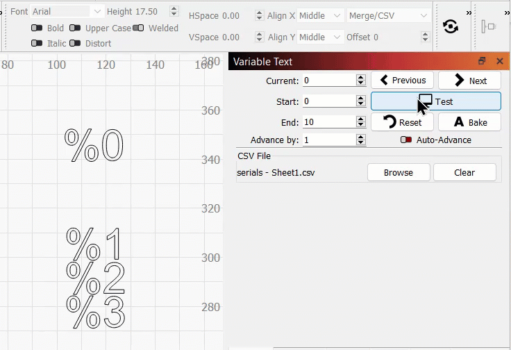

As an example, here in Google Sheets the serial number in column A, has been split out to B,C,D using the formula in B1 shown here:
You can then set out your number in LightBurn vertically, with each character as a separate text object - which you can then map to a column position using the % sign followed by the column number which starts at 0 (see in red below):
In this example, here is the saved .csv file from the spreadsheet above:
You can see here I have %0 for the horizonal number but I have also used %1, %2 and %3 for a vertical number:
@NicholasL Thank you, neat solution. However if I’m going to go to such lenghts to do this then I can also use my current workflow: paste the numbers to my illustrator template that turns them vertical and basically ready to cut while at it. Save as curves → import to lightburn.
It’d be just somewhat more convenient to be able to do this ad hoc without needing to jump around various software.and “Somewhat” here can amount to quite a lot over time. It just feels like a limitation that shouldn’t be there when otherwise the variable text and arrays work so well.
No problem, I must also mention that a huge advantage of using Variable Text in LightBurn is the ‘Auto Advance’ feature, when enabled, each time you click ‘Send’ all the serial numbers in the job will automatically be updated.
So, although not your sought-after solution, I’m sure this would still save you a heap of time compared to preparing and importing batches of curves from Illustrator.
