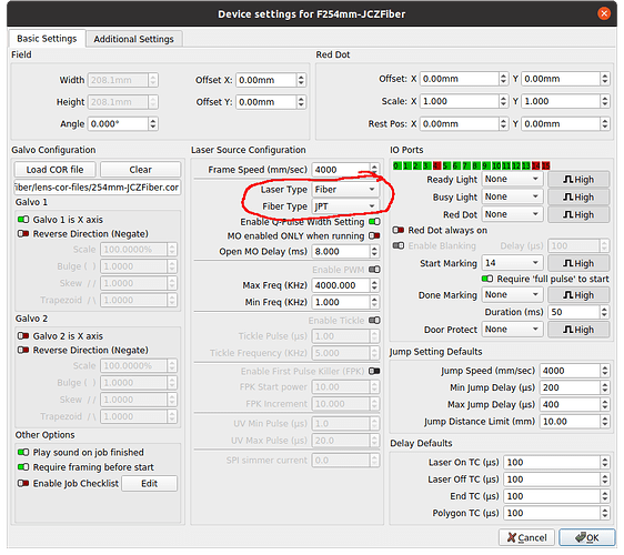

Hi all !! I installed ezcad2 with drivers on my win 11 laptop . Everything installed correctly. But the laser gets hung up framing and it stops responding. I then upgraded to Lightburn galvo and it stops at framing and won’t fire. I switched to my iMac and reinstalled Lightburn with galbvo and it works great. My neje 3 max works perfect on the laptop. Does the laptop not meet the requirements for fiber ?? Any suggestions or help would be great.
What source do you have and how is it set in the device settings?
Sometimes you have to change the source in the device settings…

You never said if you installed the Galvo drivers that come with Lightburn.
Yes I installed the driver with light burn
Source ?? Please explain

There are different laser sources, such as Raycus and JPT… These are set in the Device settings.
