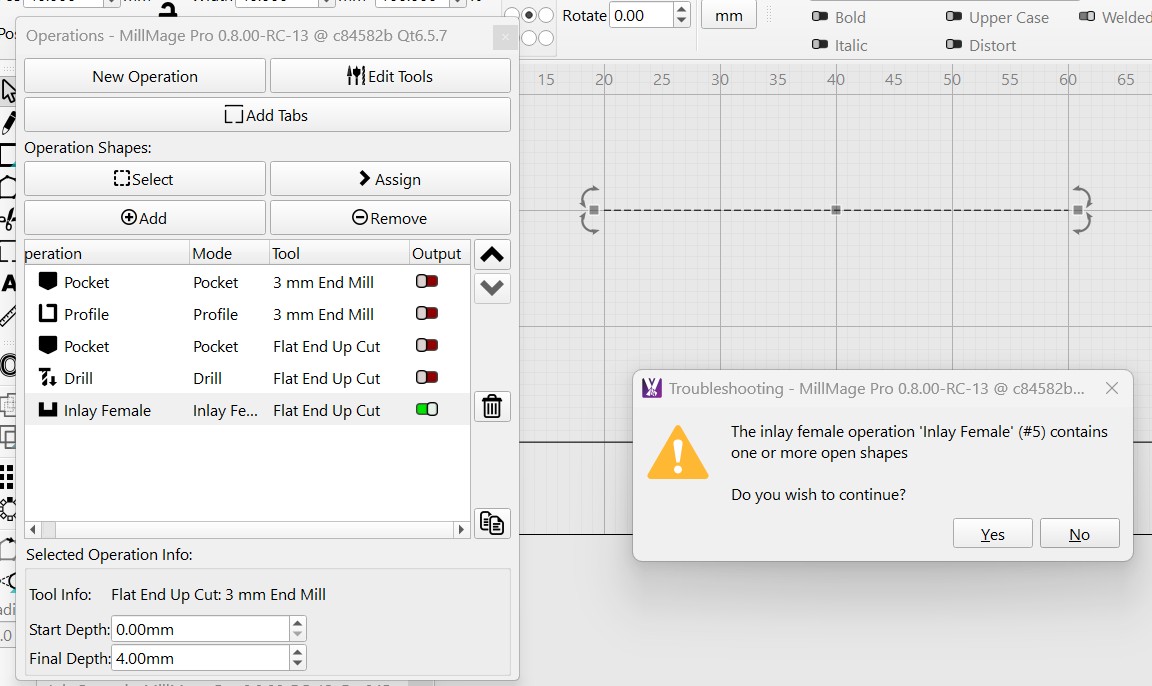

When trying to cut a straight line inlay, I received an Open Object error message. See picture below. Seems MM does not like open figures/objects. How do I get MM to perform operations on open objects?

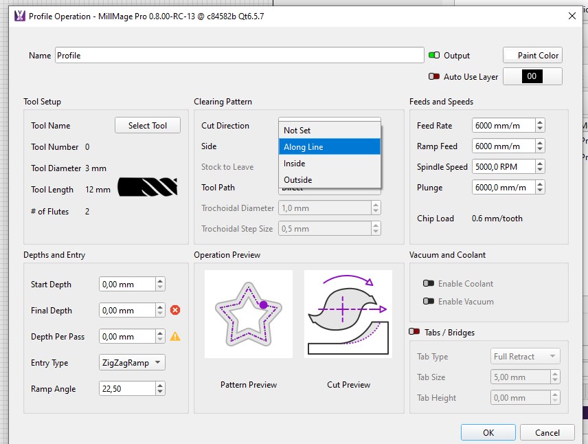

you have to cut with Along line
Thanks fotis. Where do I set “Along line”?
Thanks fotis
