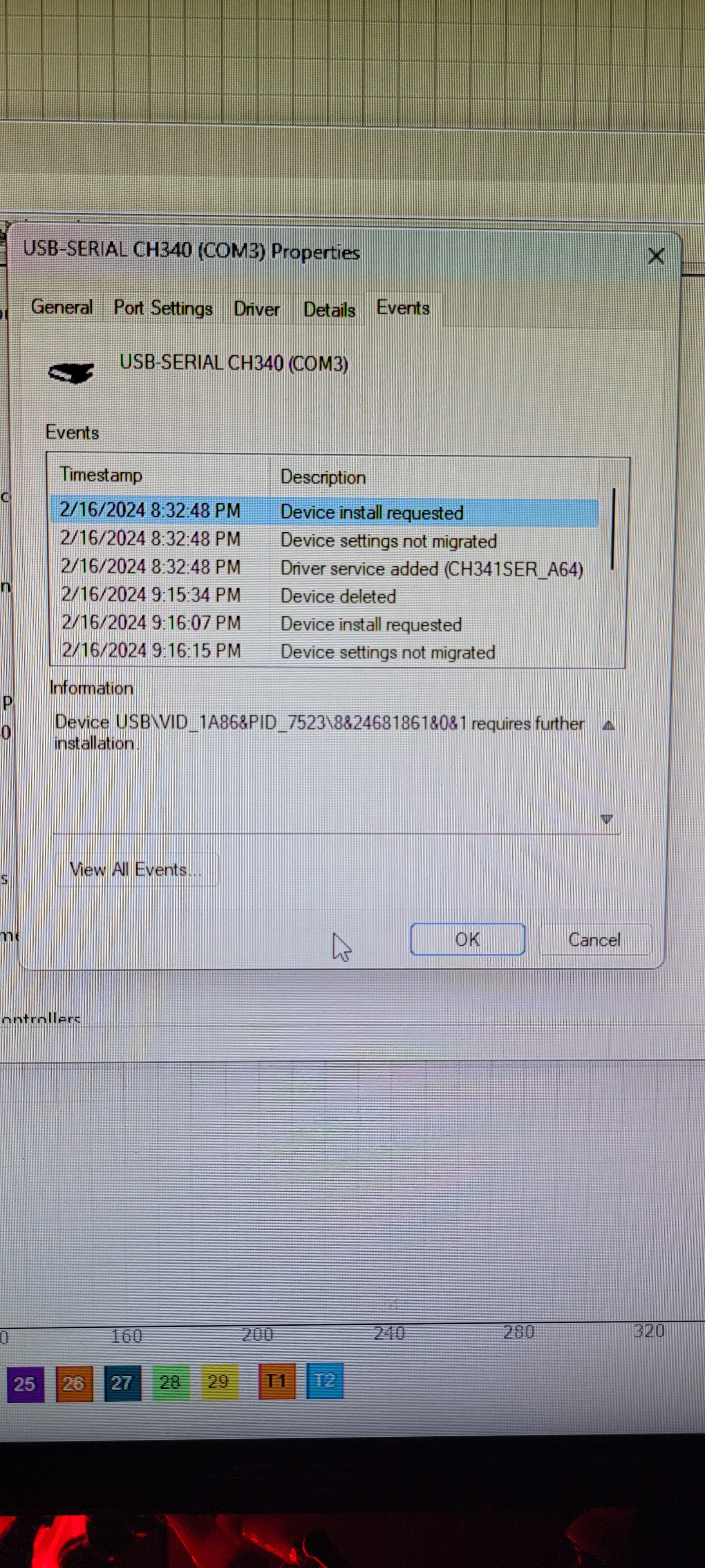

I’m at a loss. It happened after performing a Lightburn update. Roughly in November of 2023. I’ve uninstalled, reinstalled, reverted to an earlier version, uninstalled and reinstalled the ch340 driver. I still keep getting the error. I did find that when i look at the com port through windows device manager it says
Device USB\VID_1A86&PID_7523\8&24681861&0&1 requires further installation.
I’ve uninstalled and reinstalled the ch340 driver multiple times and am still getting this message in the events list in the usb properties window. Super frustrating. im running windows 11. was running 11 just fine until the Lightburn update.

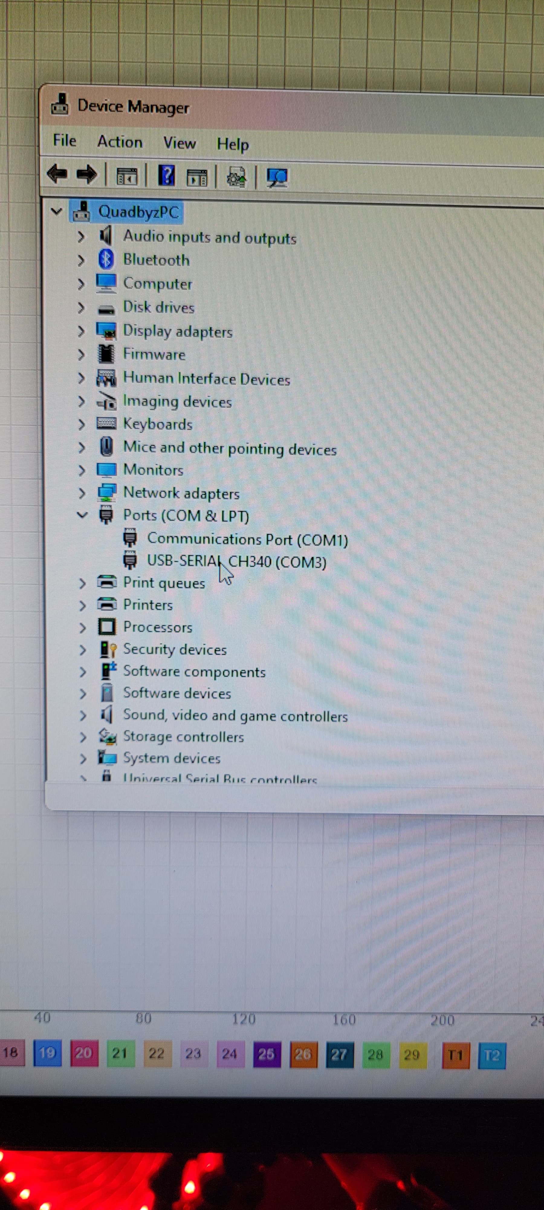

Please provide the following:
  1. screenshot of Device Manager showing the COM port assigned to the laser
  2. full screenshot of LightBurn with Laser window in view

Make sure all other potential competing apps are shutdown. I’m noticing that you have another COM port so you must have other devices that create a serial port.

I’ve done that multiple times with no luck still. I’m still getting the message in the event list when looking at the ch340 driver info.
Device USB\VID_1A86&PID_7523\8&27ab6e50&0&1 requires further installation.
