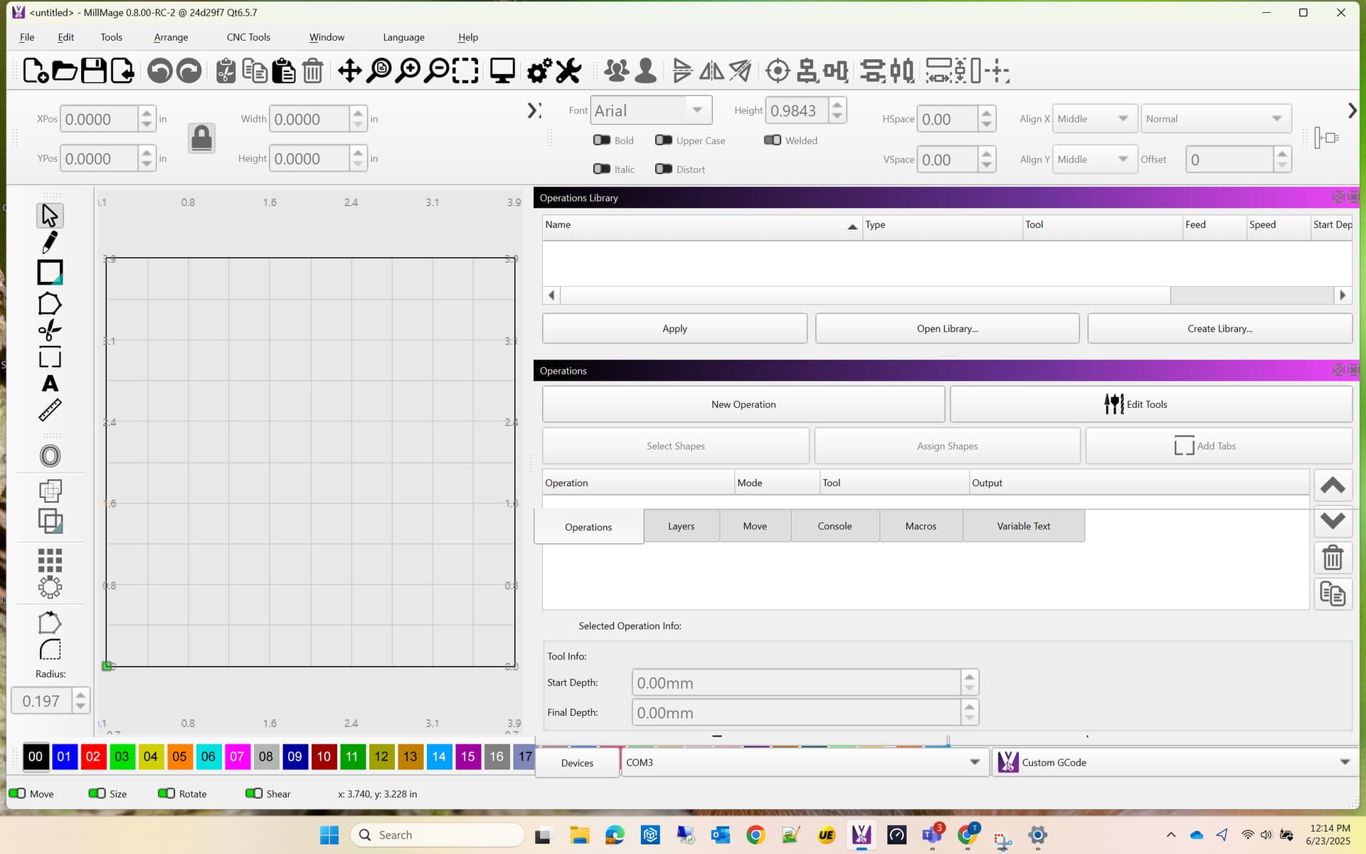

I had a thought. I have a very high resoltion-able laptop screen plus some large monitors. Even with my laptop, I was using MM at high resolution 2560x1600 but with 150% scale. Buttons don’t all display. When I change to 125% then it does. Could there be missing math for your button size calculations? For instance, it would seem the buttons for Job Control could be made smaller for higher scale?
There is a set amount of pixels required to display MillMage and LightBurn, and we do our best to make sure the software is fully functional in those low-resolution situations. If you’re at 150% scale, some things are likely dynamically hidden. Can you show us a full screenshot?

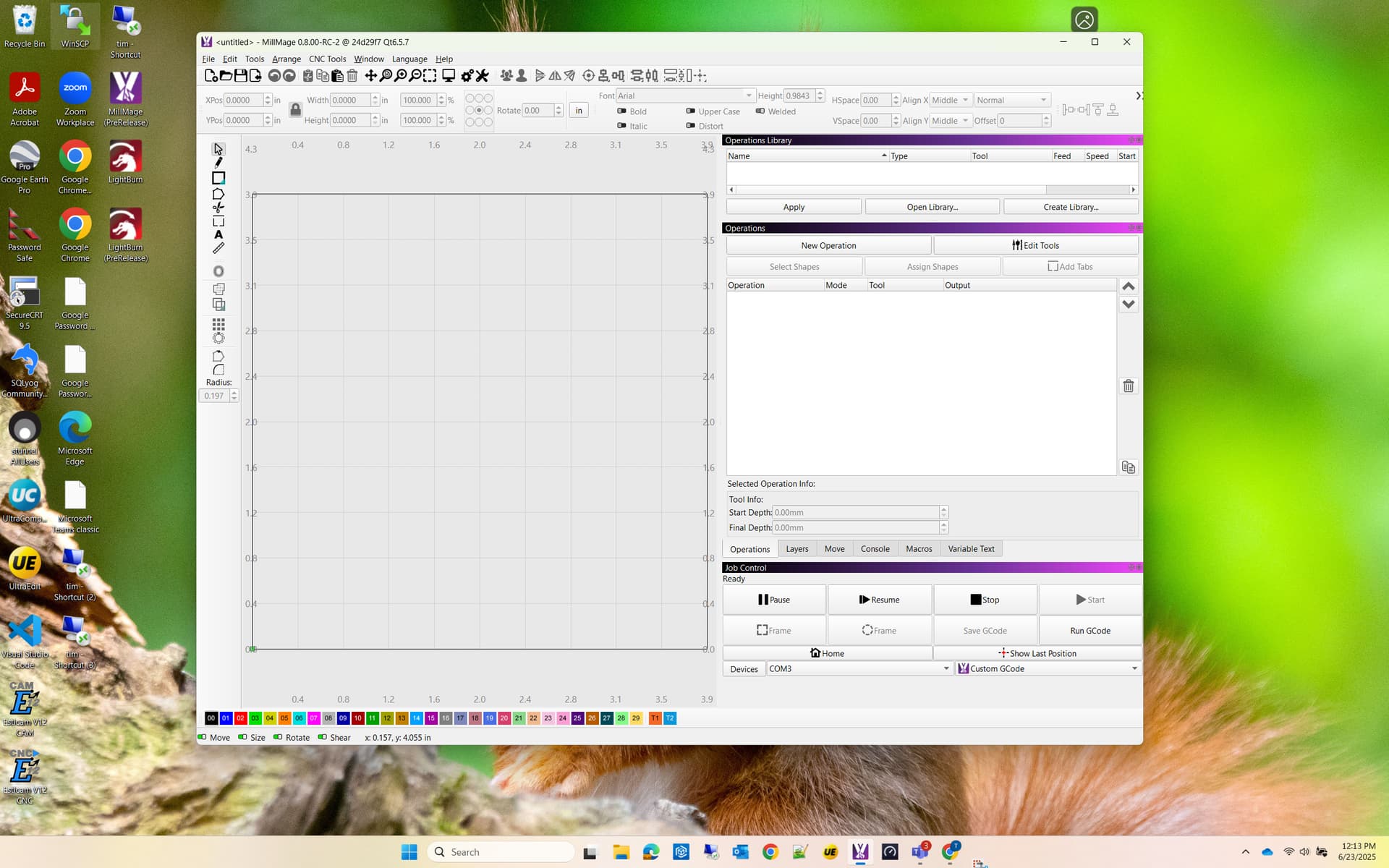

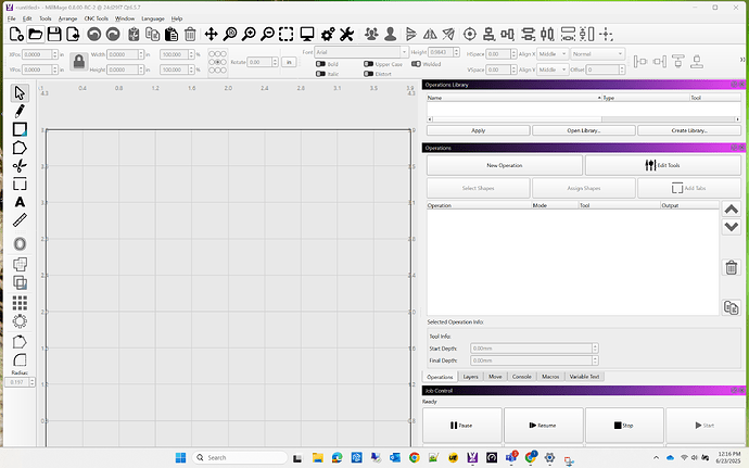

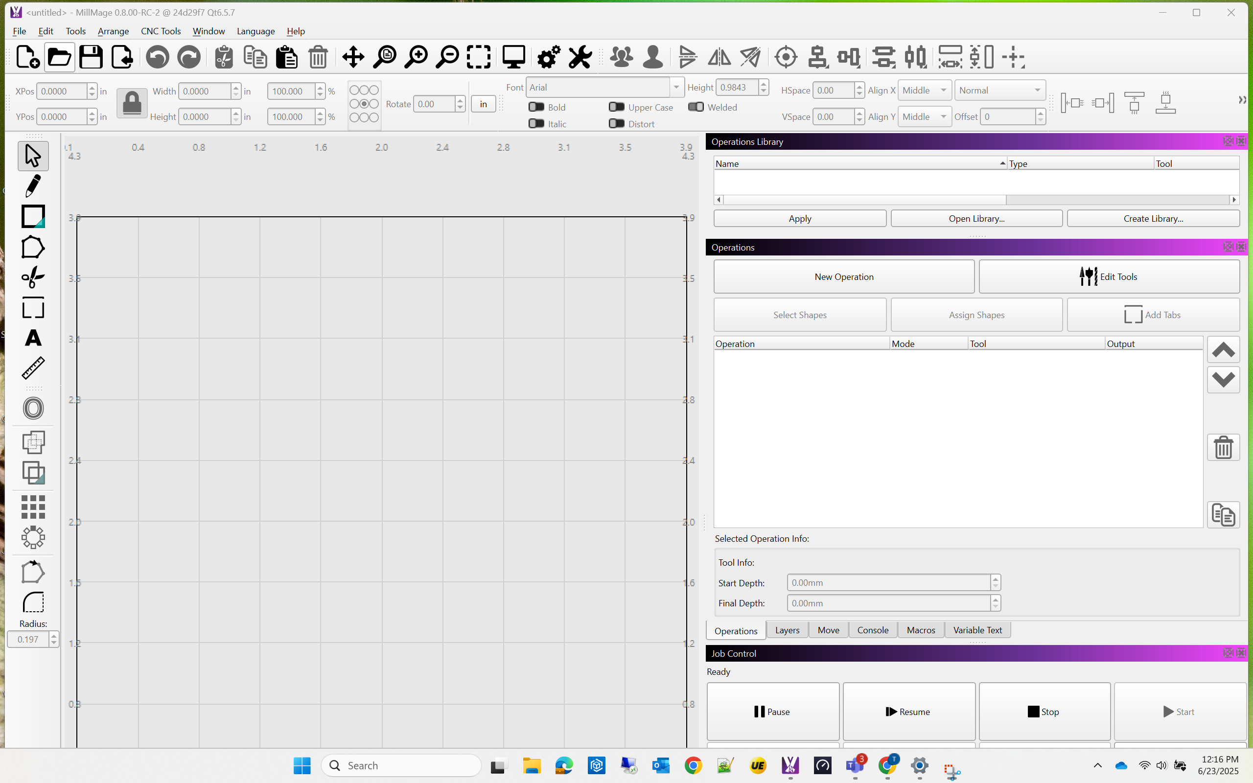

I have taken three screenshots. The one where everything looks good is at 125% scale. The other two were done at 150% scale. I also restarted MM to see if difference and it draws a new window differently - I suppose it took math into effect but does not when still running as someone changes the resolution or scale? I hope these help. Let me know if anything else is needed.
BTW, you have to look carefully at the bottom to see the top edges of buttons barely peeking. So its not that buttons are entirely hidden by not being drawn but simply overwritten from I can tell.

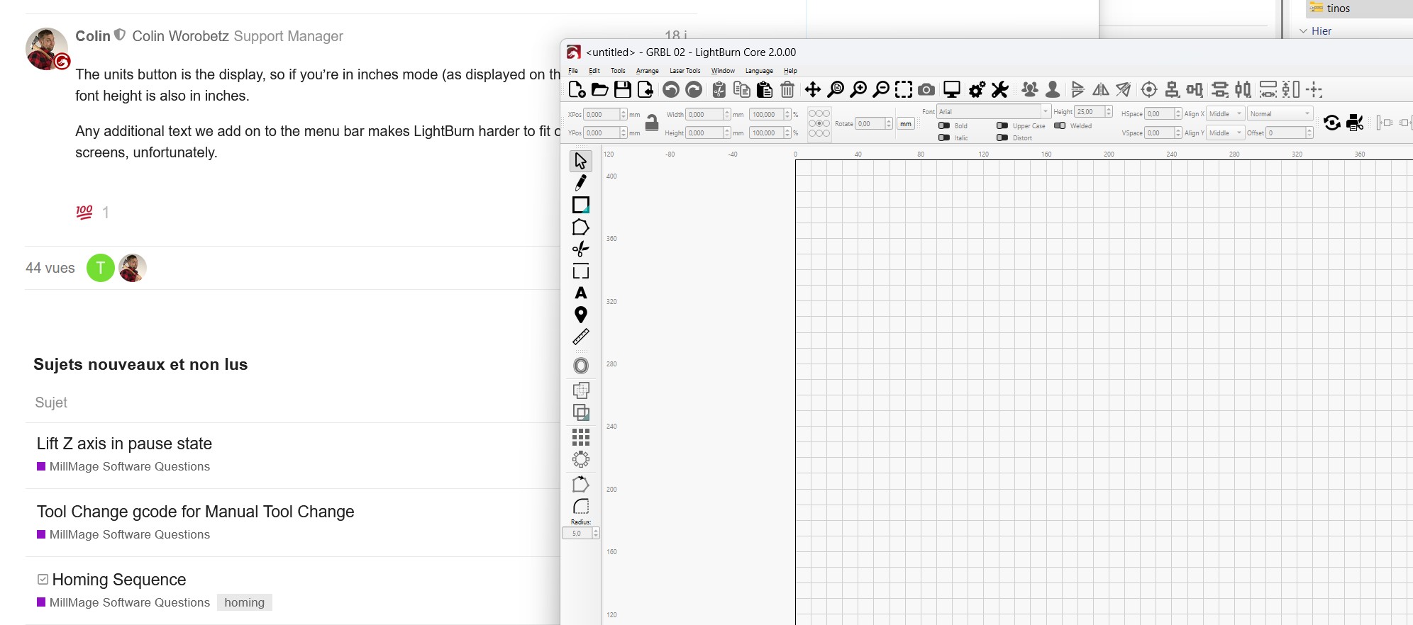

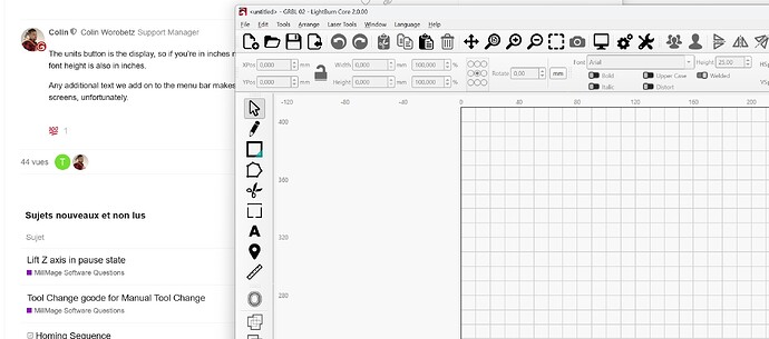

since the update to “core 2.0.00” I run into the same problem.
my display is 3840x2160 (4K) and the recommended setup scale is 150 %
With this setup Lightburn is using big fonts … it was not the case before the update.
The lightburn window at 150% do not fit in the screen height and I cannot reduce the height of the lightburn window …
125 % ==> very small fonts and shapes
175 % ==> same as 150 %
125 % :
150 %:
175%:
same with 2.0.01
Try turning your scaling off (to 100%) then use the High DPI settings under ‘Edit > Settings’
