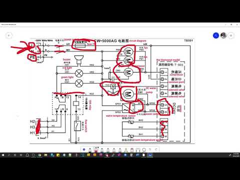

i have a k40 and just purchased a cw 5000 chiller . I’ve been trying to find info on wiring H1-H2-H3 chiller alarm output to my machine . and come up empty after days of looking. I just want to use that circuit to keep the tube from firing if there is a problem with flow. I have an upgraded omtech control board, similar to cohesion 3d . which has a ton of extra connections on it. first I thought I could just wire it in series with my door safety switch, but the 3 wire connection made me leary of doing that. Any info would be helpfull . thanks
Check out this video. Looks like H1 is common, H2 is NC, and H3 is NO

Mine has H1 going to ground and H3 wired to the Water protect of the Ruida. When it operates properly, it will pull the input of the Ruida low showing active coolant.
Does your controller have an input for this.? That would be the best way to handle it.

Thanks, I just wired it in series with my door lid switch
