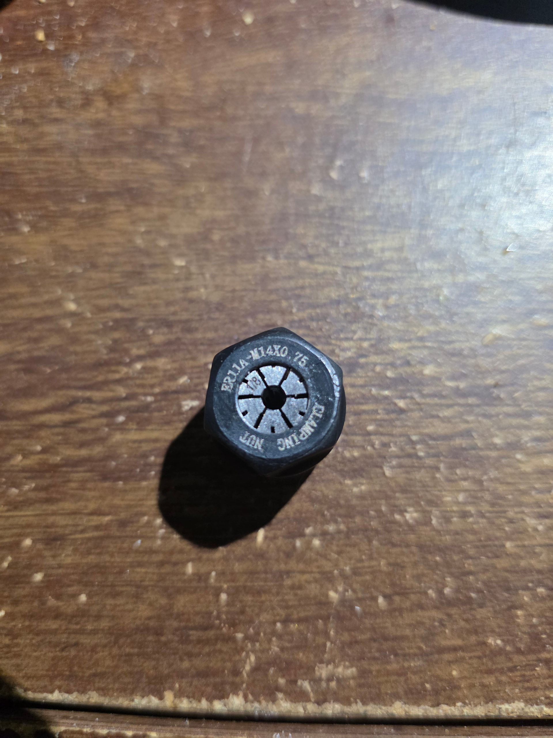

only problem I’ve found is it only takes 1/8” shanks, it doesn’t take 1/4”
Its a little hard to tell but you can likely purchase a larger collet for your spindle.
This looks to be an ER-16 or maybe ER-11 collet - if you remove it and send a photo we can likely help find the right one for this machine.
I did a search on the machine and AI results said not to use 1/4” shanks on this machine, I would think if I put the 500w spindle it would handle it, although I’m not familiar with cnc
Perfect - that’s an ER-11 collet. You can definitely put 1/4" tooling in the machine how well it will operate with that tool is a different story. You can find ER-11 collets at all the usual online spots with a cursory search. You could also split the difference an use 3/16" tooling, or similar equivalents in metric if that’s easier for you to get.
does that insert with the fingers just pop out? I tried pushing on it but didn’t want to break anything
never mind, pushed a little harder and it popped out, thank you so much for your input!!
Collets have a little lip that they need to pop down in to. When you reinstall the collet, ensure that the face of it is all the way at the bottom of the collet nut. It should look as it did in your above photo.
