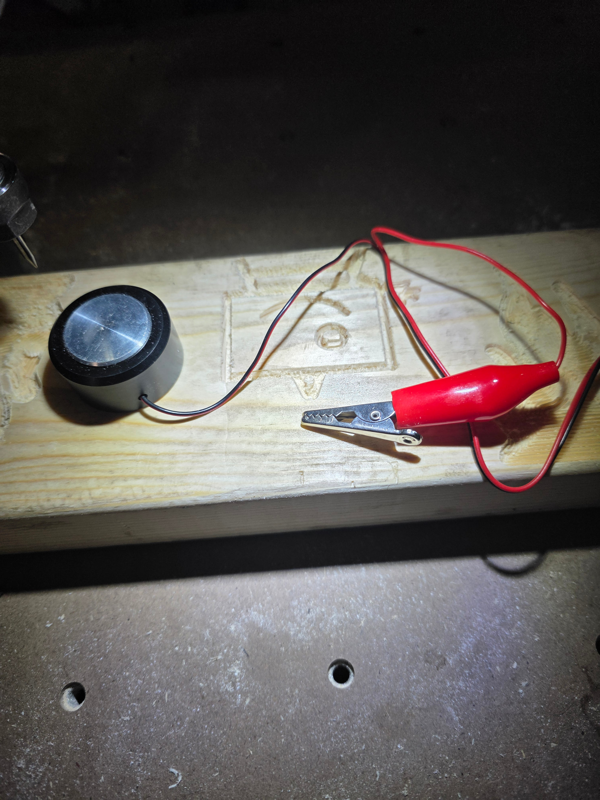

this is the probe I have for this wizmaker, works fine in easel and candle but not in millmage, ive tried different setting i can get it to come down and touch it, maybe a bit too much, it ledtna small dent, but then project will not start until i manually zero
You may need to slow down your probe speed in the Probe Setup dialog. Some hardware is slow to respond to the probe completing the circuit, and it needs a little more time to detect the touch.
Please see here: XYZ/Puck Probe Block - MillMage Documentation
