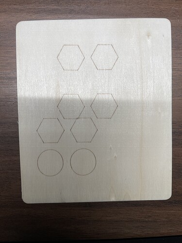

Thank you! I’m scoring at the same speed I’ve been using for over 2 years, the wobbling started just a couple weeks ago. I did try lowering the speed multiple times, there’s no change to the wobbling(I normally score at 300mms, tried it at 100mms and 50mms with no change). The wobbles are also there when cutting(25-35 mms). They’re only occuring on lines that require the x and y axis to move in tandem(diagonals and curves). There is no noticable wobble to straight lines going side to side or up and down. I’m not having any issues with engraving, just scoring or cutting anything with a curved or diagonal line.
Hi!
Did you find out what was causing it? It’s also happening to me but on 75º diagonal lines only.
I have the same issue with diagonal lines and curves only. Oddly enough I can print circles perfectly. I decided to do some test burns with hexagon shapes while adjusting acceleration. I thought that solved my problem until I tried my original projects with the same settings and it still happened.
