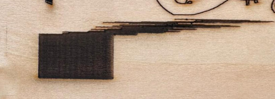

The fills look terrible — they start from bottom to top, and around 60–70% of the way through, they shift or misalign.

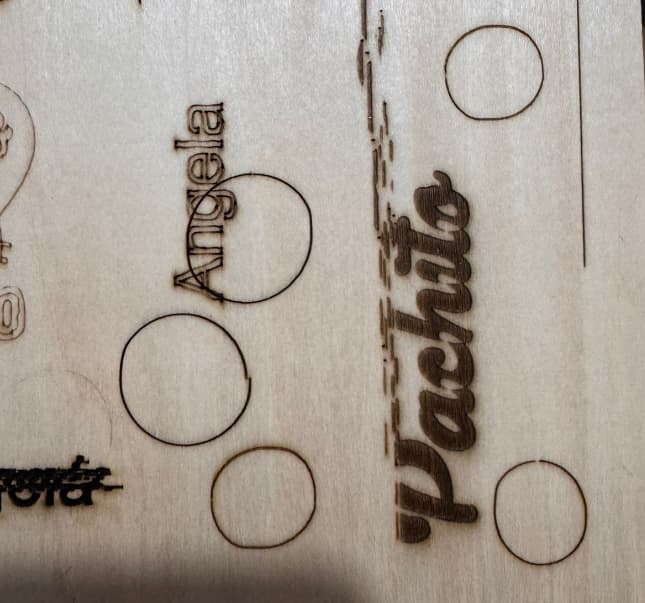

When drawing lines, especially circles, the shapes come out like eggs or ellipses, and sometimes they’re not even closed.

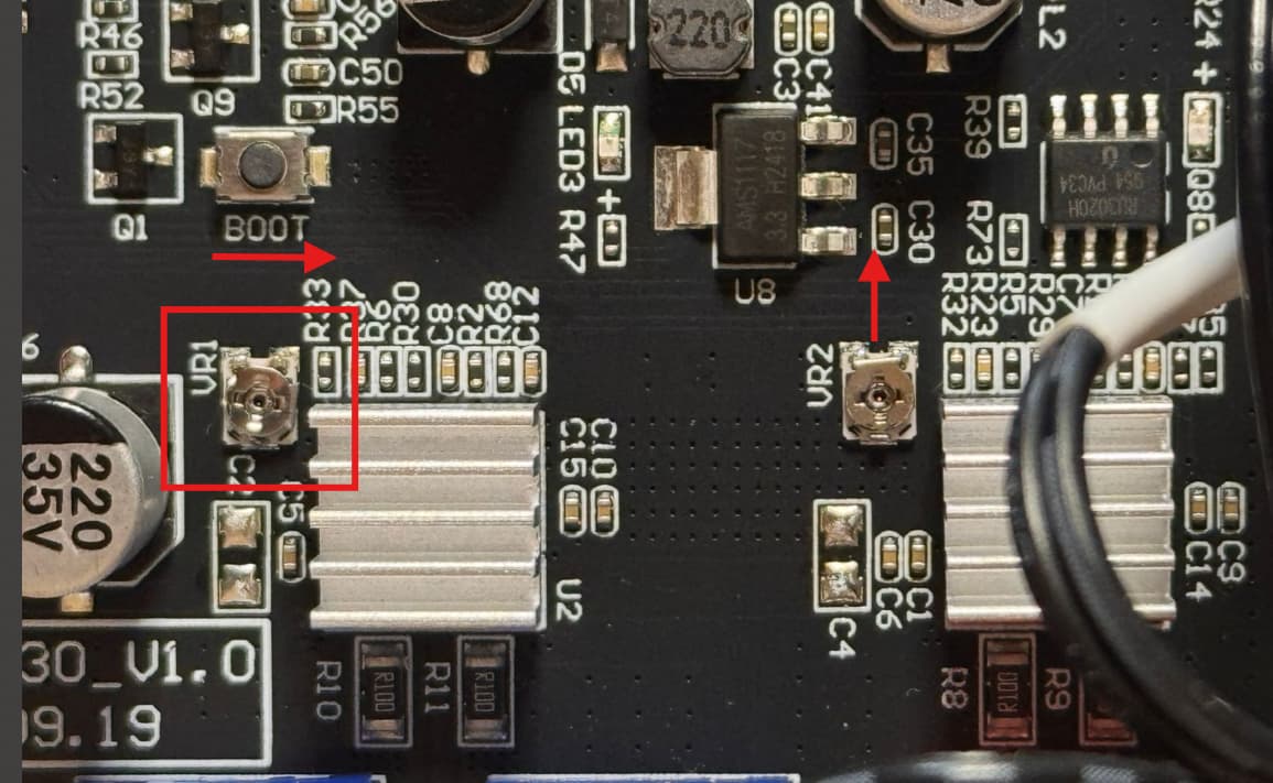

I have the Y capacitor turned to 90 degrees right. X motor points at 0 degrees.

That’s wrong. Do you have the extension kit? Then you should turn it 45 degrees. If you don’t have that kit, do not touch the reference voltage!
Check the guide posted above and go through all the steps mentioned there.

No, you still need to turn it 45 degrees backward.

Still, when you say turn 45 degrees means diagonal right? In the photo I have just Y motor at 90. Am I correct?
Yes, diagonal. Here is a guide: Workspace extension kit - Diode Laser Wiki

The out-of round circles are showing a little bit of backlash or looseness. The easiest way to find this is to slowy wiggle the laser module with the power off to see where the available motion comes from. You wouldn’t need to push hard enough to turn any of the stepper motors.
Pushing the laser module quickly can cause one of the stepper motors to rotate quickly. This can generate a voltage spike and destroy the stepper motor driver chip on the controller.

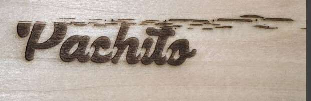

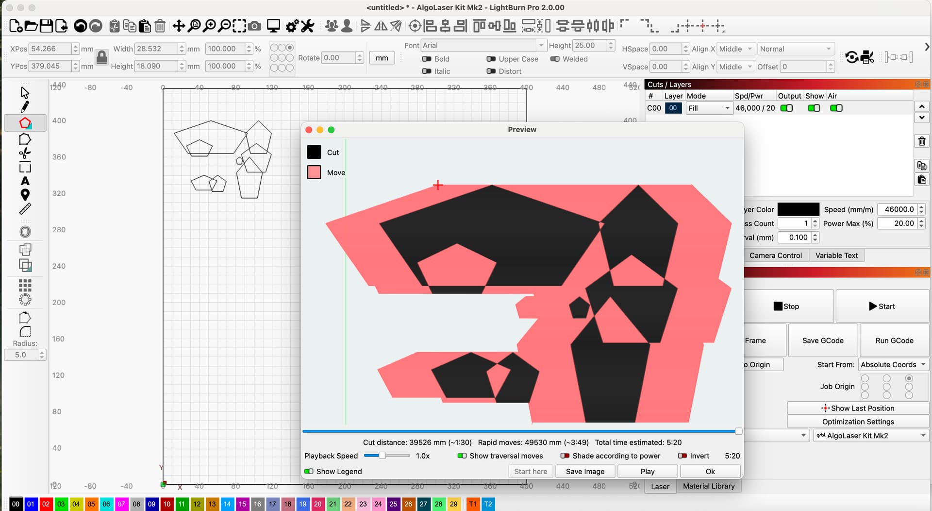

The progressively scattered nametag engraving looks like it’s related to Overscan.
Overscan is a feature where the laser module overshoots the end of an image while engraving.
This allows the speed across the engraving to be held constant and allows the engraver some room on each side of the artwork to slow down, stop, reverse direction and speed up to the commanded speed of the engraver.
When the speeds are high, the overscan is larger. It takes more room to slow down. The art must be moved further away from the edge of the work area to make more room. The progressive scattering happens in one direction (at the end of the nametag). It’s showing that you’re engraving an image or ‘filling closed shapes’. This is all set correctly and looks good!
I believe that the laser module is hitting the frame or chassis on the side closest to the beginning of the nametag. The progressive scattering away from the beginning will stop when the nametag is far enough away from the frame or chassis to allow the engraver to apply the overscan.
The expected overscan behavior can be inspected in the Preview window. With your project loaded in LightBurn, click Window in the top row, and then Preview. It’s near the top.
In this window you’ll see the project as the laser would receive and understand it. You can zoom in and out with the mouse-wheel. If you’re seeing red travel lines, you can see if the overscan is crossing the workspace. If the red lines aren’t there, you can enable this visualization tool by enabling the switch marked, “Show Traversal moves”
Here, the quick sketch is showing the overscan (on filled overlapping closed shapes) extending beyond the workspace (the green line).
The art needs to be moved to the right in the workspace in LightBurn, so the overscan can’t drive the engraver into the frame of the engraver.
In this example I set the speed excessively high to exaggerate the overscan behavior.
When you need to make a large project that is close to the limits of the engraver, you can cut both speed and power to reduce the overscan to maximize the size of the art that you can produce with your machine.

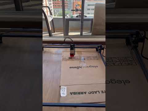

Here what the maching is doing:
Now… I dismounted the Y motor and tested it by connecting it to a diferent ports. On X port (Red one) works well. On Y sockets (Blue and White ones) tries to move but doesn’t. However, if you hold it, you feel its moves, but the rotor is not moving.
From nowhere the Y sockets got burnt. Are they damaged? Is there any software test I can perform to know what happened?
That sounds like the driver is defective. It can be caused by the 90 degree setting on the potentiometer. Send a video showing the case to Sculpfun and they will send a new mainboard.

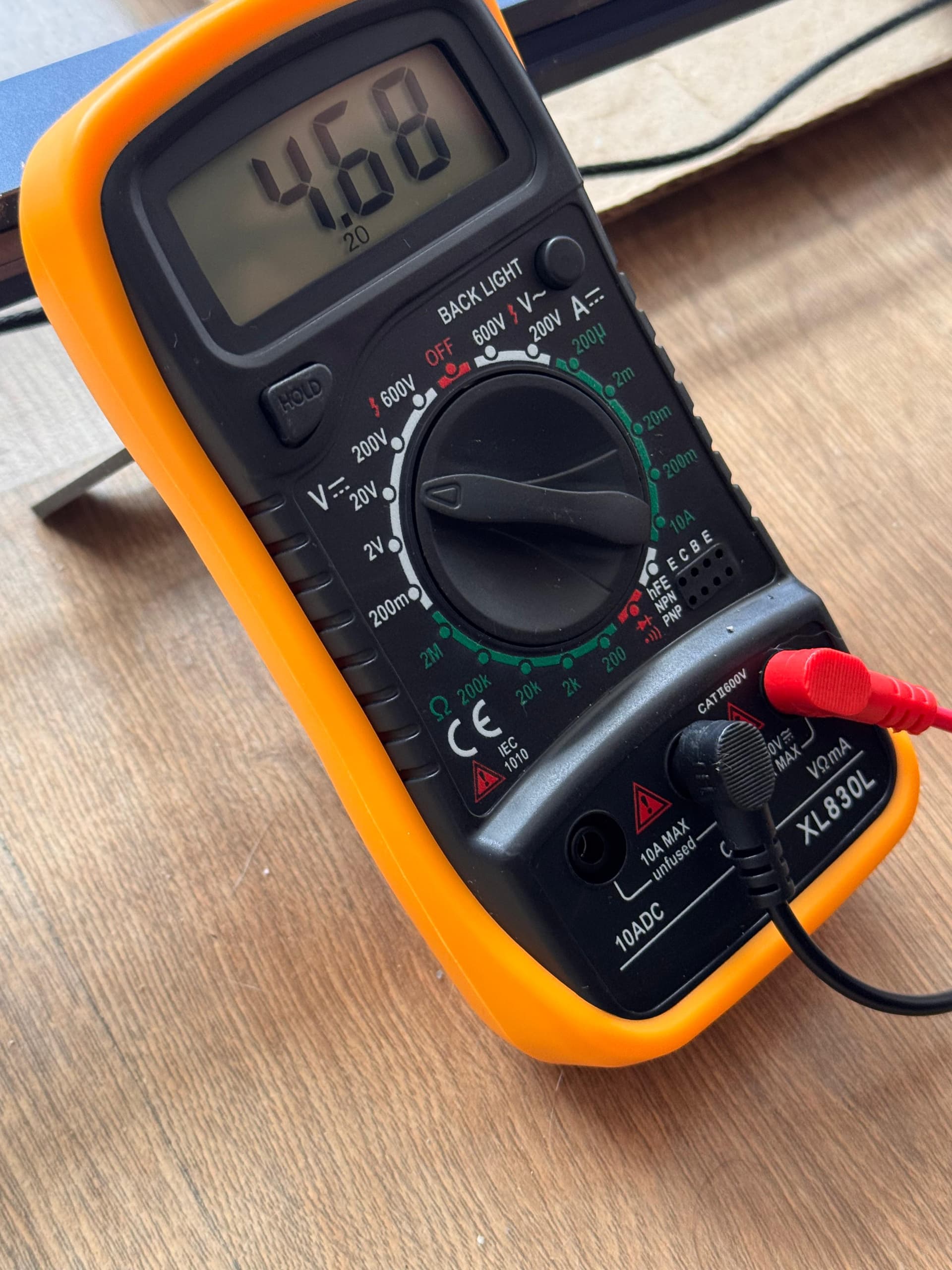

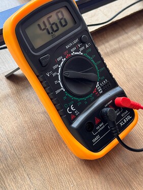

Hi! Coming back after meassuring Y axis screw
Here the results. This is the voltage regardless 0, 45 or 90 degrees in the screw. Can we conclude its broken?
Yes. The voltage should be below 1.5V at any time, I think.
Generally, the factory settings are correct and safe. Choices will be made in the controller board layout and in the wiring to have the stepper motors move in the expected direction by default. Inverting axes shouldn’t be necessary but it can be an issue.
In the video, the X-Axis motor moves the laser module along the X-Axis until it collides with the frame of the engraver on our right hand side. Stepper motors don’t offer feedback to most controllers. If the control board doesn’t recognize that a limit or end-stop switch is triggered the engraver will rattle away until it gives up searching for the switch. If there is a switch at the limit on our right hand side, it either wasn’t activated or a wiring problem prevented the controller from detecting it.
The $23 setting is set up to invert (reverse) any of the homing directions.

It really depends on how it’s being measured.
The adjusting screw is a variable resistor or potentiometer (same thing - different names). This component can be wired up ‘inline’ to limit current flow or wired across power to provide a voltage (signal) that is in between the power voltage and ground. I don’t have a Sculpfun here but the electronics in the engravers usually runs on 5V and ground should be Zero Volts. The Motors are usually run on +12V or +24V.
If that variable resistor is connected between power and ground and if you’re reading the power pin and the ground pin with your volt meter, it will read identically regardless of the setting. Have a look for a ‘middle pin’ and measure from that to the ground and see if the adjustment works.
I was going to type ‘third pin’ but that could be misleading with a three pin component.
Possibly, but unless it’s very obviously broken, It can’t be known without testing under load.
