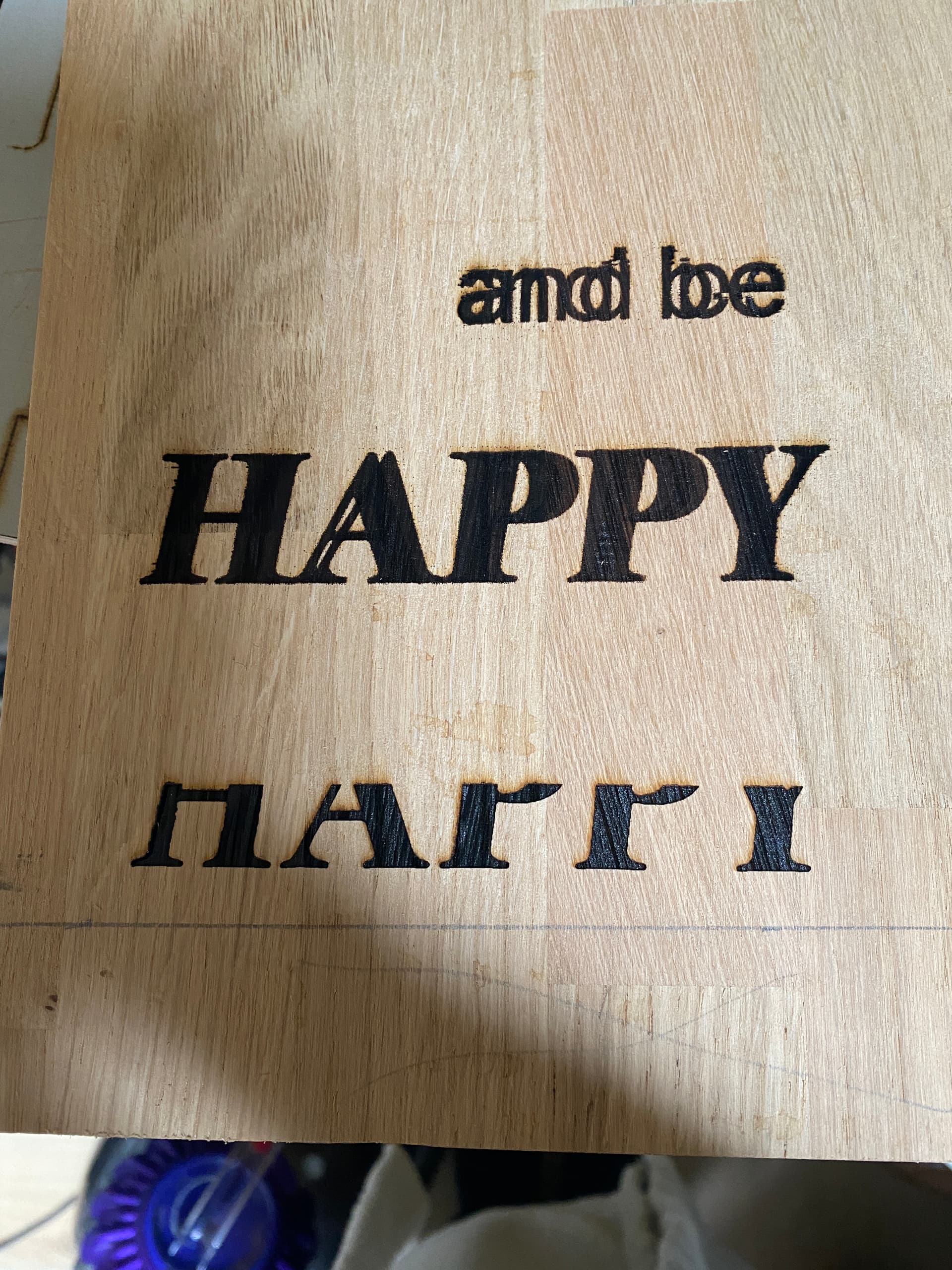

I’m new in laser engraving, using a creality 1,6W laser module on my Ender 5 3D printer.

I want to engrave the text “eat drink and be happy” on a decorative cutting board.
So, firstly I was getting this image, where the left and right direction engraving was shifting, causing a dual image.
Then, I unchecked the dual direction engraving option in the settings, so I could isolate the issue to this one problem. Below is half the HAPPY text, which turned out perfect.
I decided to repeat this 1-directional engrating on a new piece of wood, which should work.
However, I now numerous strange patterns I don’t understand
  • Why is the suddenly H wavy, but all other letters in HAPPY are fine
  • Why the burn offset at the letter d, but fine at the letter b
  • Why are the “H” and the “and” all bad, but the letters APPY and the “e” above absolutely fine.

if your machine was a regular diode laser i would say your X axis is loose on the belts or sproket/wheels etc. something is adding backlash to the system.
However this should be self evident if you operate it as a 3d printer?
Worth reviewing the hardware though
I second Gil, in my experience, such results are 95% caused by mechanical issues. I guess that the laser head might be a bit too heavy in contrast to the extruder? So the speed might have been too high. Which settings did you use?

I converted my printer to 3D printing again so I can confirm if it is a hardware issue. If printing succesfully the belt isn’t the issue.
Then, the laser head weight.
I understand it might be wonky due to the weight, but it doesn’t explain why the “e” in “be” is sharp, right?
I will try a lower speed next, perhaps speed 100mm/s with 75% power will do.
Settings I used:
pass count: 1
speed: 400mm/s
power max: 55%
Engraving pattern:
Bottom right to bottom left = laser ON
Right to left = laser OFF
