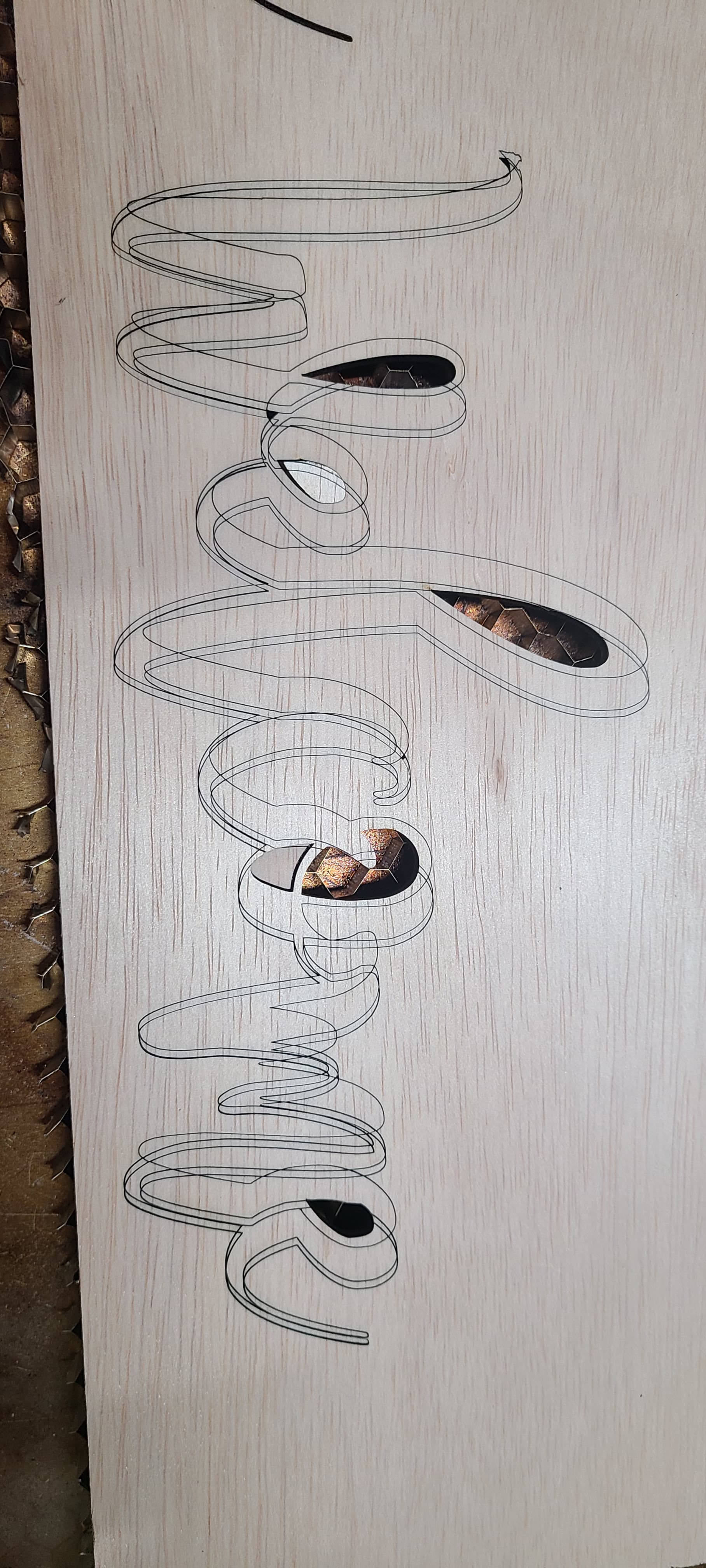

I have Sculpfun S30. It has started doing this to my cuts. What is wrong??
Belts and or bolts are loose, this is made worse by high speed movement.

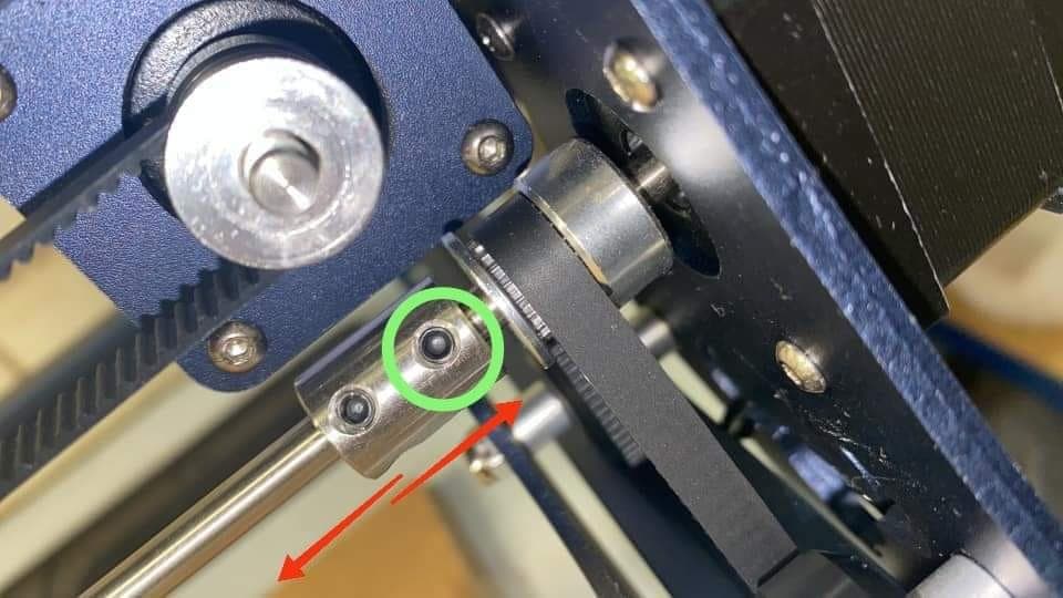

Check the screws, belts and wheels. Here is a guide: Guide to mechanical adjustments and maintenance
Especially check grub screws like this:
