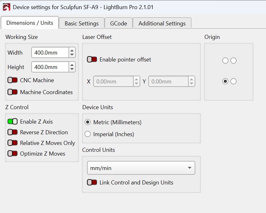

Never had this one before. I have checked whatever I can think of, did a quick search here and reset computer. Whenever I select mm for measurement, it defaults back to in constantly. it will not let me select it. It’s doing it on all my devices (co2 and fiber)

I was able to solve this same issue on my laptop by going to Device Settings; Control Units and set the Link control and design units radio toggle to ON then change the units to in / mm/sec.
If you unlink, then you can design in inches and run in mm separately, or any combination.

It is a new added feature where design and control settings can be linked. If you change in one place, it will also change in the other. I am guessing 1/2 the users want it this way, and the other 1/2 (me included) prefer unlinked. I design in both inches and mm’s, but always use mm’s for my laser settings.
Look right under Control Units.
P.S. This is the same window as in the @Grandpa_Laser Posting #2 above.

The changes were needed to allow flexibility in units across these three concerns:
Design Units: What is used in the design space on-screen
Control Units: What your cut settings and jogging uses (can be linked to follow Design)
Device Units: What LightBurn sends to the device
There is an explanation of the changes here: PSA: Unit Settings Changes in LightBurn 2.1 – LightBurn Software
