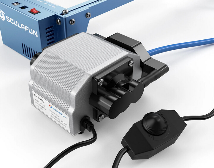

Are you using the Sculpfun pump for the S9 in your profile?
This pump gets power from the laser over the same power supply. They mention that : " When using the air pump, you must use a 12v 4 Ampere power adapter."
Aaron thanks for reply…Can you tell me how the power comes from the Laser when without using a relay, to switch pump on/off…
When using the pump without relay it’s not connected to the laser and all is fine (I just have to manually change the air low…
But when I hook up the relay it freezes to laser when LB switches to engraving from cutting… but if I use an extension cord for the pump that’s not on the workshop system all is great and works as it should…
Cheers Merlin…

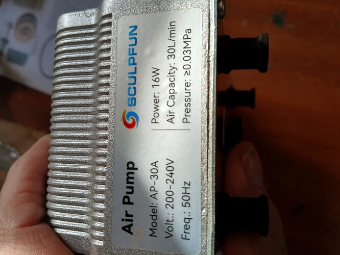

I see, there are two Sculpfun pumps. - A smaller, black one that takes 12V DC power directly from the laser. With this one, it’s important to use the stronger 4 Amps supply.
And a larger one (probably what you have?) using AC mains power from a wall outlet:
This one is controlled manually uses a relay inside the pump, triggered by the laser’s output. Relays are supposed to galvanically isolate the two circuits to avoid ground loops and yours might have a problem there.

Yes I have the older pump that uses mains power, and if there is a relay in that why do I need another relay to run Air Assist via LB like this
Which is what I have done and what the problem is with it power spiking…
It turns out, I lied when I said the larger pump was using a relay inside! It’s controlled only via the knob of the mains power cable and therefore not controllable via software. - Unless you add the relay yourself as you did.

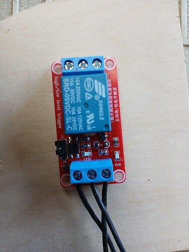

If you used the relay in your picture, you should hear it click on. It even has an led indicating the state of the signal.
Which exact relay did you use? Pictures of your wiring could help us understand.

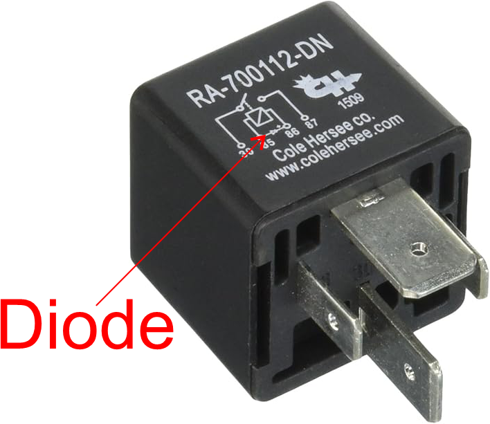

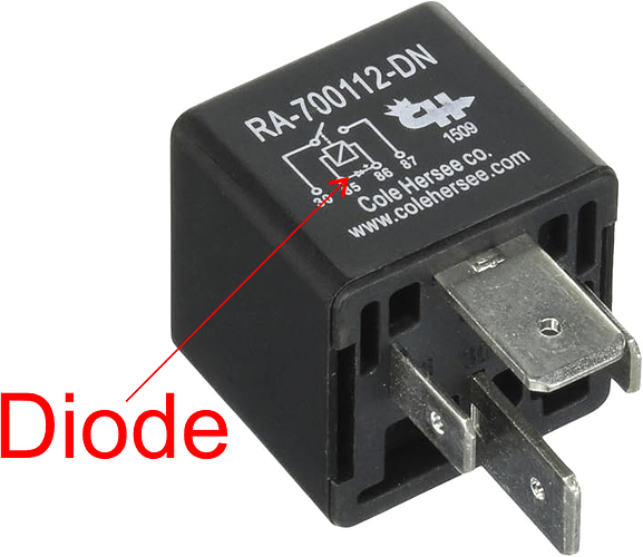

Another thing to consider is the relay itself. I only use relays that have a “flyback diode” attached. This keeps down electrical noise when the relay turns off and on. A long time ago we referred to it as Reverse EMF but it is sometimes called “flyback” or “back” voltage.
There is often a schematic on the case of the relay that shows the diode.
Here’s is a sample of a relay with a diode. I’ve also attached a link that describes the reasoning behind using a "flyback diode.

@Geriatric Good point about the Back-EMF. This can and will definitely cause issues when you control the relays directly from a digital pin of a microcontroller like we have on laser controller boards.
The relays in the picture before has precautions for this problem in form of this rectangular part, the optocoupler to galvanically isolate the two circuits, and the transistor that switches the relays on from the separate DC in. (Most Digital pins won’t be able to directly power the coil of a relay)

We still don’t know which relays you used exactly. If you could send us pictures of the wiring and pump you are using, we may find a clue.

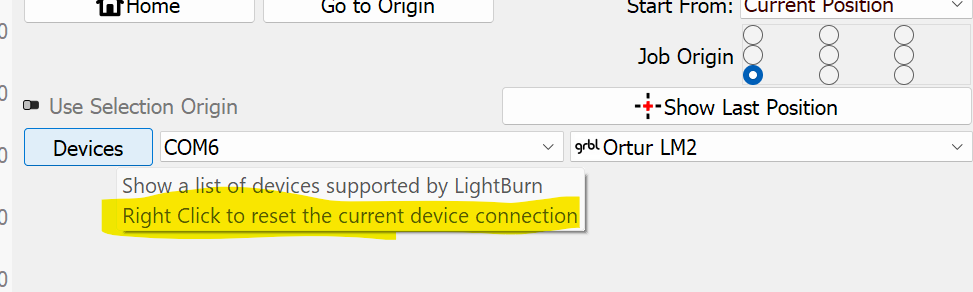

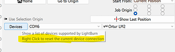

You can also right-click the “Devices” button in the Laser window to reset the current device connection
Do you see more than one COM port in the drop-down and does one of them disappear when you unplug the laser? - That would be the one to chose. You should also hear the Windows “bleep-bloop” sound when you plug in the USB cable.

The laser unlocked and can be moved manualy.
Can not be moved from the Move window, pressing the Home button in Move window Locked up the Head again.
Unfroze/Locked by changing to Com 3 and back to Com 11.
When I Right click on Devices I hear a small click on the laser Head.
