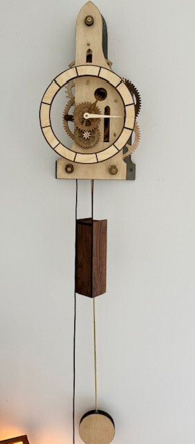

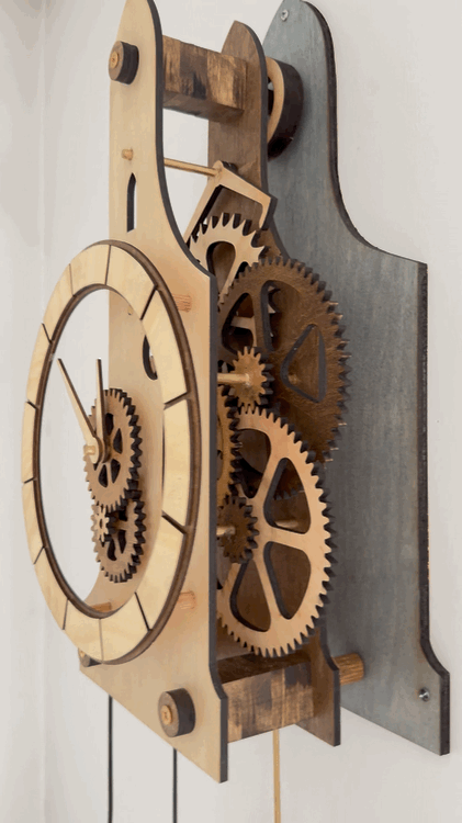

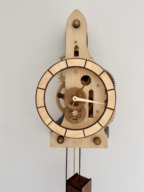

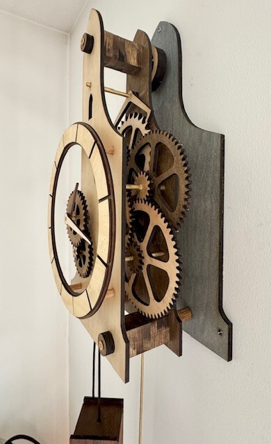

Our latest project, a wooden pendulum clock. Very fun project
and keeps reasonably good time for a dozen wooden gears !

Any ideas why the clock doesn’t keep perfect time.
Nice work by the way.
Thanks Pete !
I’m still dialing it in, it’s primarily the pendulum length which is adjustable via a threaded rod inside of the brass pendulum shaft. Getting the counter weight just right so it exerts enough downward force to keep the clock running without over stressing the mechanism, and I just redid the capstan to eliminate a little slippage in the counter weight cord.
There are quite a few variables that factor in to the overall accuracy. Over a 6 hour period it’s only off about two or three minutes, for twelve wooden gears meshing together with a 5.6 lb counter weight I’m pretty happy with the results. I can hear a very slight difference in the pitch of the ticks as the timing gear rotates which makes me think I may have a slight alignment/gear meshing or binding issue to track down as well. I periodically make small adjustments on the pendulum length but I don’t think I can hope for much better especially when temperature and humidity start to fluctuate.

Laser cutting wooden gears is really difficult. Actually it’s very easy to cut a gear using a laser. It’s just about impossible to get one to function properly in a clock. I gave up trying to get a mainspring type wood gear clock to work using a laser.
So great job if the clock simply keeps ticking for a decent amount of time.

That time keeping is a good result considering the materials and changes in temperature and humidity etc with so many factors in play. I hope you can keep us updated with any further insights. I grew up listening to at least two or three mechanisms working in any given room in the house due to my father’s love of mending time pieces and I learned early to listen between the ticks!

I’m thinking about making a few changes mainly to the counterweight system. I think this is an area that could be strengthened as the counterweight bears on the palls that lock the load to the main gear. I cringe a little when winding even with the load off as the thin wood that locks the capstan to the gear in forward motion could be a point of failure. I’m also going to try to add a suspended pulley system to extend run life. Currently it runs for about 10 hours then needs to be rewound, I’m going to try to reduce the counter weight size with lead shot filling the canister instead of the steel bb’s in there now. The counter weight is 9.5 inches and it drops at 5” per hour, (the clock overall is 20” top to bottom) so if I add the pulleys and can reduce the size of the counter weight I’m hoping to get a 24 hour runtime. If your interested I’ll post a revision when I get that all done. And yes Peter, I really love the sound in the house, definitely a distinct tick and a solid wood tone tock !

I think what Jose was referring to was the counterweight. As Mike pointed out the period or swing time of the pendulum is what regulates the clock. Lengthening the pendulum slows the clock while shortening it speeds it up. If you disconnect the pendulum the force of the counterweight will run the clock, you put just enough counterweight on to keep the clock running smoothly without the pendulum, then reconnect the pendulum and dial in the length to keep correct time. The pendulum regulates the fall of the counterweight via the anchor that moves up and down, seen at the very top of the clock in the gif. If there is too much counterweight it binds the clock and it won’t run, it’s a delicate balance.
The pendulum has to have a certain amount of mass to keep momentum, but I don’t add weight to it. Mine is a 6” x 1” hardwood disc, inside the brass rod is a threaded rod that extends into the disc and can be screwed in or out to adjust the overall length to slow or speed up the clock.
