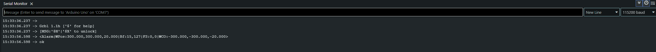

Another decent way to know what’s going on with the position reporting, would be to install the Arduino IDE, open it up, select the right serial port (with MM and LB closed) and then launch the serial monitor:
And then select the right baud rate (generally 115200), and send in the ?:
If you can share a screenshot of that response, we’ll be able to tell if we’re doing something wrong, or if GrblHAL is misbehaving on the Flexihal board.

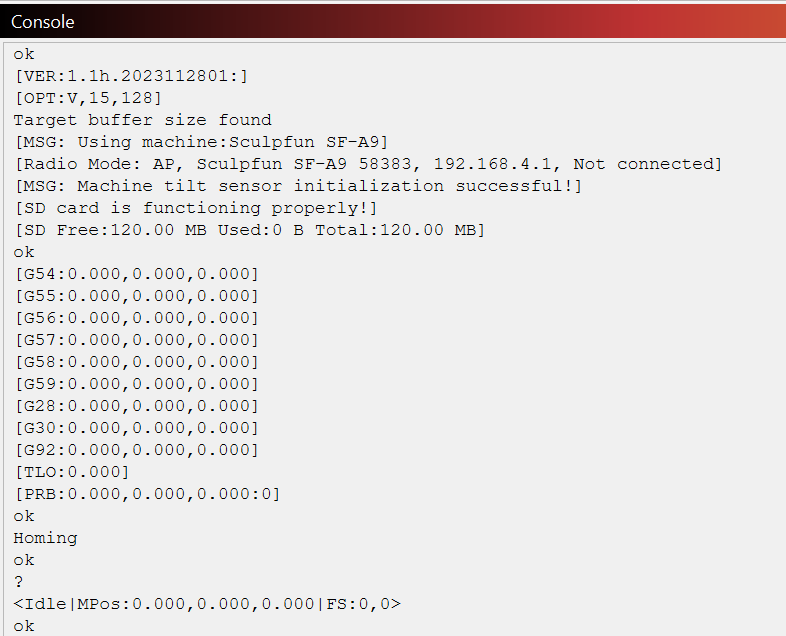

HI There.. I have tried again in Millmage with a capture attached.
I changed the $10=0 to try then did what you asked open console and clicked GET ALL and i got back 2 lines continually ( OK ?). I did just type ? and the same thing happened.
I downloaded the Adruino but cant get it to work. I wants a board and any i tried dont work.
I am a real newbe with this stuff so not sure how to get it going.
This is what mine looks like for comparison. As you can see, There is a lot of information your controller does not supply. And a lot mine does not supply. :nerd_face:
EDIT: Based on what I see, your controller does not respond to all standard GRBL commands. If Lightburn cannot poll the controller position registers, then this begs the question: What about that other software that is showing position information?
Educated Guess: Those others are not polling the controller using standard GRBL commands (which do not work on your controller), they are displaying where the software thinks the laser should be, not where the controller says it really is.
