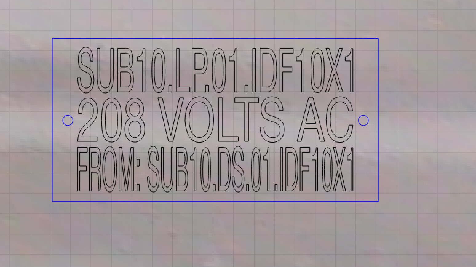

I am working with some placards that have three lines of text. I want to constrain the width to 3.325" and have that setup in the shape properties. Is there a way to have is squeeze all three lines on the placard the same amount? Right now I get this:
In a perfect world all three lines would be compressed the same amount.

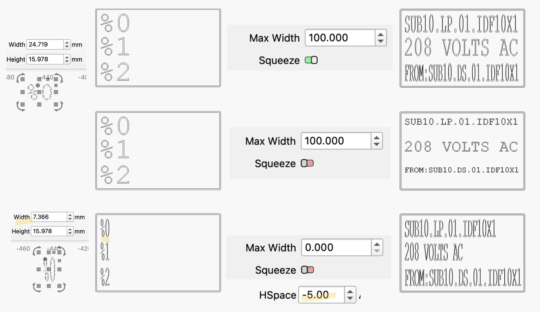

That’s an interesting question, and I think to get the result you’re after, you’d need to;
Disable both ‘Max Width’ and ‘Squeeze’.
Limit records in your merge file to a maximum length/number of characters.
Use a monospaced font so text length will be predictable (like Courier New, but there will no doubt be better fonts for legibility).
Setup the text layout to fit the maximum length (adjust text object width and character spacing as needed - see highlighted).
Examples of how ‘Max Width’ and ‘Squeeze’ affect the final result;
