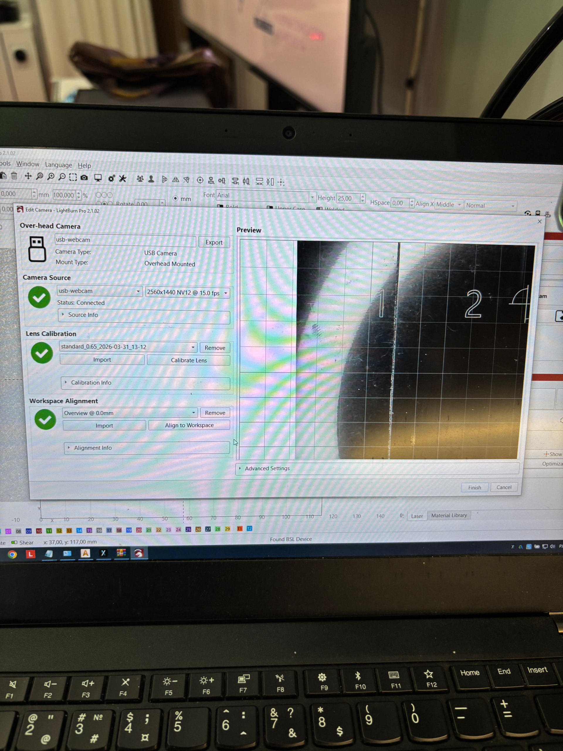

Workspace aligment problem in 2.1

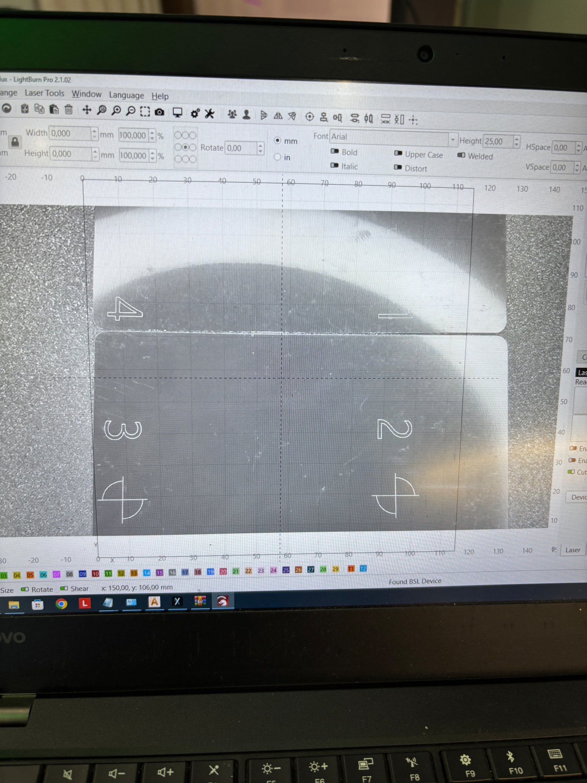

I have a problem with camera calibration. In a preview i have true workspace. But then i try update overlay camera it seems like unadjusted workspace

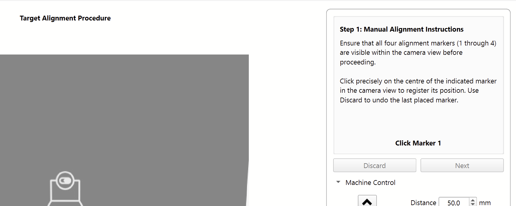

Did you select the four target markers in the correct order 1-4 in this step?
You can quickly run through this without engraving new targets, but you’ll need to re-run the entire process if you’ve moved the markers at all.

Yes, 4 target marking
Sorry to be suspicious. Can you send us a screenshot from the steps shown in my previous image, where we can see the four target markers?
